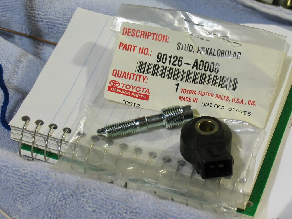

    OEM Knock sensors aren't particularly cheap and if there's more to be had with an alternative sensor I'm not opposed to it by any means.
    I'd love to hear more about the available options especially before I've committed to buying one or the other
    Yota1 wants about $500 for the oem spec knock sensors and harness

    I’ll just leave this here, should you decide on the Bosch units.

    I'd recommend putting your IAT in your intake tubing as close to but not after the throttle body as possible. Supercharged guys I recommend it somewhere after the rotors but facing the outside of the engine to avoid heatsoak as much as possible, we tapped my buddys' SCs for a 1/8 NPT IAT sensor that was commonly available.
    As far as the knock sensors go... I personally don't use them to tune but some do and if your local tuner prefers you have them then I wouldn't waste money on new stock ones (as the Haltech cannot parse their signal well) and would instead use bosch style ones with the studs @ChargedSHOTaco recommended.

    Bosch knock sensors are less than half the price, but not buying sensors at all is priceless.

    Would you mind sending me a pic of the pinouts?
    unstpible[QUOTED][OP] likes this.

    Yes, the pinout please, for future reference.

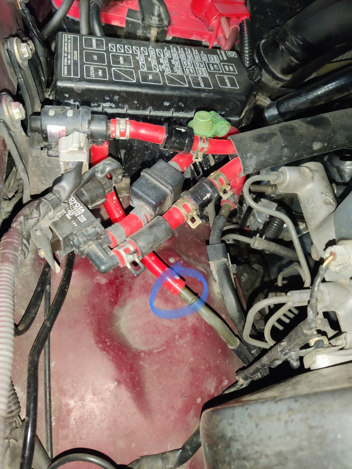

    A little off topic but yesterday before filling up the gas tank I popped off one of the Evac lines under the hood and what do you know the gas tank filled up without me holding the pump handle halfway open the entire time.
    Still a bit of a hassle but it's a hell of a lot faster and easier on my hands

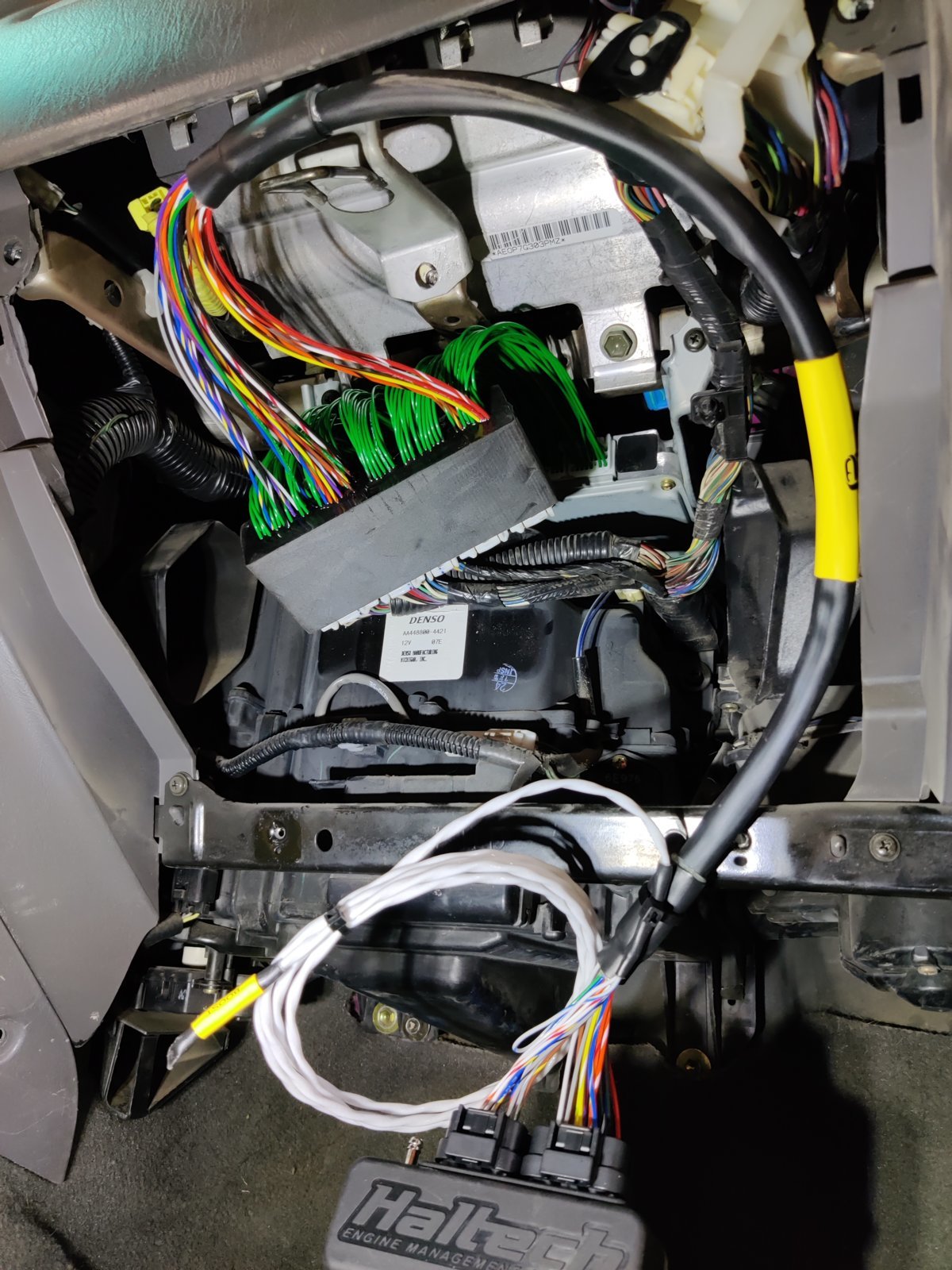

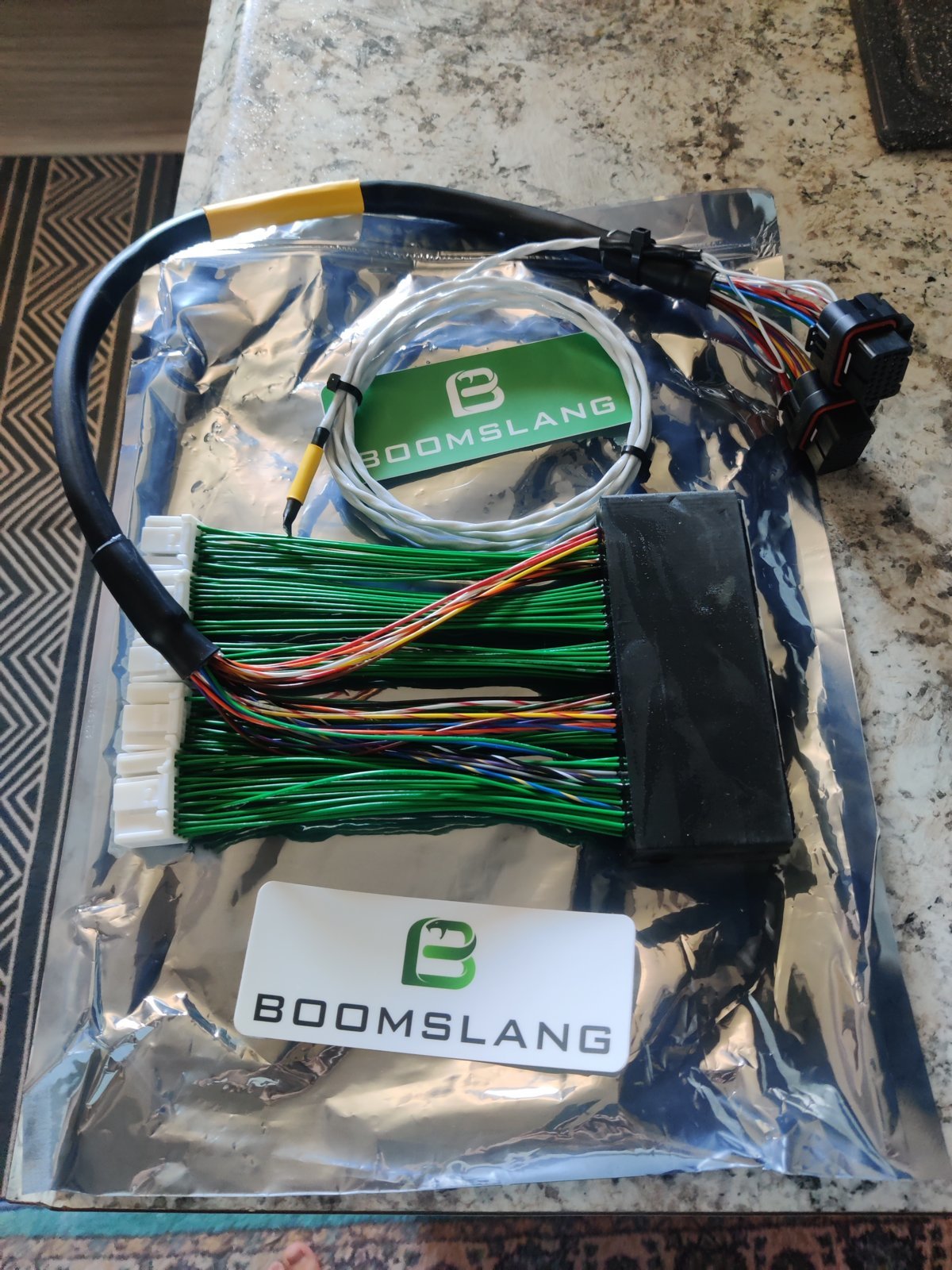

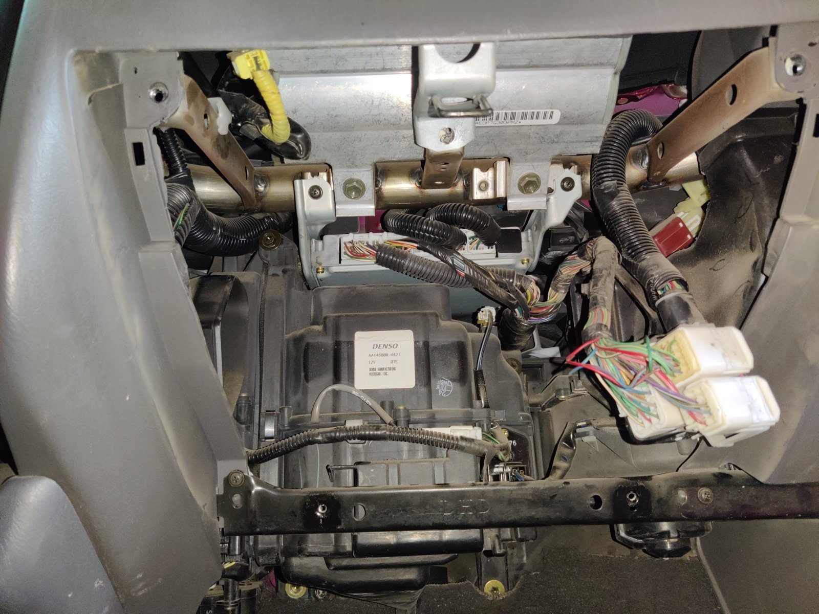

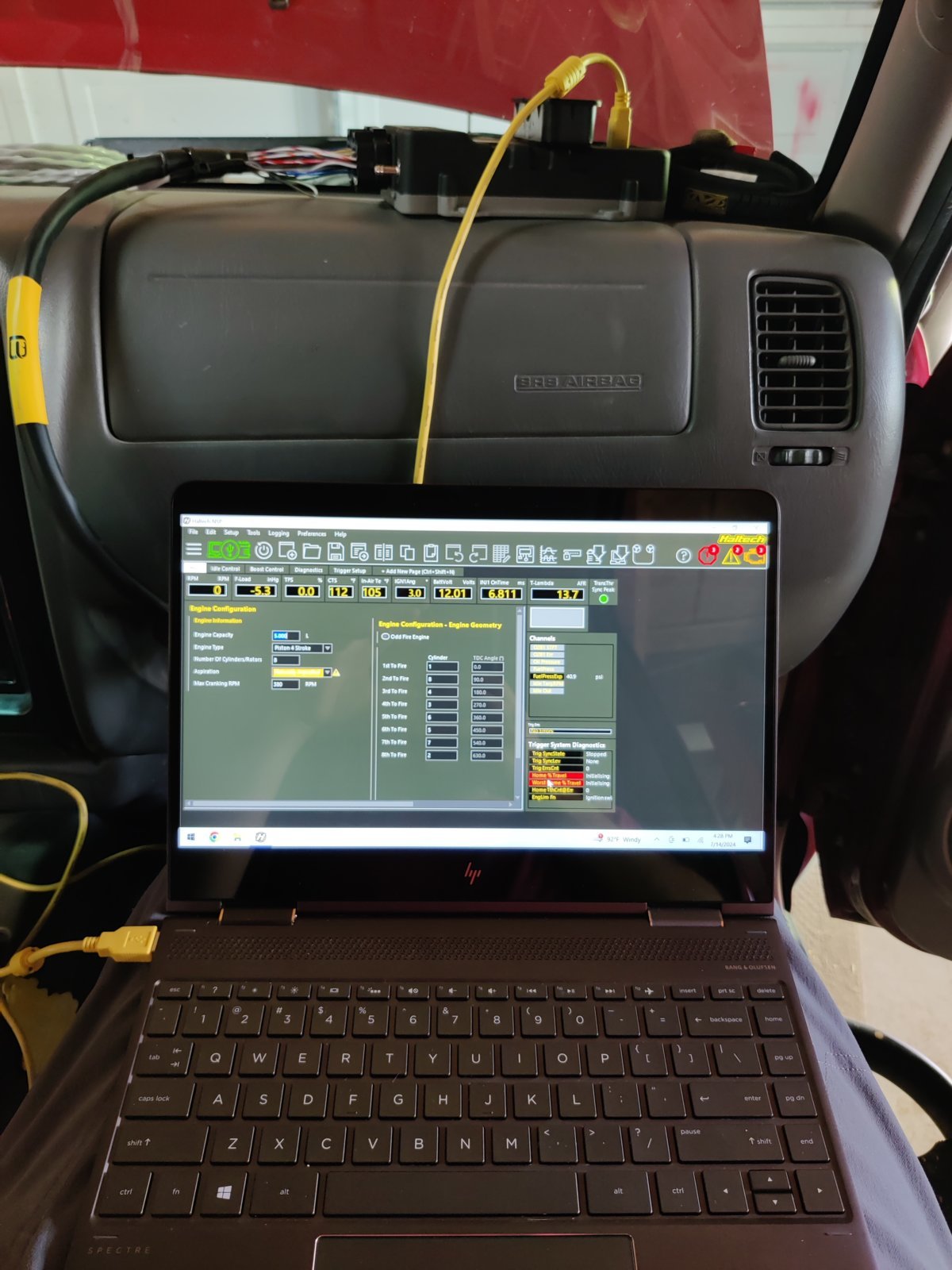

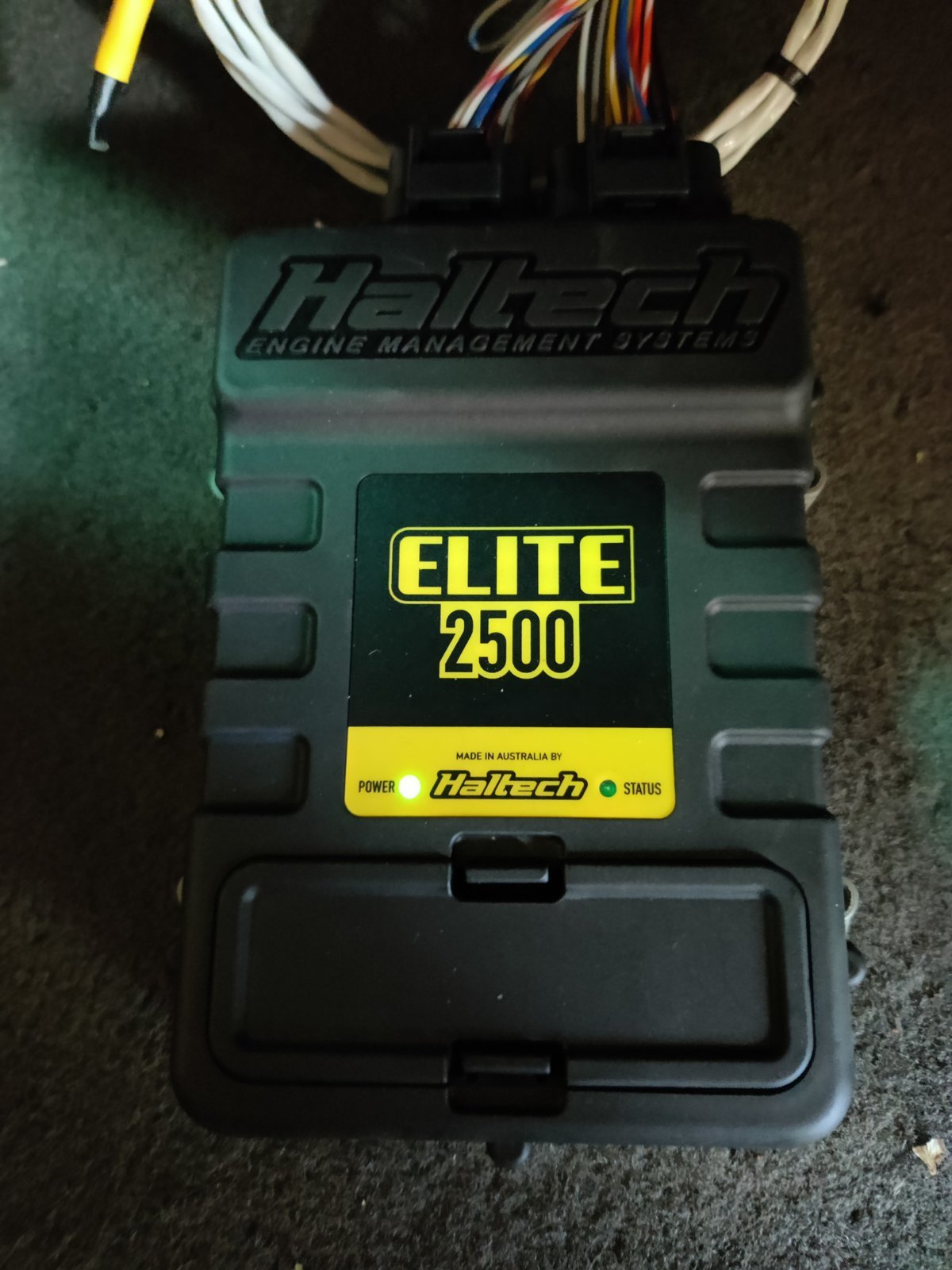

    I'm still waiting for a few things but I just had remove the glove box and some other things to see what's behind it and how much room I would have to work with.
    Once that was opened up I thought, might as well check and see if the ECU plugs were going to come out easy so after disconnecting the battery I removing all 5 plugs without a hitch. We made it this far so I figured it would be worth my time to check and see if the plugs from the Boomslang harness were going to match the ECU and sure enough that was a snap (or rather 12 nice audible clicks as each plug went home).
    Everything was going smoothly and I was thankful for that because it's currently in the mid 90's and humid as a thunderstorm prepares to wash away the heat and hopefully clear out some smoke from the local wild fires but I digress.
    With the Haltech plugged in the next step I took was confirming it had power so the battery was reconnected and key turned On followed by a few healthy electrical humms and relay clicks as things came to life, the green light on the Haltech glowing magnificently.
    Only reasonable thing to do after that was connect the Haltech to the computer and open NSP
    It might not be a honda civic but I've finally got an in vehicle laptop :devil::curls:

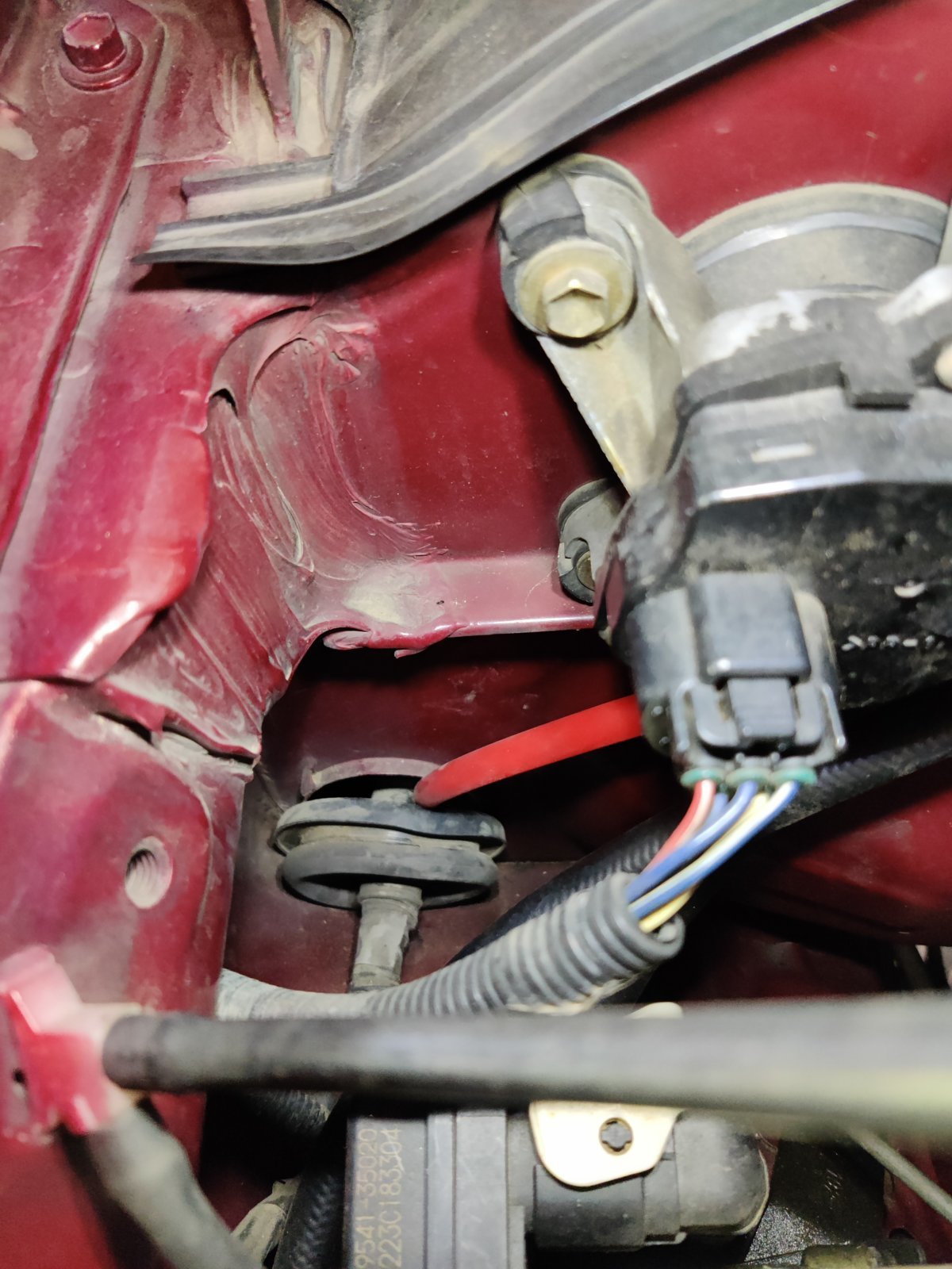

    I removed the Boost pressure reference for the Innovate guage and replaced it with the hose for the Haltech MAP sensor. Luckily I had a long enough piece to make it through the firewall on the passenger side.
    Shouldn't have any issues getting it through the rubber boot when I know that's where it'll stay.
    Still waiting on the Haltech WB1 so I left the Wideband connected to the Innovate guage a little longer.

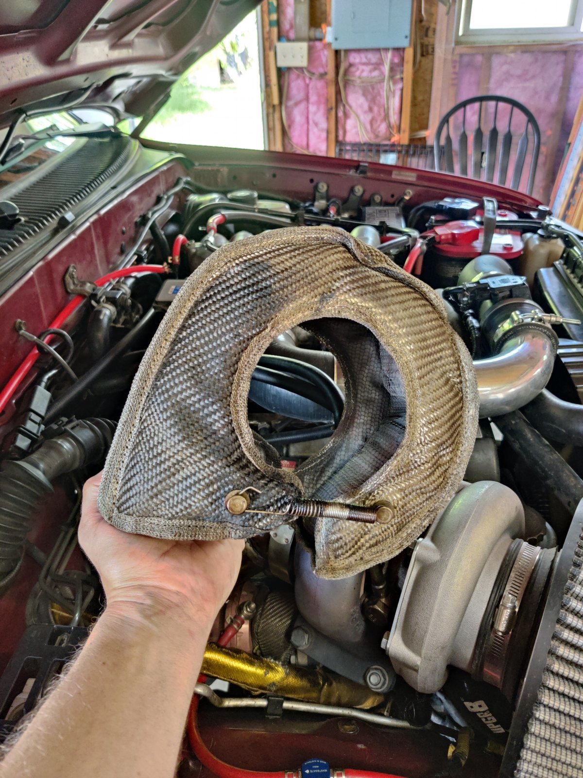

    I started it up today and ran my hands around the turbo and down pipe, I can feel little rapid puffs of air but the turbo blanket and position is making it hard to see what specifically is leaking without feeling the sting of hot metal. Best case scenario the down pipe vband needs recentered on the turbo. Could also be the T4 flange or maybe even the waste gate. I'll let it cool, get the blankey off and try again.

    Keep in mind that taking the blanket off most likely means buying a new one. They tend to fall apart when disturbed.
  19. Jul 18, 2024 at 3:27 PM
    #739
    unstpible
    unstpible [OP] Well-Known Member
    Aug 16, 2012
    #84909
    3,787
    Derek
    Cedar City, Utah
    03 4x4 boosted V6 Auto 341k miles
    CX Racing Turbo kit. TransGo shift kit. All Pro Apex bumper and skids. Smittybilt XRC 9.5 winch. All Pro Upper control arm's. Bilstein 6112's with 600lb coils. Eimkeith's lower control arm reinforcement plates. Perry Parts bump stops. All Pro spindle gussets and alignment cam tabs. All Pro standard 3" leaf springs. Bilstein 5125's rear. Extended rear brake lines. Rear diff breather relocation. MagnaFlow catback with resonator. Bluetooth stereo. Memphis 6x9 door speakers. Diode Dynamics SS3 Pro Amber fog lights. Single piece headlights. aftermarket grille. Anzo taillights. LED 3rd brake light. 4runner sunglass holder and dome lights. Master Tailgaters rear view mirror with 3 directional cameras, G shock sensors, and anti theft system. Honda windshield washer nozzles. Stubby antenna. Scan Guage II. 2nd Gen Snowflake wheels powder coated black. Cooper Discoverer ST Maxx 235-75/16 Denso 210-0461 105 amp alternator. Speedytech7's big wire harness upgrade. Aeromotive 340 fuel pump. Haltech Elite 2500. Tacomaworld sticker. Tundra brakes with Adventure Taco's hardline kit

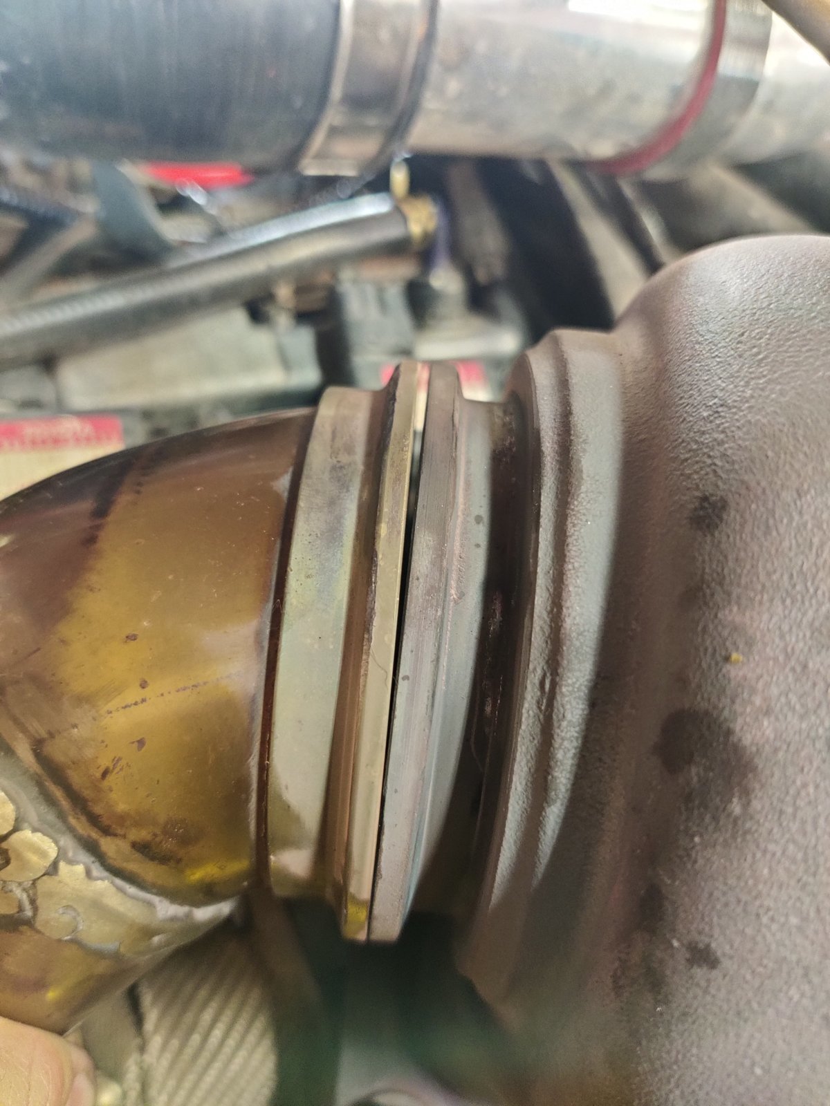

    it held together decently, it's pretty big so it slips on and on/off fairly easy . I wonder how well their Silicone blankets hold up. their temperature rating is quite a bit lower
    Pretty sure the oil return leaks where it connects to the turbo and has left behind some staining.
    The T4 flange bolts had worked themselves a little loose so I'm glad I looked.
    The turbo/downpipe V band also came loose and it shifted position a little creating a pretty good sized gap, it doesn't like to lineup (especially with the cat back still connected)
    I'm not a fan of these (not so) flat flanges.
