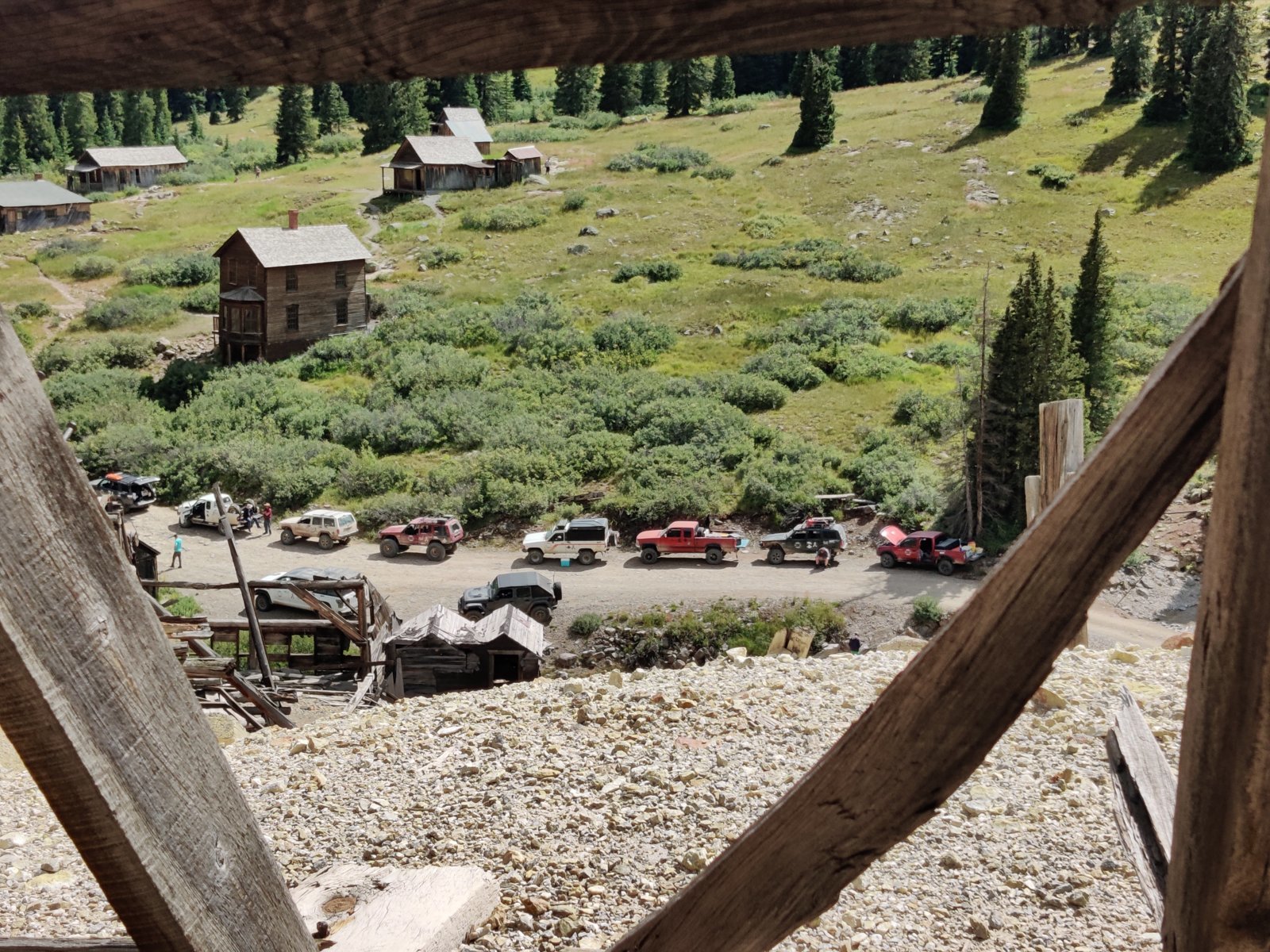

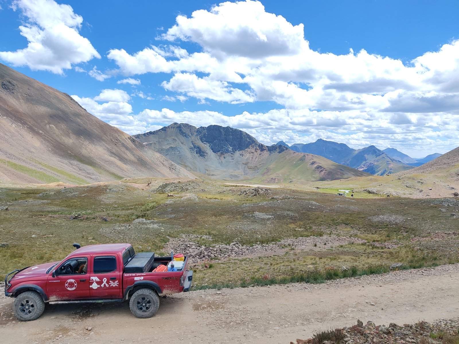

    This summit was a little higher than Ophir pass at above 13,000ft and to say it was breathtaking would be an understatement.
    The water looked so inviting though it had to be cold being so high up. Given the chance I would have loved to go for a quick refreshing dip.
    Not a bad spot to stop for lunch (admittedly I would have preferred the pond)

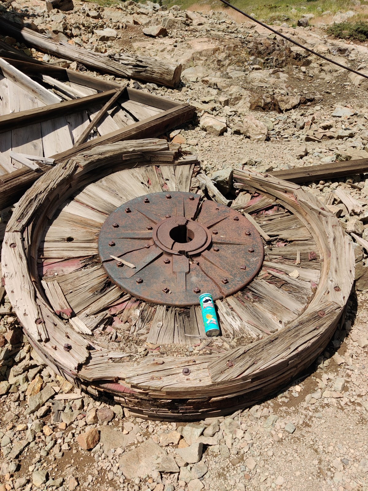

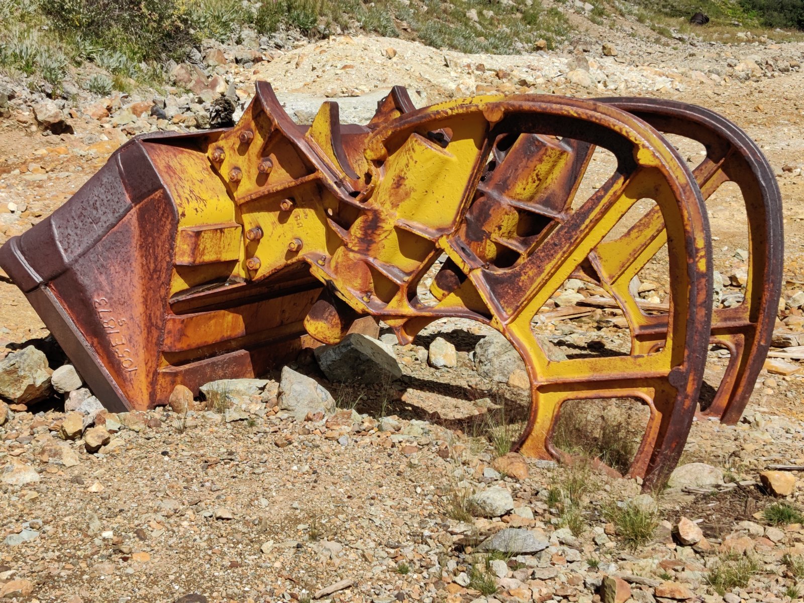

    I couldn't help but be drawn towards this old bucket

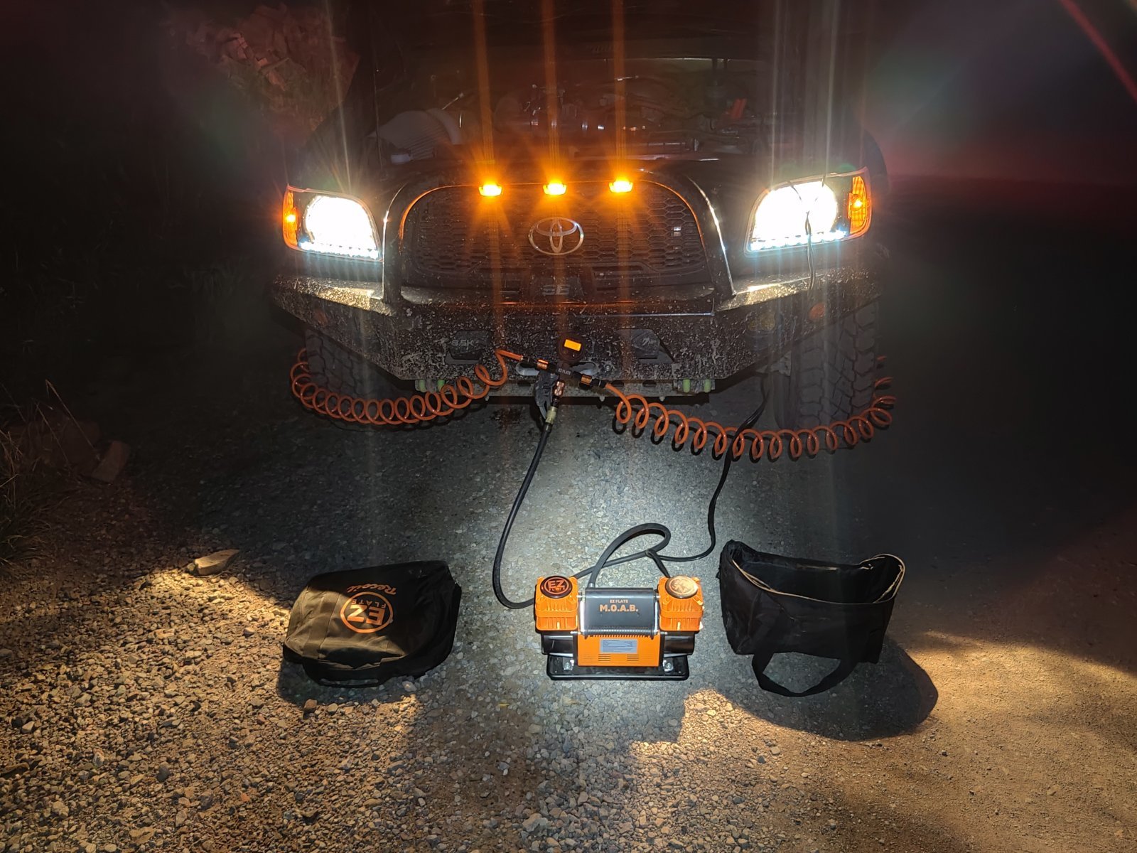

    Then it was time for me to test the second hand compressor
    I have a feeling I'll be getting plenty of use out of it in the future.
    More often than not I don't air down and when I do it's not very much because of the hassle of airing back up but this is a game changer. Once the air had been replaced we hit the pavement and didn't stop until we reached the comfort of a real bed back in Blanding.

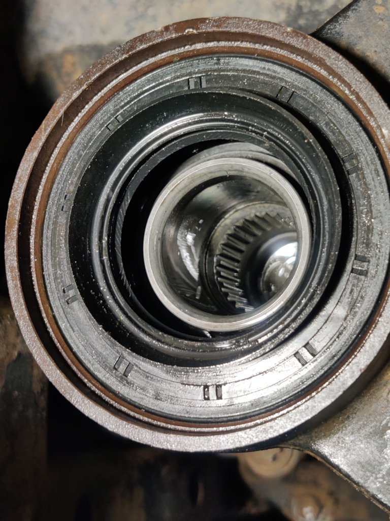

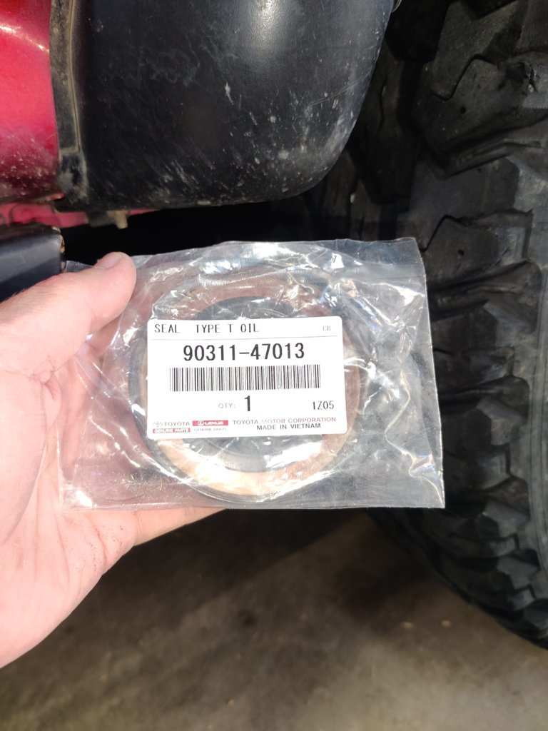

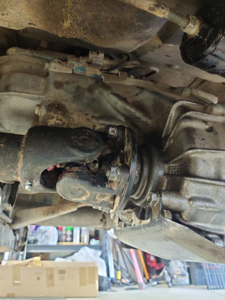

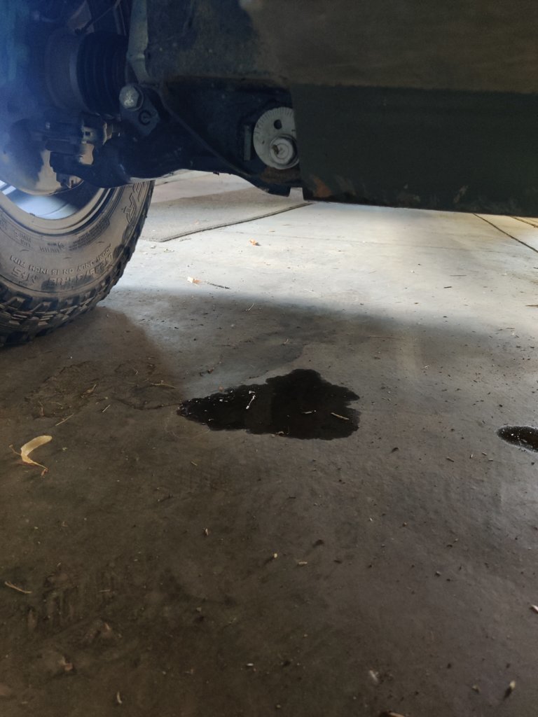

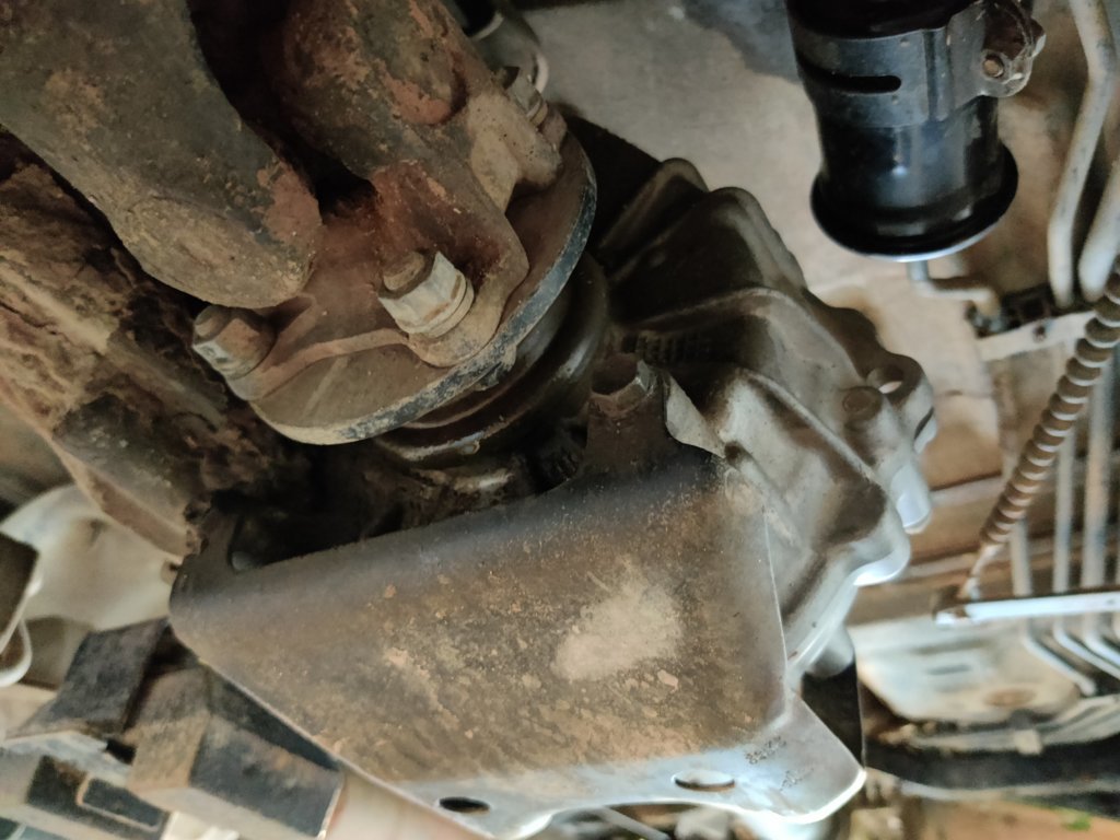

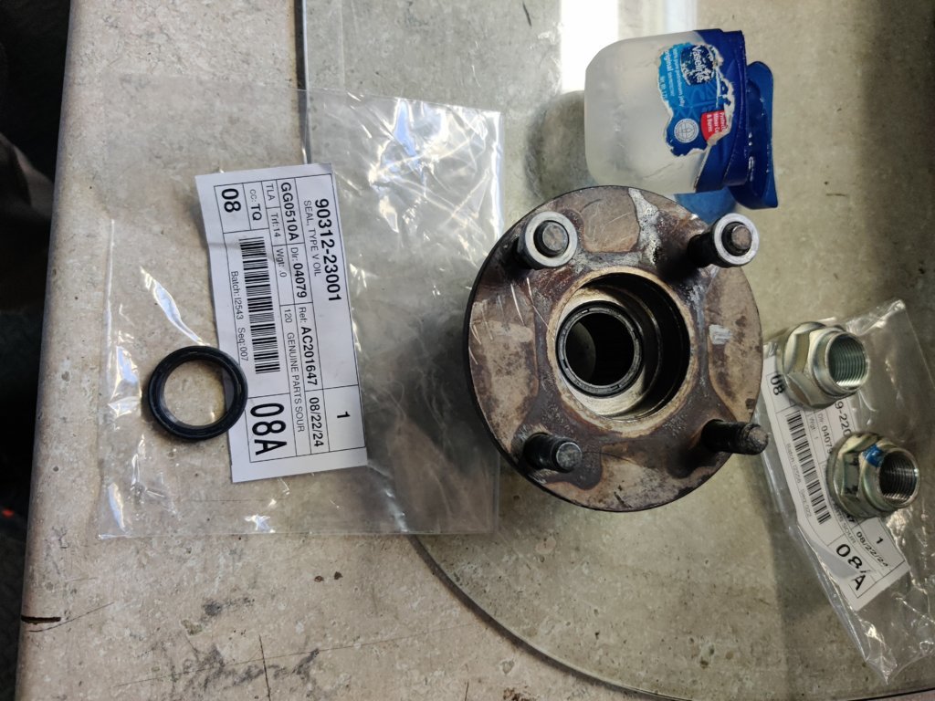

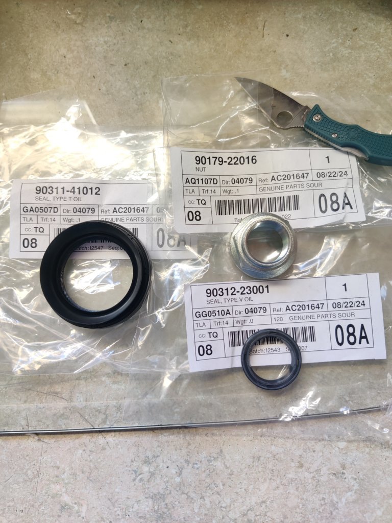

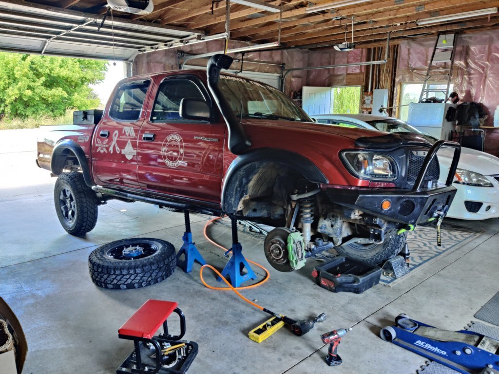

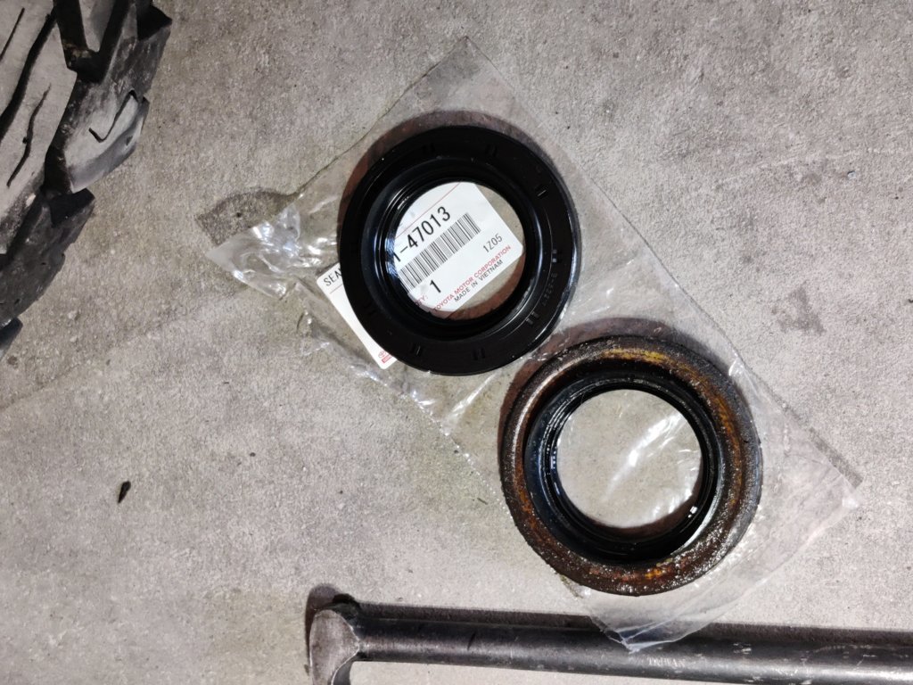

    Now that we're home again I have a few things to repair. First of which is the passenger side dif seal for the CV axle.
    I hate the smell of gear oil.

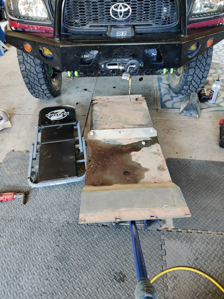

    The dif was first mainly because I had a seal on hand from when my drivers side started leaking a while back.
    I may have pushed the seal in a little too far, it was leaking pretty good still just after parking it but after a quick drive around the block the leak has mostly resolved itself so I'll keep an eye on it and see what happens. I did order another replacement seal along with the seals and stake nut for the front drive shaft on the transfer case. If you look you can see a droplet of smelly gear oil here
    Don't worry about the mug and gunk, I got the skids back off so I can clean it up properly under there.
    I hate cleaning baked on mud but occasionally a little peer pressure turns me into a puddle slut and on this trip we had lots of rain so mud was happening regardless

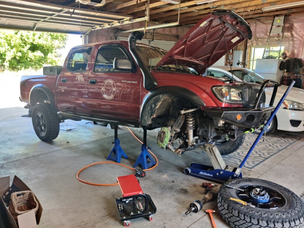

    I pulled the passenger side CV back out to do the dif oil seal again
    I didn't push the seal in too far this time
    I used the old seal as a sacrificial surface to tap the new seal into place and that seemed to do the trick. As soon the the old seal started to catch on the inner lip of the hub I stopped tapping

    Transfer case is sealed back up and topped off
    The small companion flange seal was super easy. Pressed it right in with my thumbs

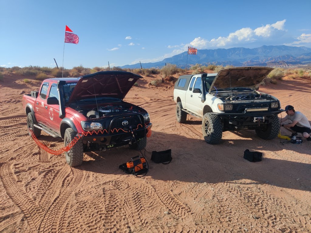

    We met up with @time623 in Hurricane, made a quick obligatory adventures first stop at Maverick for some electrolytes and fuel then headed for Sand Hollow.
    We had a general idea as to the trails we would be taking but there's so many different overlapping trails it's hard to pick one and stick with it. We mainly stuck to the East rim out to the Flintstone House where we took a quick detour after a few pictures
    The house seemed a little draft to us

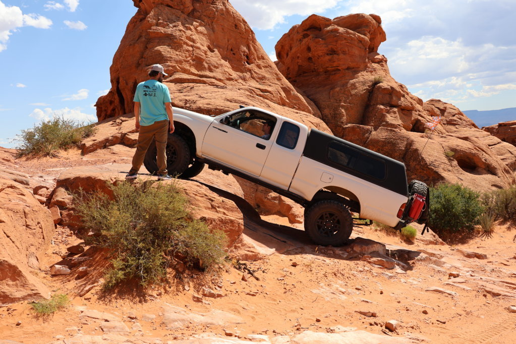

    While we got back in the truck and prepared to leave a little rock wall caught my eye and the intrusive thought said surely I could climb that and we did but it took about 10 minutes longer than I was expecting due to the truck stalling out at the top.
    At least @time623 got a couple shots while I was trying to get things going again.
    At least it died with the front wheels in a crack so I wasn't going to be rolling anywhere (much more so on the drivers side) .
