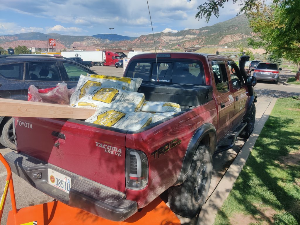

    Turned the truck into a shit box today.
    13 bags of shit to be exact (plus 6 bags of top soil and 4 bags of mulch). Was a nice smooth ride home with the extra weight on the suspension.

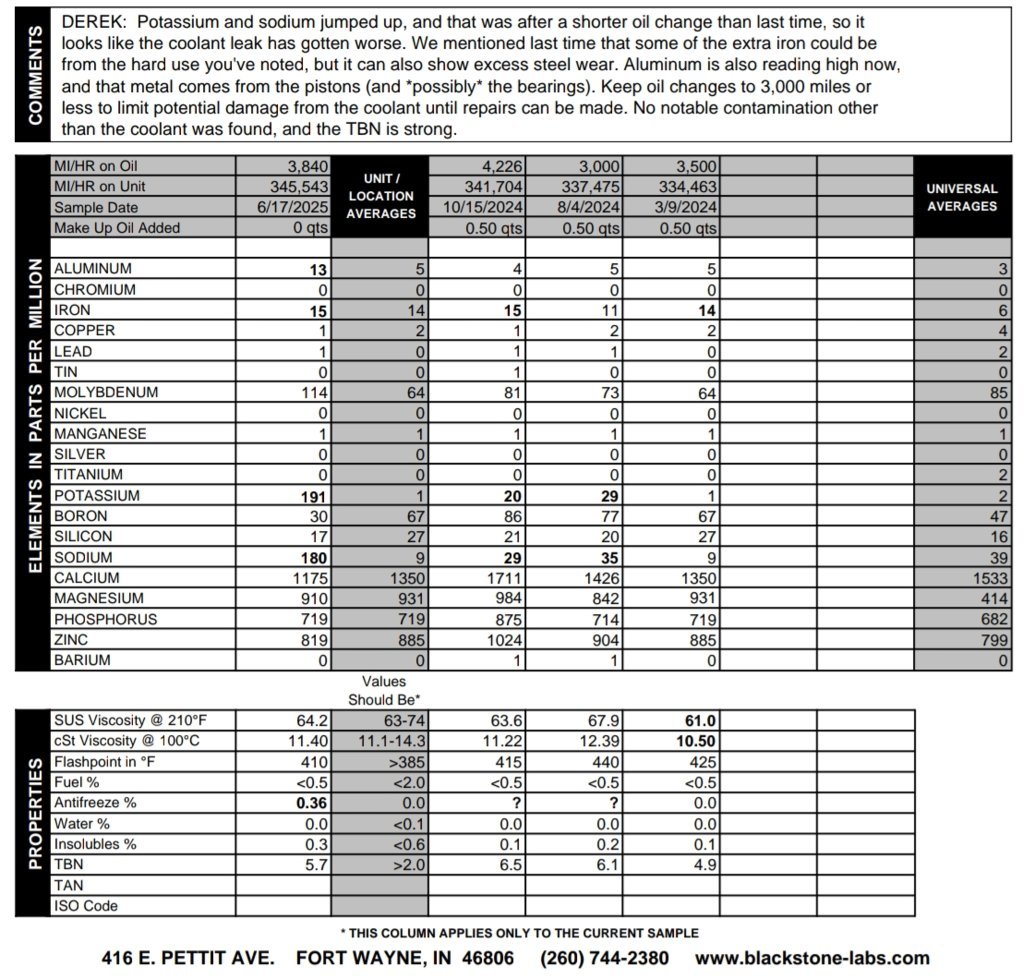

    And somewhat related news I got my 4th oil analysis back a few days ago. It's not great
    :evil::bananadead:
    Could be the cheap turbo, could be heads.

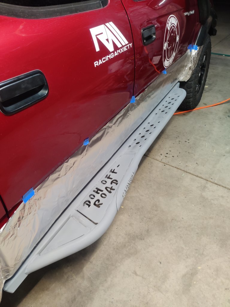

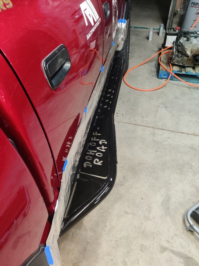

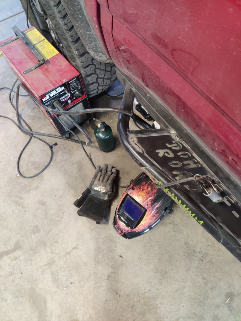

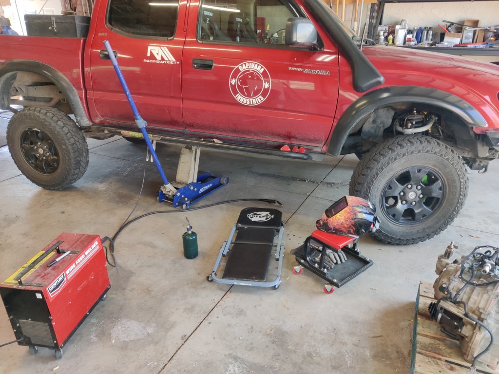

    I have been slacking in here recently.
    Little update on the rock sliders after picking up some filler plates from @Kwikvette while traveling through California last month.
    Caution wet paint

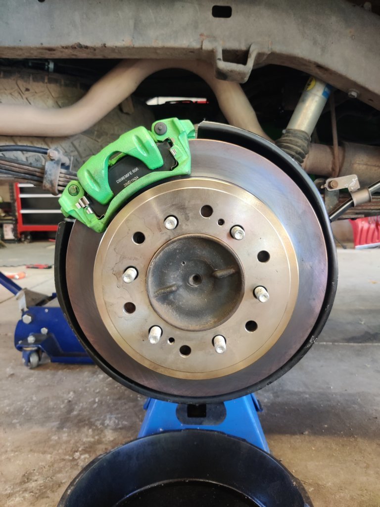

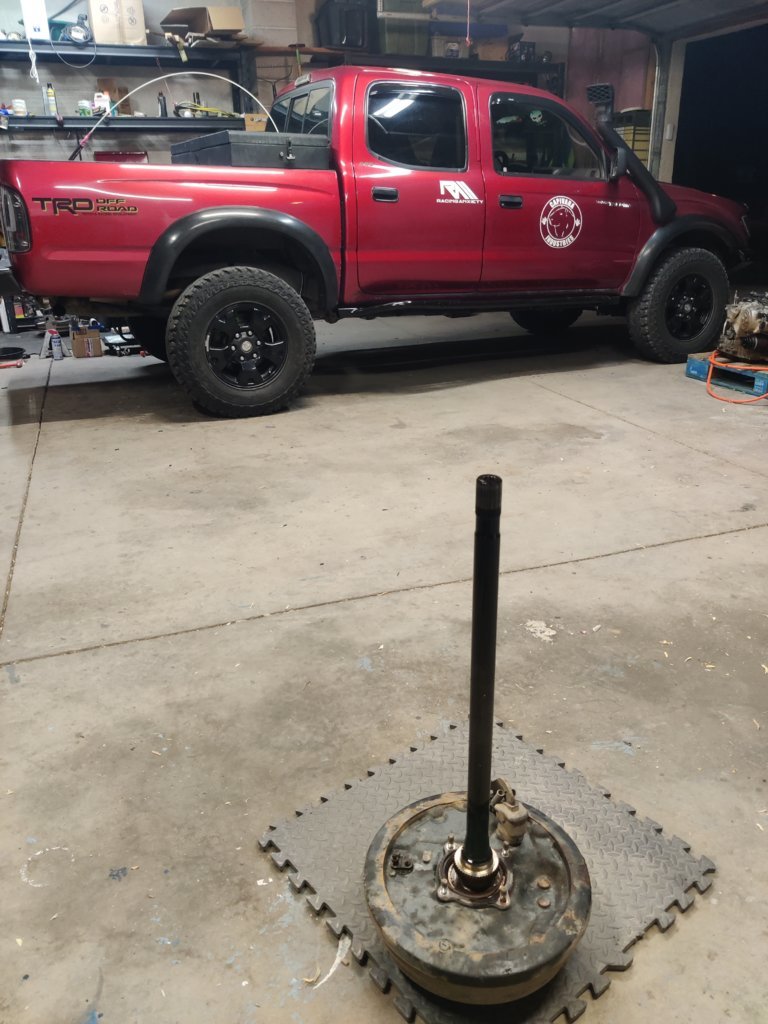

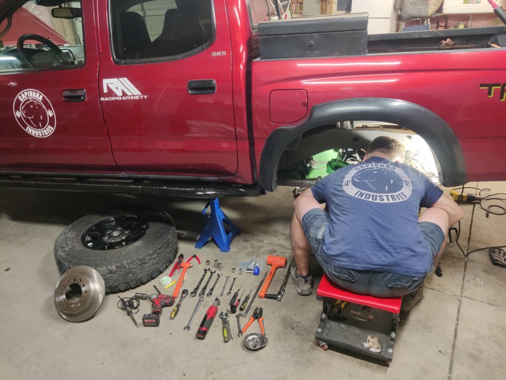

    Teaser shots. More to come just waiting for an international patent to be finalized in about a week.
    Now my truck has 3 different prototypes from 3 different companies. This one is definitely the biggest, heaviest, and possibly the coolest but also the hottest at the same time

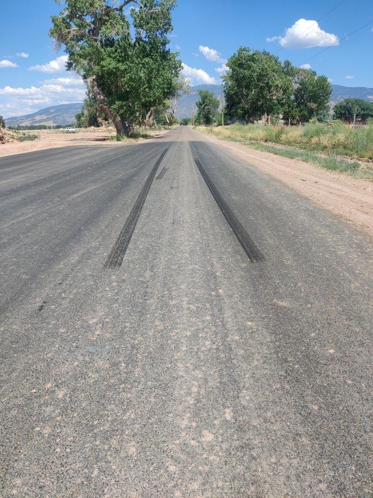

    I think it's safe to say my ABS no longer works
    I had a feeling the newer ABS sensors wouldn't play well.
    The E brake was dragging on our initial test drive so the rotors got nice and hot but luckily didn't seem to warp.
    We will be doing a handful of controlled stopping tests in a few weeks to compare the distances from before and after the disk swap. The kit for the conversation will be available to purchase through a Toyota dealership in AZ sometime in November if everything goes to plan and they will be releasing all the info at SEMA this year.
    Hopefully we can get the ABS figure out because I'm sure that will impact the stopping distance
