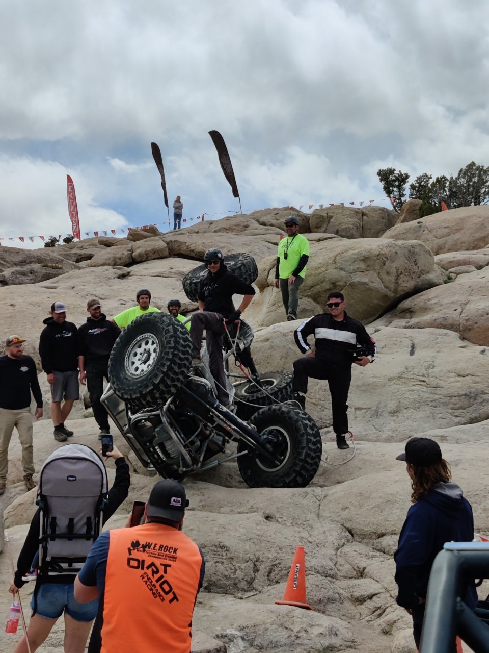

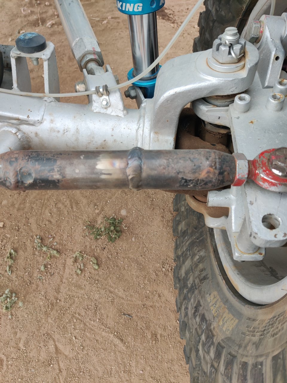

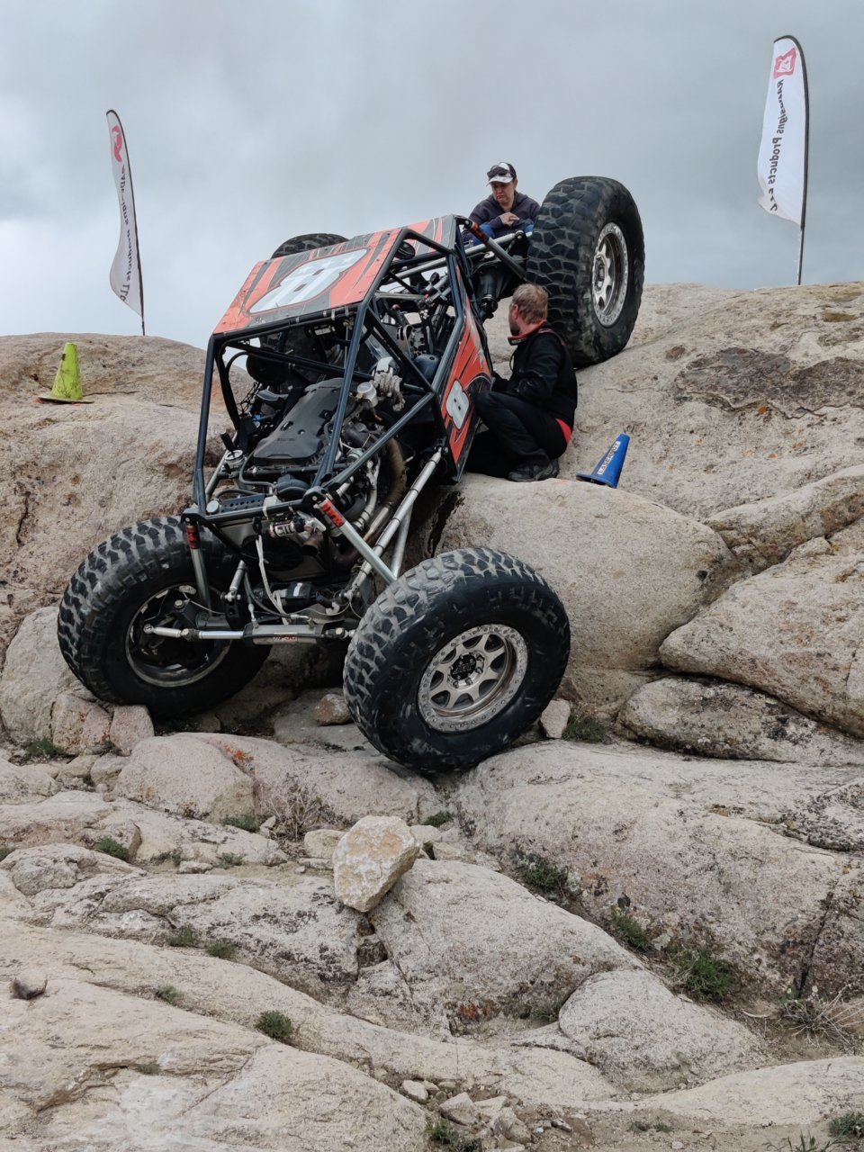

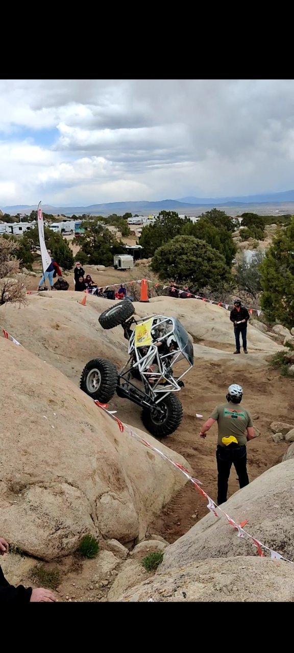

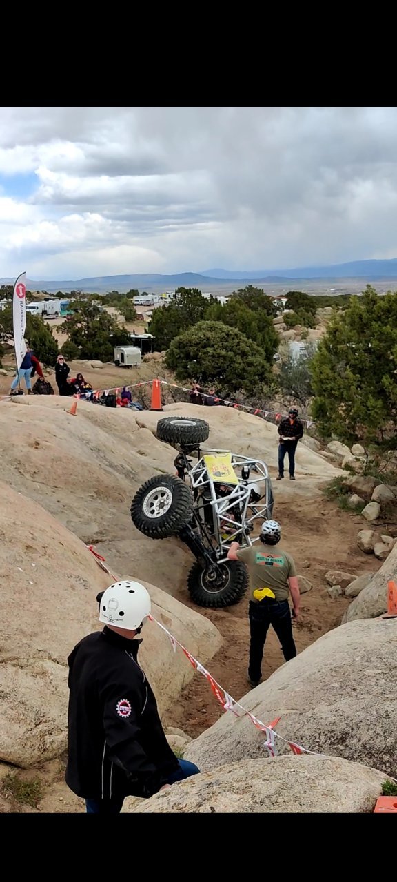

    IMG_20220430_142811.jpgSend It Racing pushing it across the finish line without steering during the WE Rock competition. Everyone is looking up at the Judge for the ruling. there's not much left to hint at its Toyota pickup roots.
    A quick weld job and he was up and running again
    These rocks are tough on rigs that's for sure.

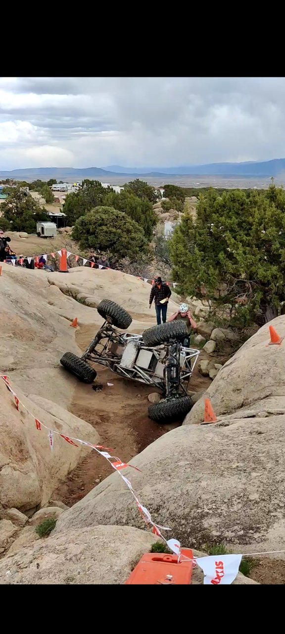

    with a little help from the crowd we got this buggy back on all 4 and it drove away a little worse for wear.

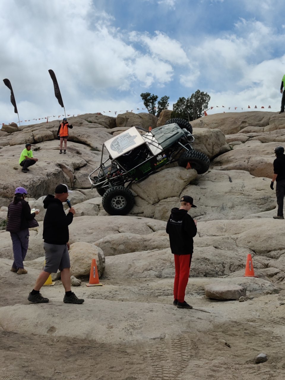

    Next up was Mark Schultz and dang this was proving to be a tough spot
    At least he made it on the wall. When he bumped the back axle up the wall the belly pan smacked the rock face so hard the impact threw the distributor cap and rotor off leaving him stranded on the wall.
    Well it is

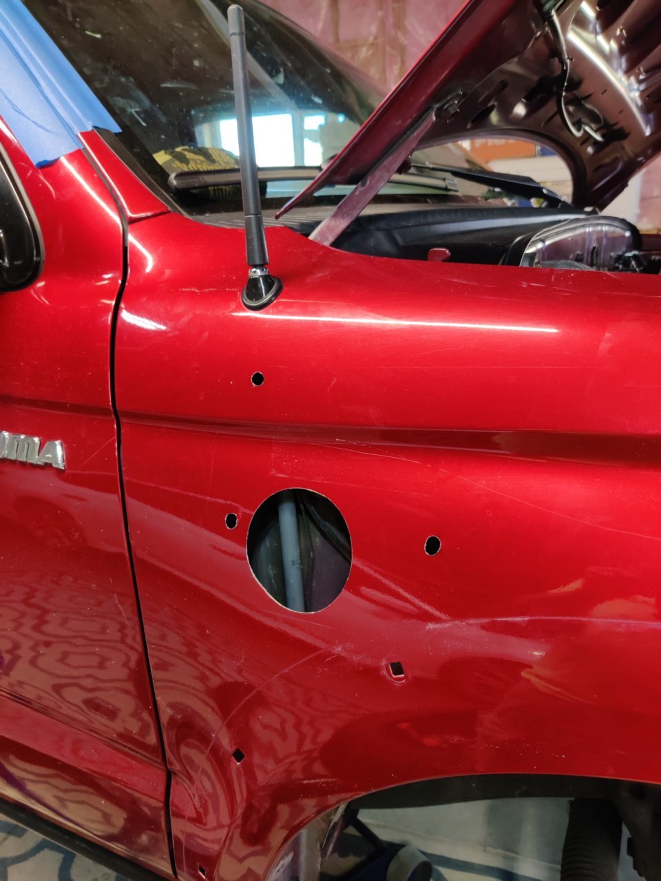

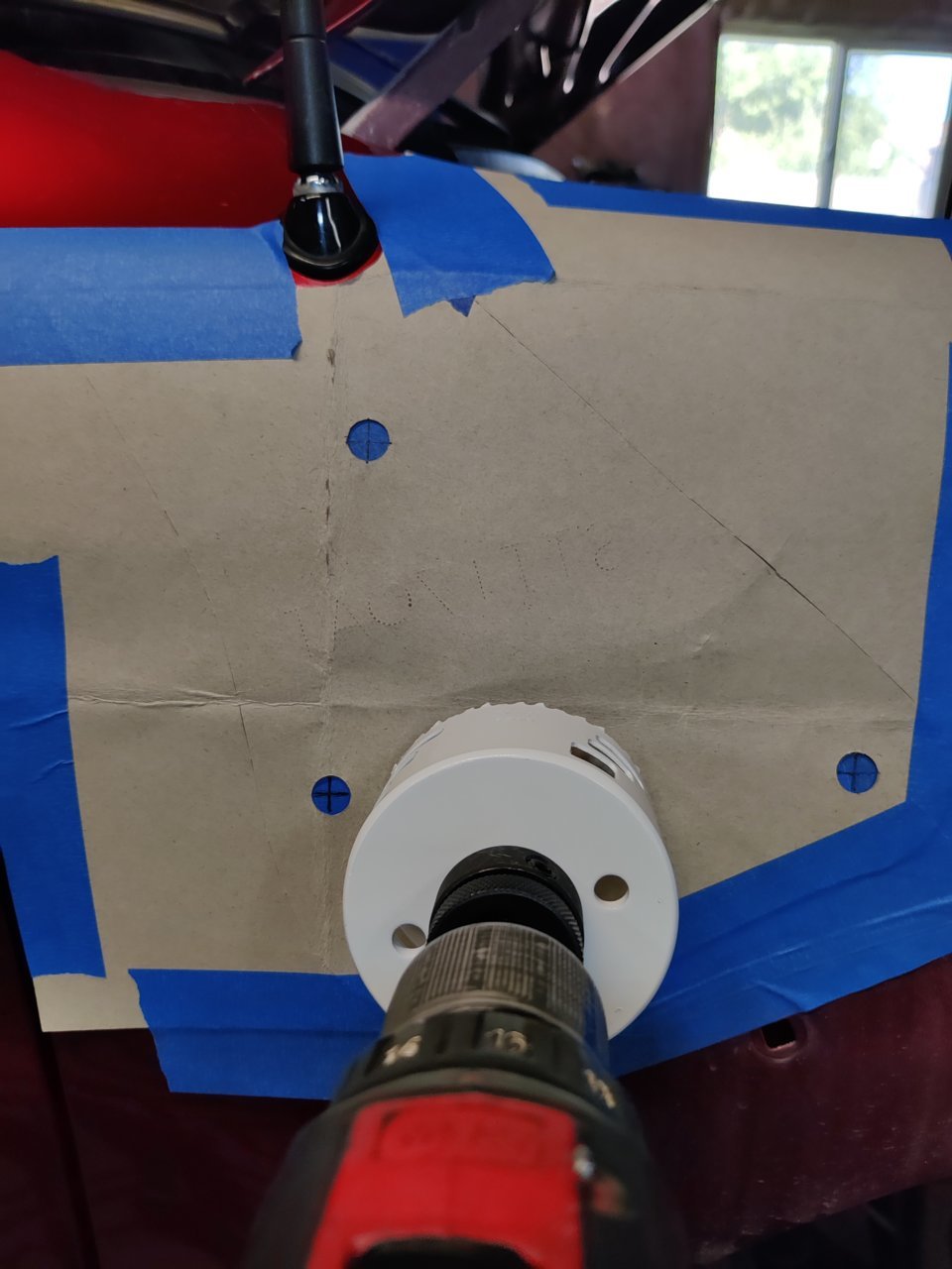

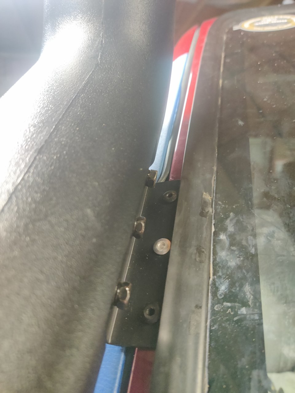

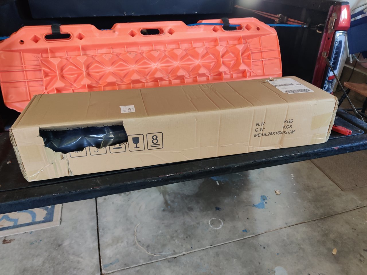

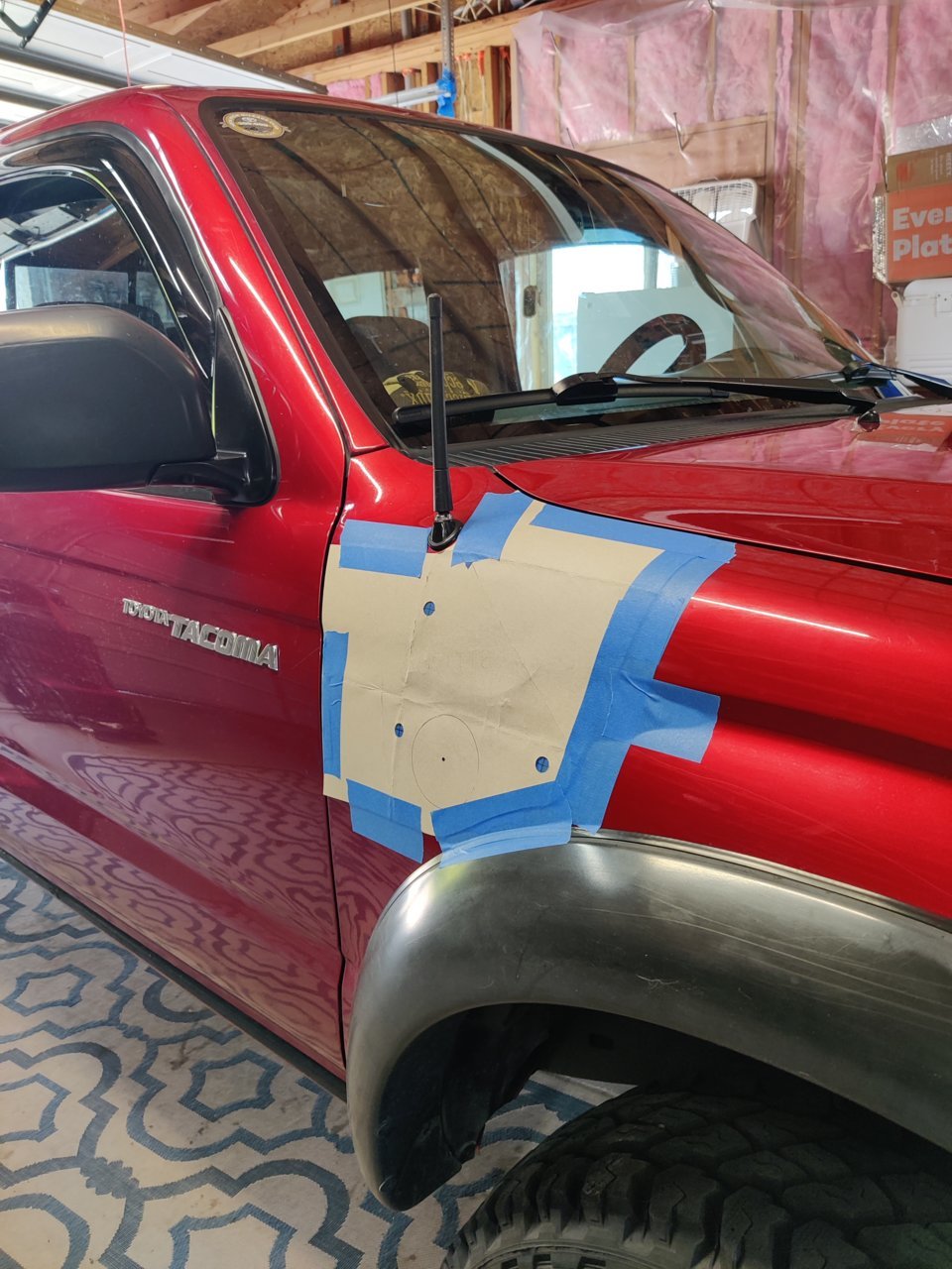

    It's always a good sign when there's a big hole in the box.
    No missing pieces, no problems :thumbsup:

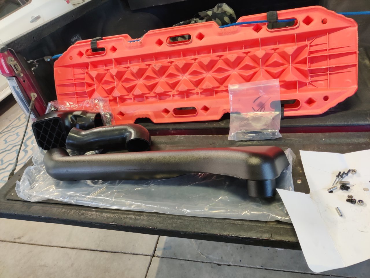

    Get the big hole over with first

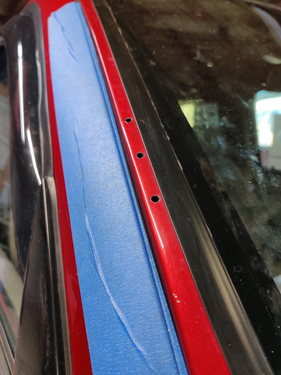

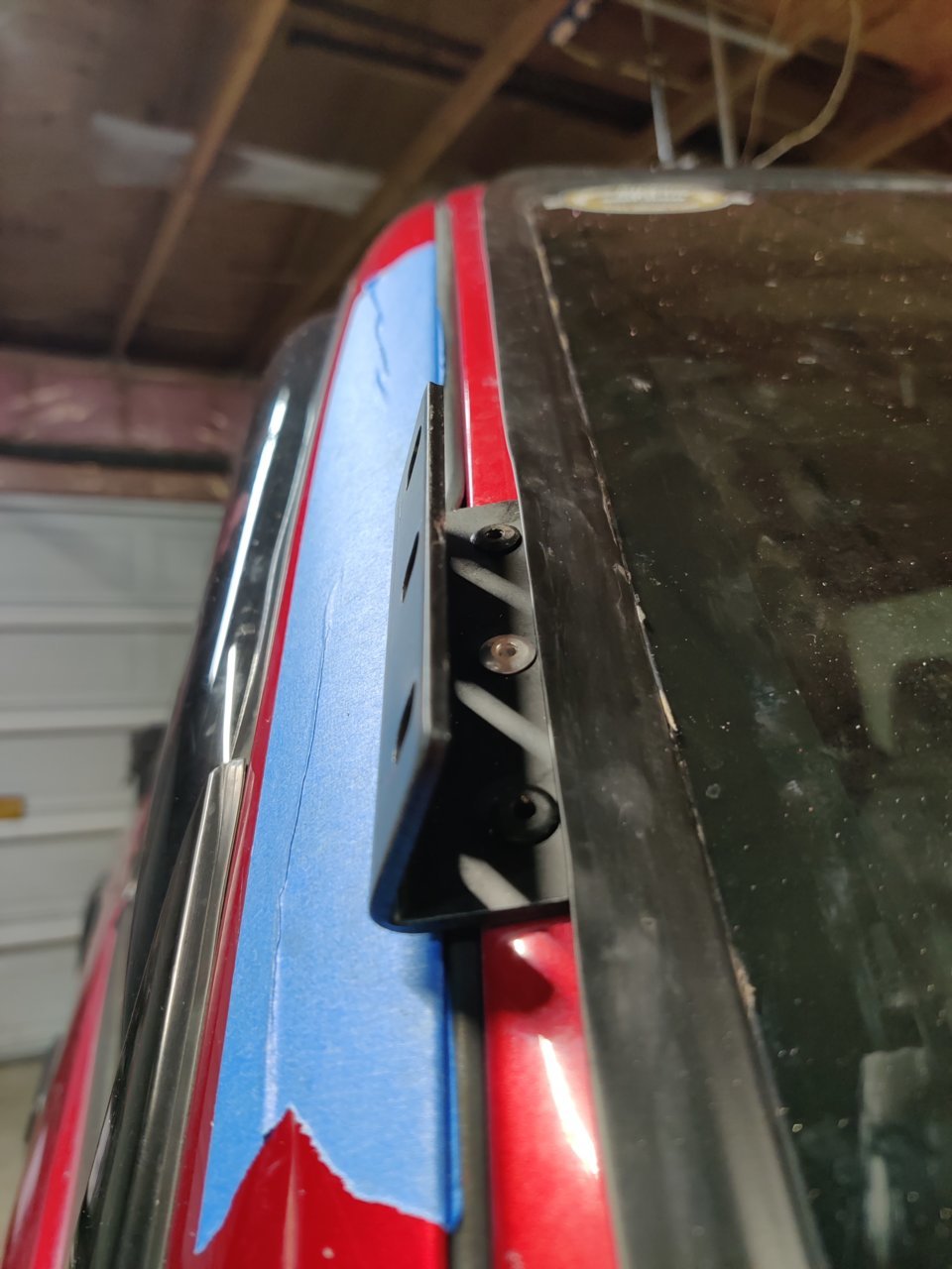

    Once you have that first major hole you can line up the snorkel flush with the fender and make any adjustments you deem necessary from here.

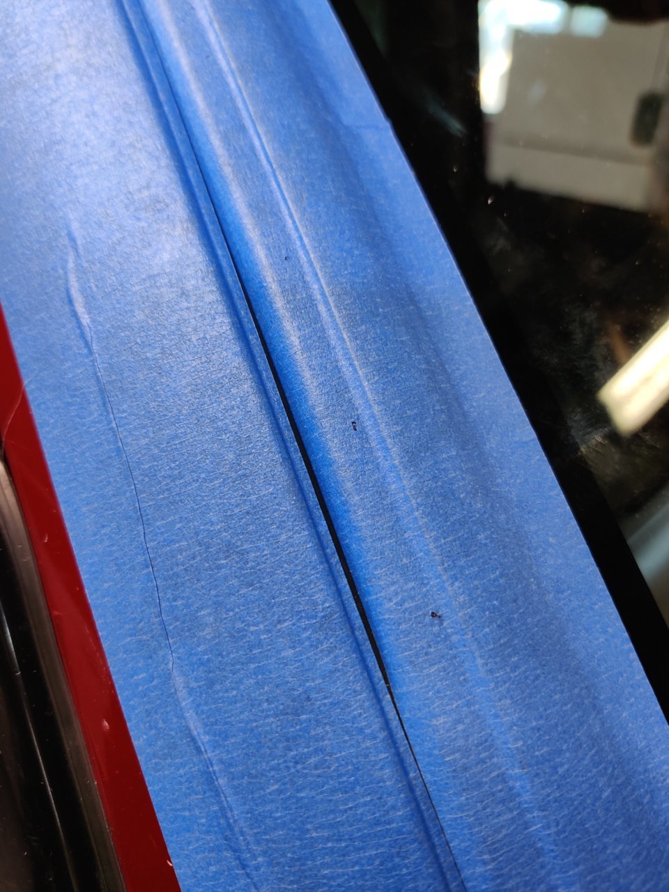

    I added a little FIPG between the A pillar and the bracket as well as each hole before placing (driving?) the rivits just for a little extra mental comfort

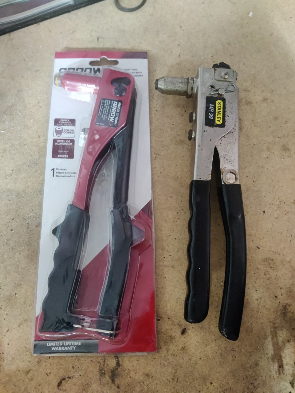

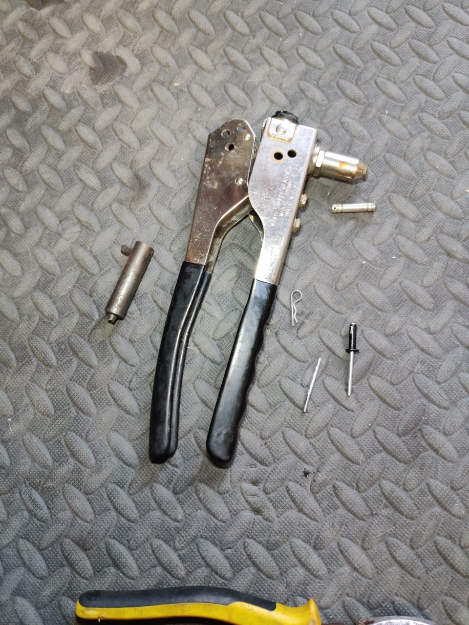

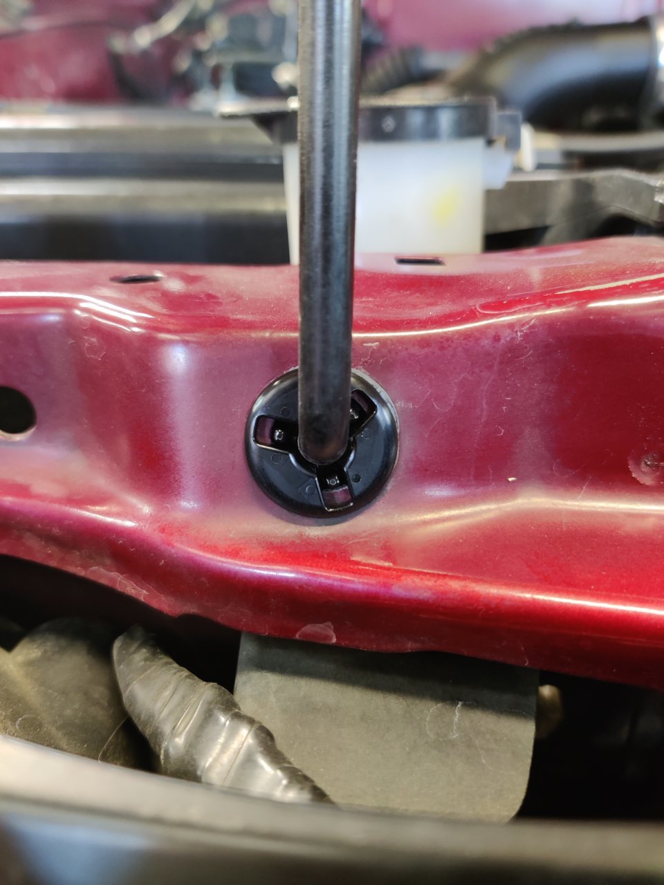

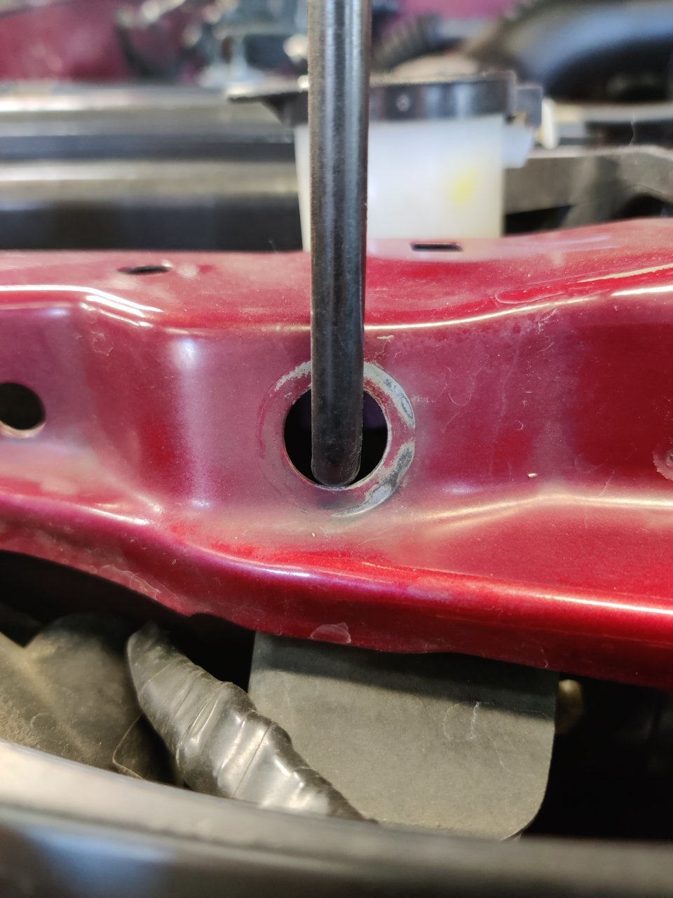

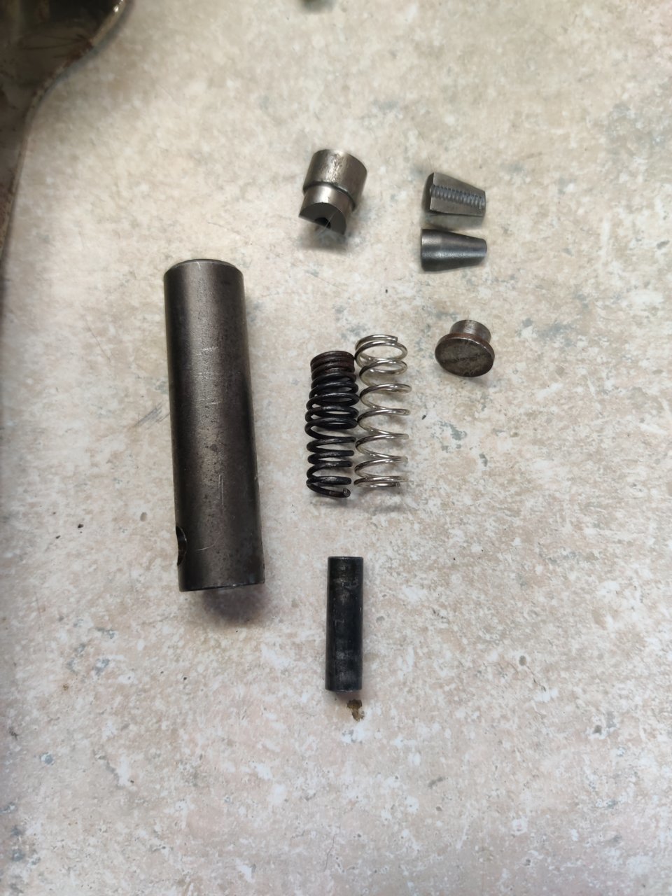

    Everything was going well right up until the moment I popped the first rivit and the stud got jammed in my old hand me down riviter.
    I was really not expecting problems at this stage and I usually find rivits oddly satisfying not frustrating.
    With one rivit in place and A 15min clock on the FIPG I took the riviter to the vice and broke it down Barney style
    Removed the stud and popped the bottom rivit in place only to find it jam once again and I accidentally dropped the stud to the 3rd rivit down into the A pillar. Pretty sure I'll never see it again and being that I haven't used rivits in the past 5 years I had to go buy a pack and figured I'd buy a cheap riviter since this ol Stanley is being troublesome
    What a flop. I had 1 rivit for the new riviter to do and it popped the stud in the wrong spot and wouldn't bite back on to what was remaining so I used the jam happy Stanley after all.
    Now it's time to go Scooba diving
    Scary deep broo almost needed it
    I actually ended up finding a perfect replacement spring for the Stanley a couple day later and it's working good as new. Home depot can have their crappy one back

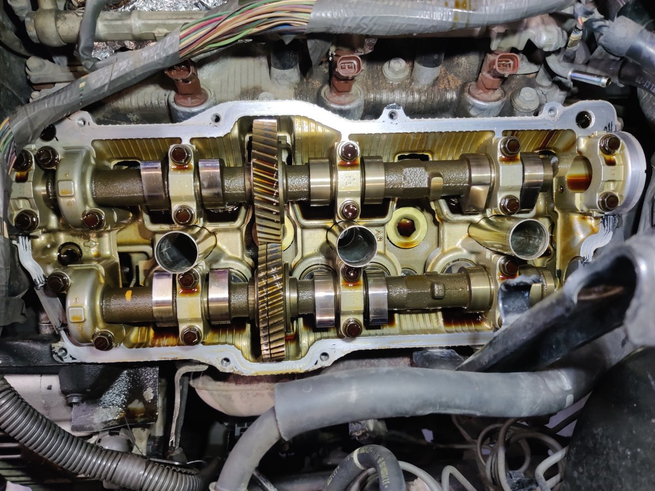

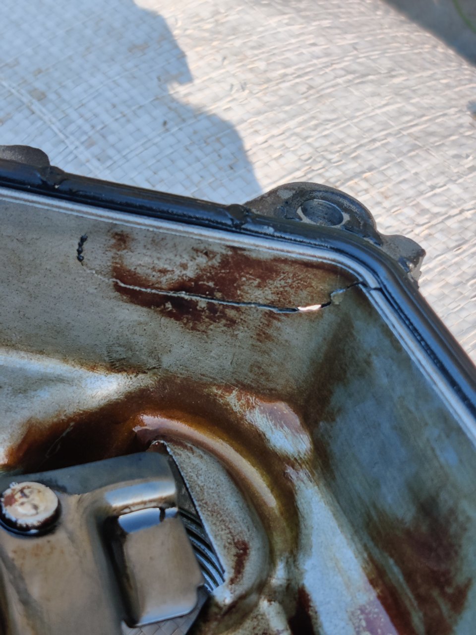

    The crack in my valve cover finally started leaking. I can honestly say I'm impressed. I cracked it almost a year ago and had a replacement Doorman cover in the parts shelf for about 7 months. I even took it with me during Christmas vacation just in case
    :anonymous: yes that's daylight in the crack
    It's nice to see the motor oil is keeping things looking fresh
    I was happy when I looked at the clock and realized I finished everything in just over 3 hours

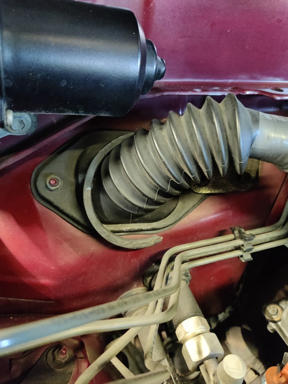

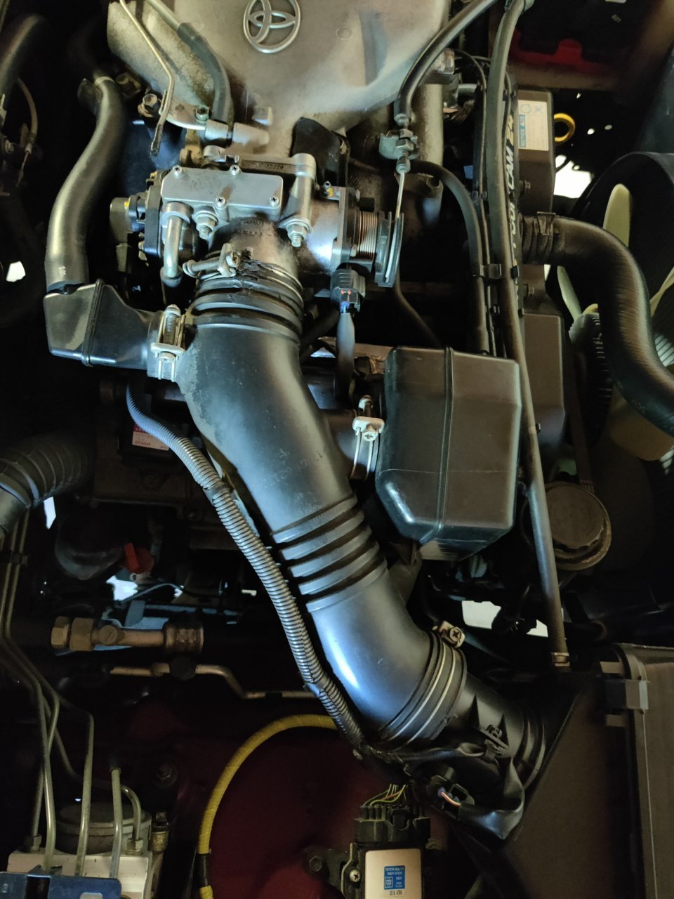

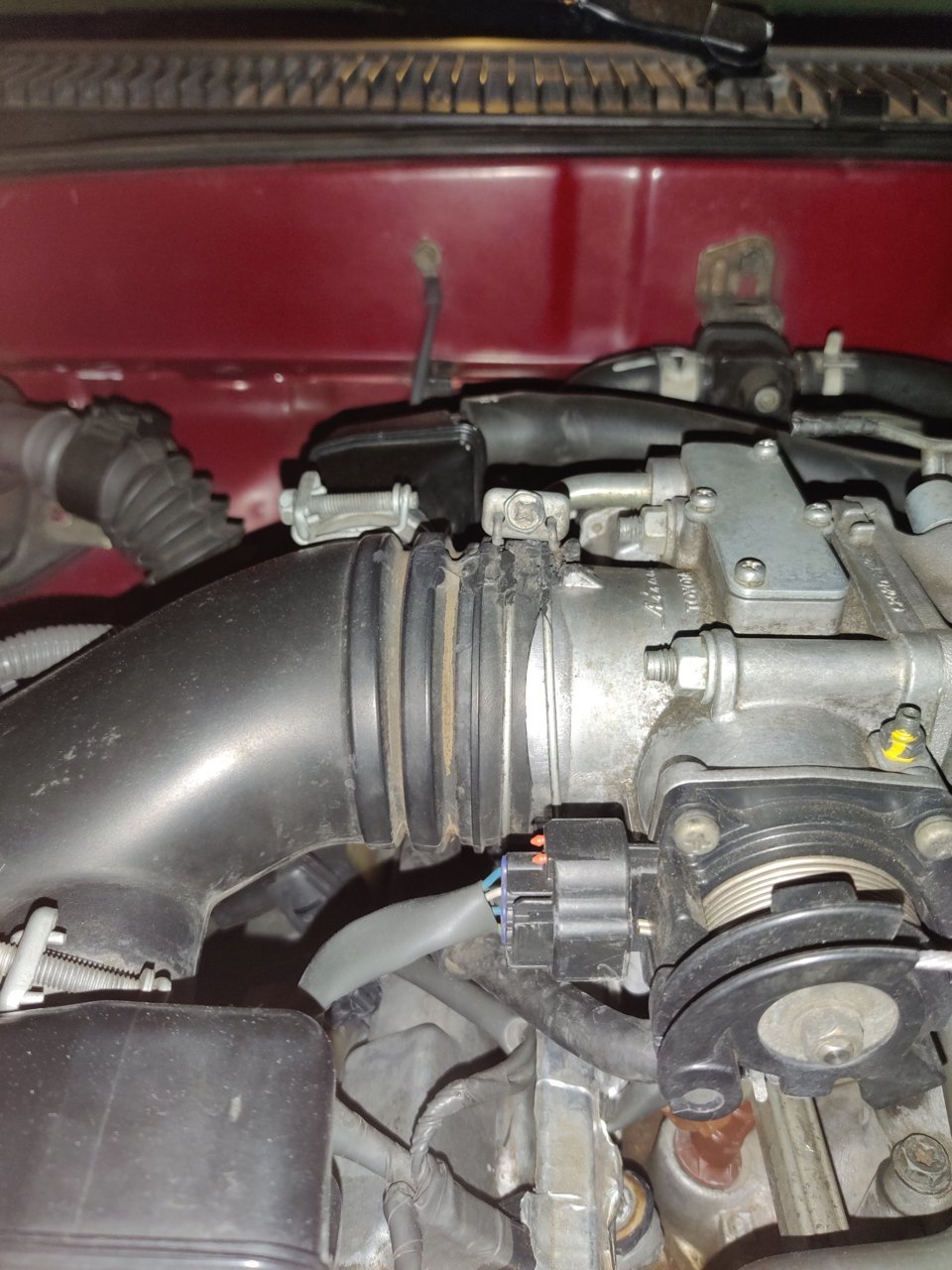

    I was however finished with the stock air intake tube falling apart
    I couldn't find the missing piece for the lift of me and I never even noticed the end ripping off until I went to put in back on
    But I don't need it anymore..

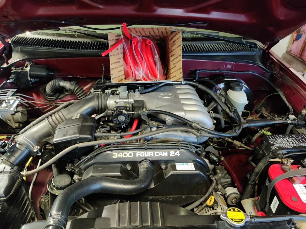

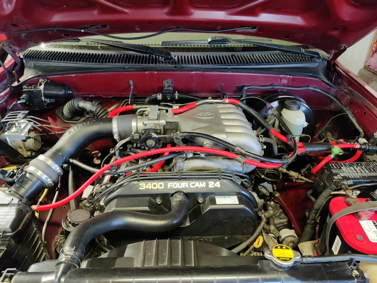

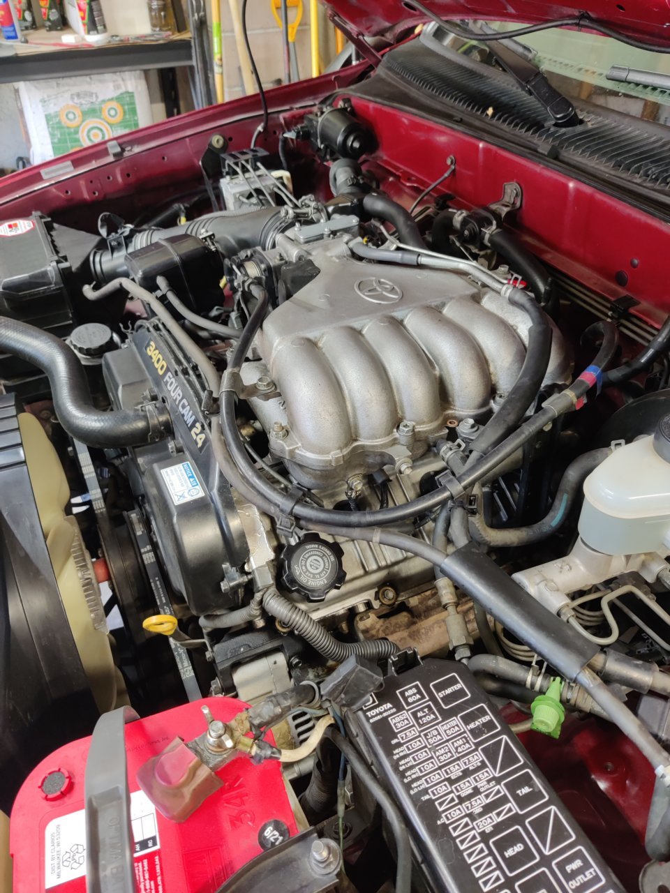

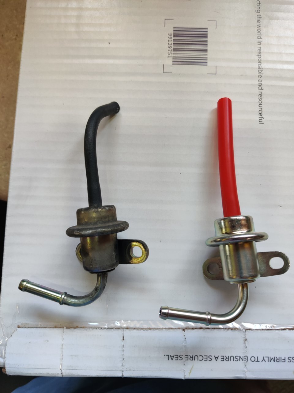

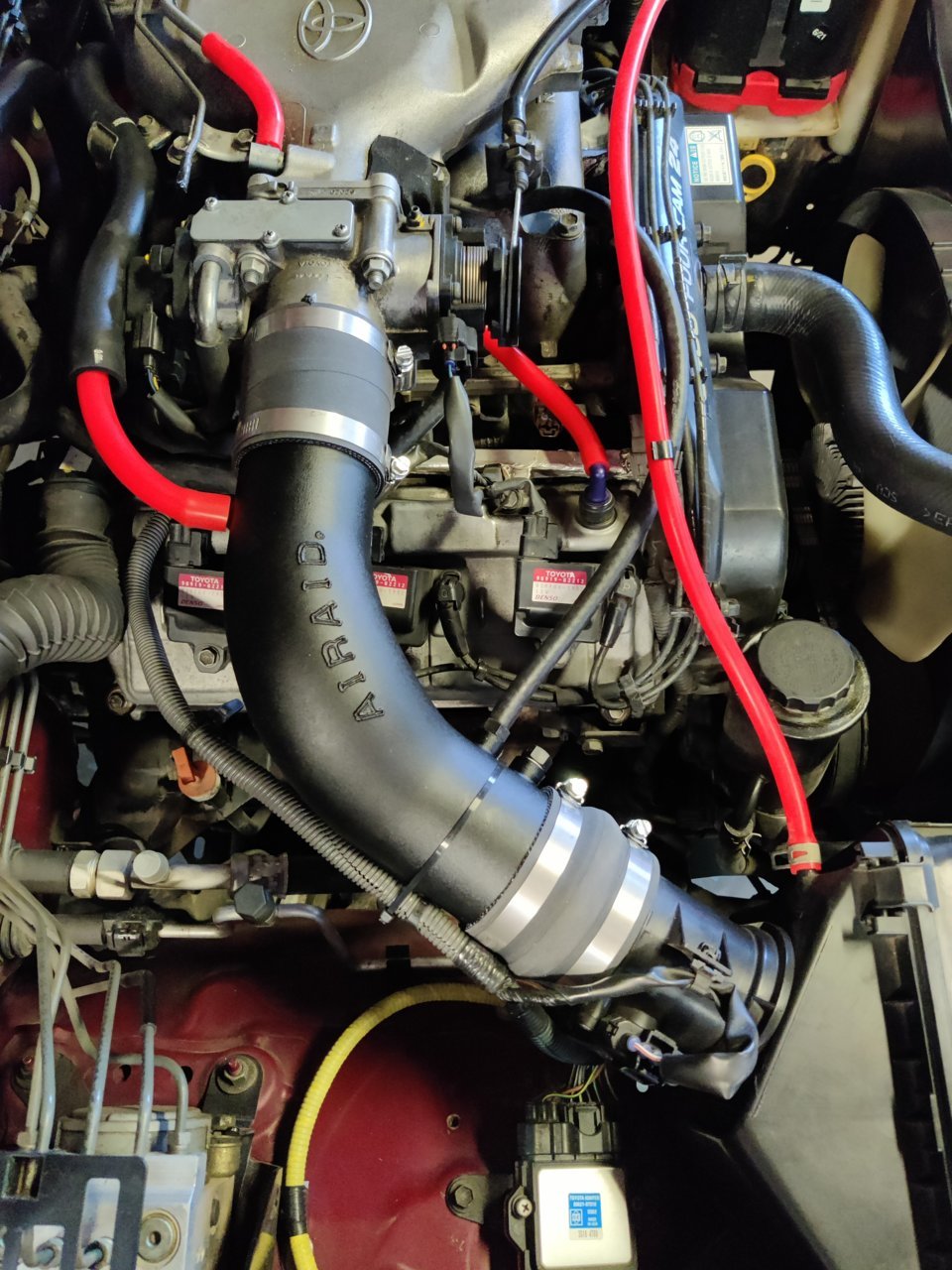

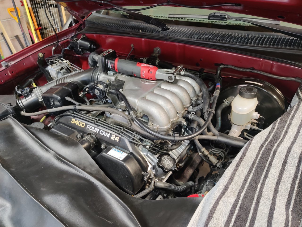

    I replaced a bunch of vacuum lines today using Silicone Intake System's Silicone Boost/Vacuum Hose Engine Dress Up Kit in red (black was out of stock also available in blue). I also replaced the air intake tube for the Airaid intake tube from Jegs instead of the OEM option.
    Before
    After
    Before
    After

    Been wanting to do this. Was this a kit or did it come in a roll to cut to length?

    You cut them to size. I didn't use a single foot of the longest hose they sent me 10ft of 4mm I think and ran short of the 8mm hose that fit the most things

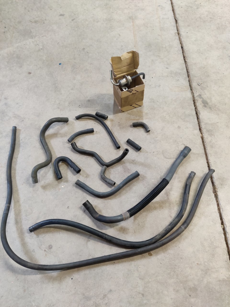

    @ijm01PR
    Here's all the old vacuum lines i replaced under the hood
    I did end up using a little piece of the 10ft 4mm Silicone hose
    I also got an email about a discount code from Silicone Intake solutions today :thumbsup:

    How much of a PITA is it to replace all of the vacuum hoses?

    Most of them are really easy and with strong enough fingers you don't even need plyers. It also helps that there's a diagram right inside the hood.
    Sometimes the hoses stick and that can be a pain in the ass but if you are replacing them you can just splice the vacuum line open and end that fight

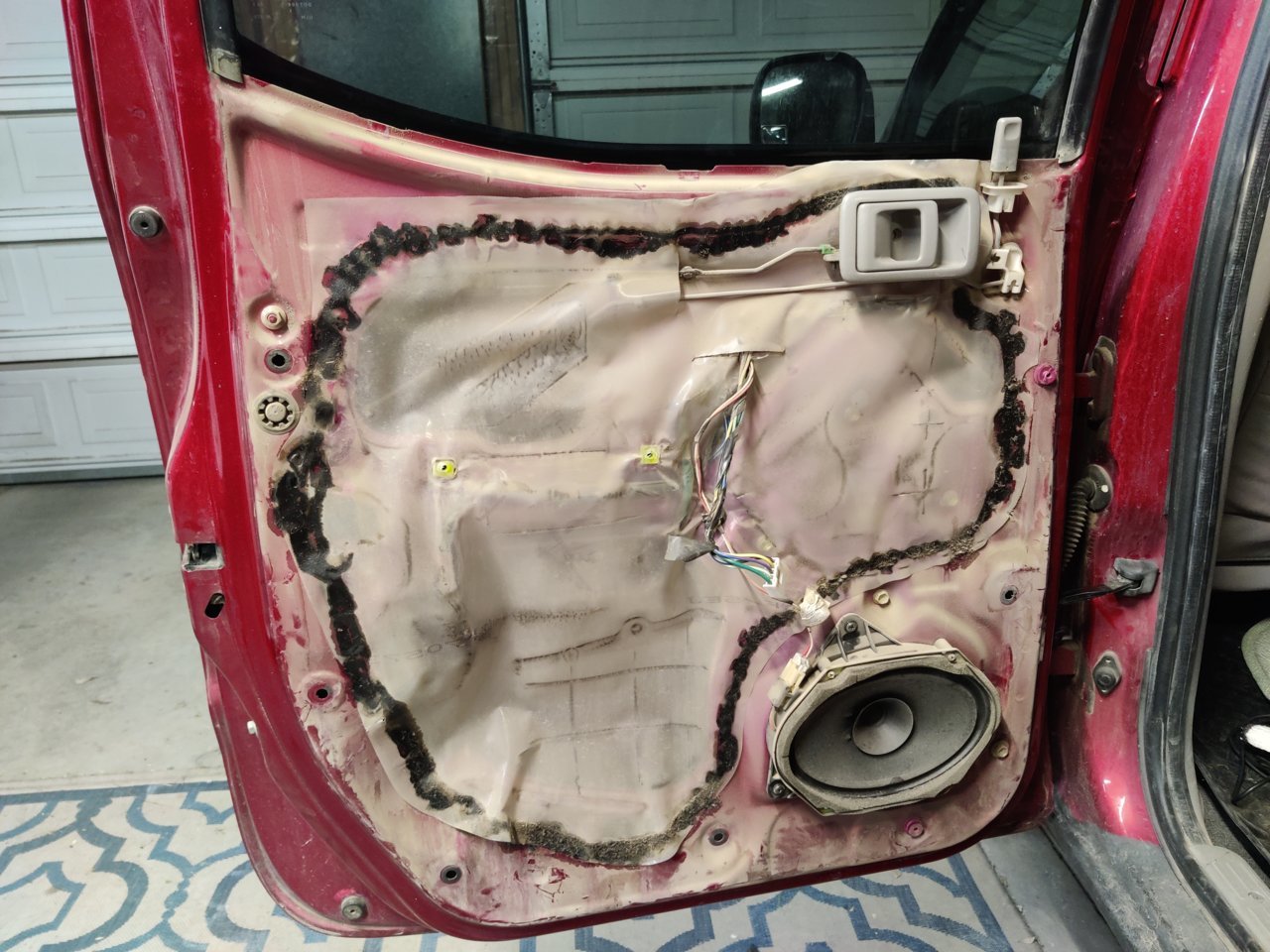

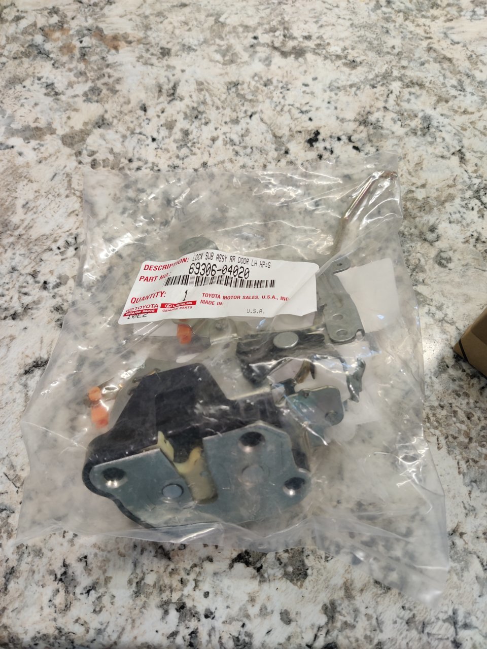

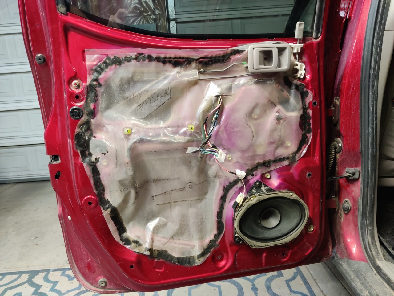

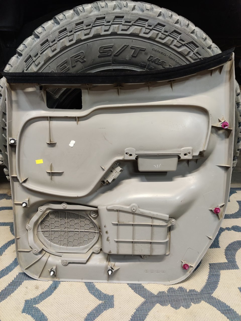

    Every now and then when I go to shut the back door on the drivers side the door just bounce off the latch. I've tried cleaning it and added graphite a few times to no avail. so I ordered a replacement from Toyota last Wednesday
    :spending:
    I anticipated this bad boy would ferment on the shelf for a while but hit a second wind today and thought I better get what I have installed before the rest of my parts start showing up.
    A clean work space is important to me especially when my allergies flare up
    After three 10mm nuts, three #30 torques screws and three plastic clips you can pull the assembly out. There's also 2 more small Philips screws that hold the electric lock mechanism to the latch assembly
    If only the new parts could just stay clean forever
    I like to do a function check and close the door and make sure the locks are working before putting the door panel back on
    I also went ahead and replaced 4 of the warn our panel clips
    A bit of a pain in the neck but that's what it's all about and now my door shuts with a satisfying thump instead of shattering clang
