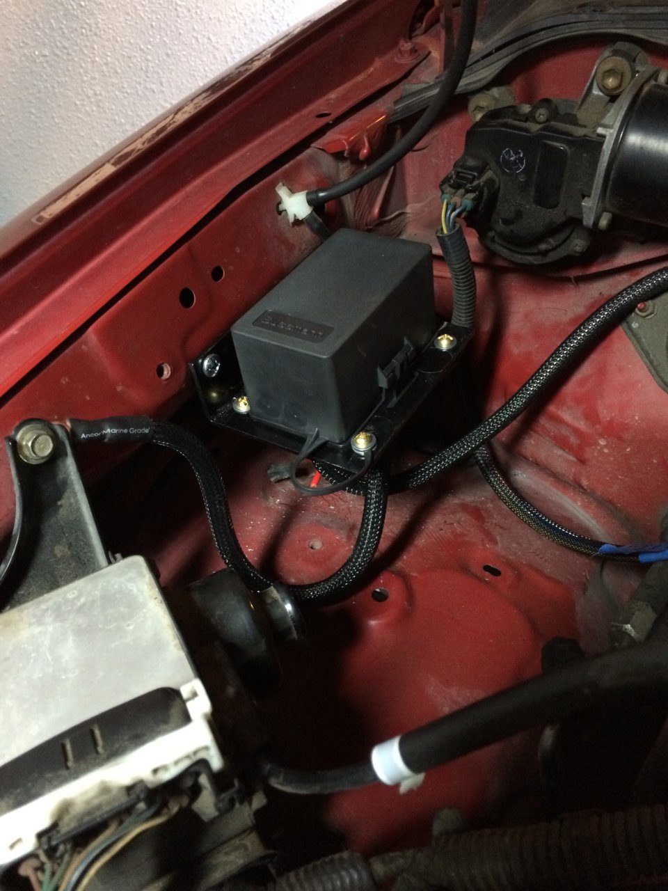

    Something like this?
    Blue Sea Systems ST Blade ATO/ATC Fuse Blocks https://www.amazon.com/dp/B001P6FTHC
    Dual battery's and a smart solar charging system would be awesome but probably more than I would ever need (but that's also exactly why I want it)
    I do plan on running a winch at some point but would like to make some improvements to the old wiring first

    Yep that’s the one. I like Simple and organized.
    I prob don’t need another battery but am wondering if I should. I’ll be putting just some flush mount leds on the rear bumper, ditch lights and led strips in the cap.
    currently searching for a locking rear axle and front end for the swap so tossing around whether I’ll wire that to the Oem box or add to the blue sea box.

    Granted my 98 doesn't have ABS but I put mine on the passenger side and it's fine there. If you plan on running switchbacks for switches inside the cab it's nice to have that real estate on the passenger side to create another passthrough through the firewall.
    Still haven't installed one in my 04 with ABS but I assume I'm going to put it on the passenger side much the same.IMG_6851.jpg IMG_6850.jpg

    That’s really where I was thinking of doing it. I orginally thought it was a little unconventional running leads across the firewall from the battery but I really like the space on that side. I can foresee it being a lot neater.
    I’m sold, thanks @Madjik_Man

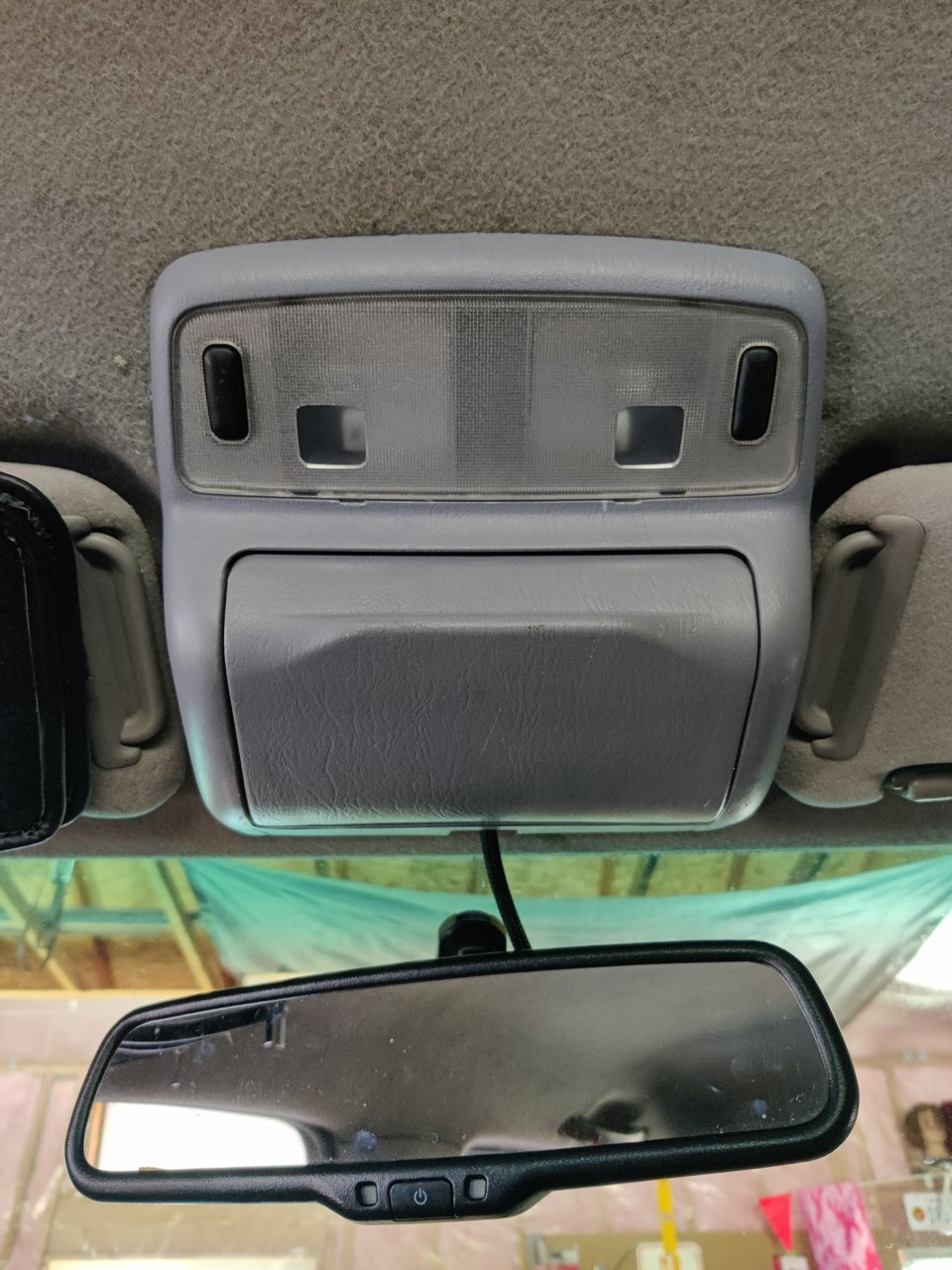

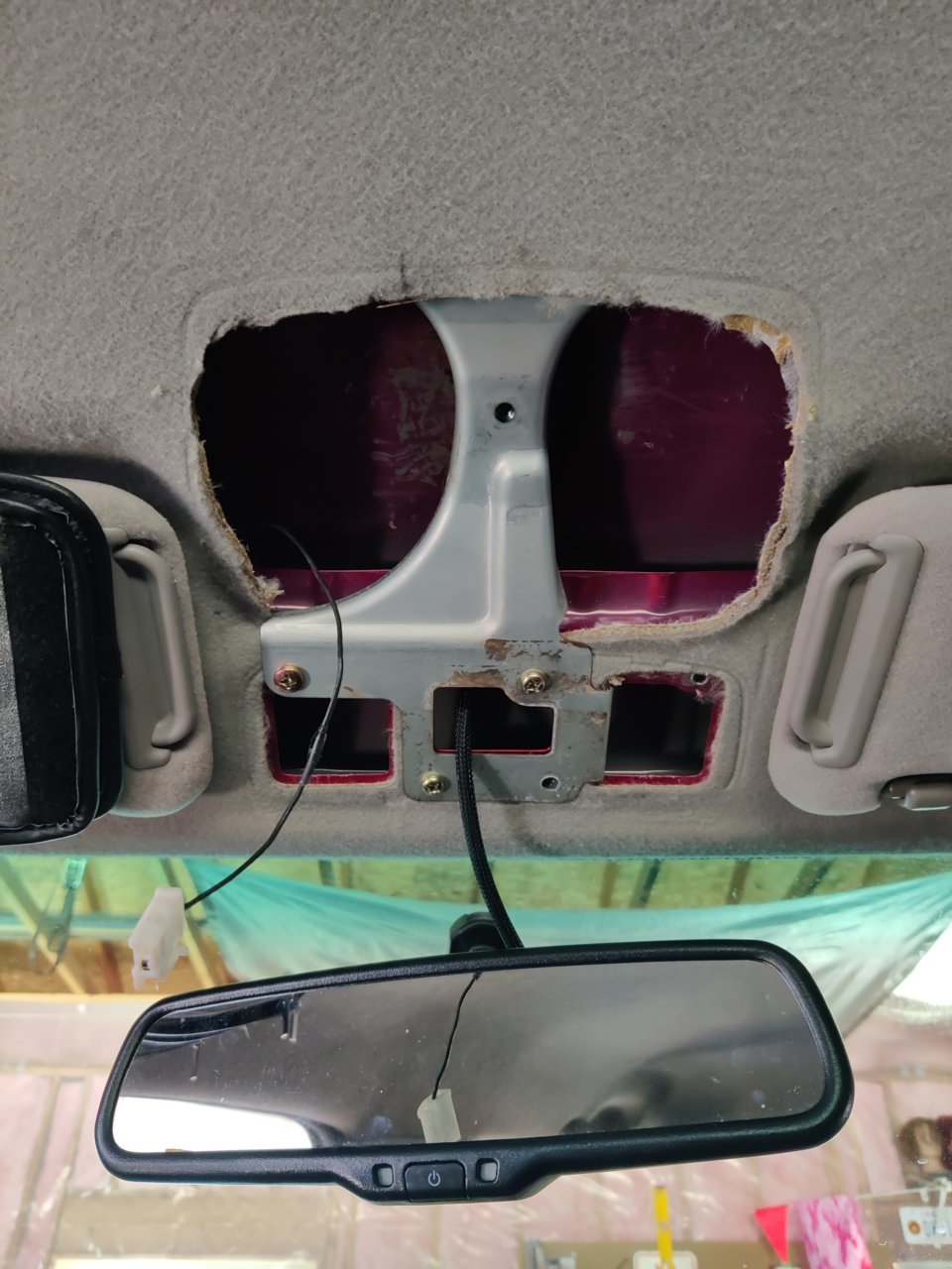

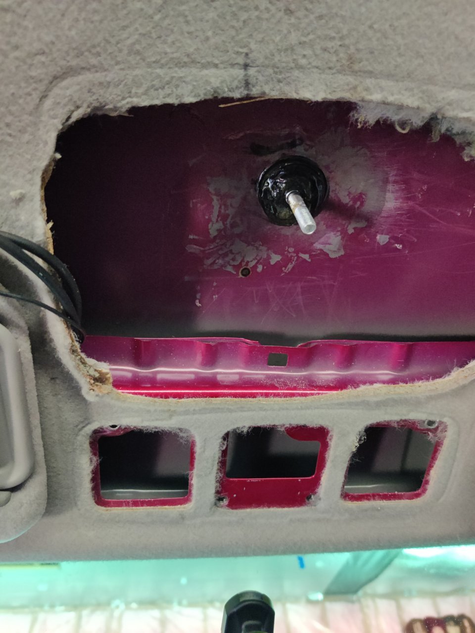

    I let the 4runner sunglass holder ferment on the parts shelf long enough.
    FREE PARTS ARE THE BEST PARTS
    Man that's an ugly hole in the head liner
    If only I had something to fill that empty hole inside haha
    :thumbsup: :fistbump: thanks again for the bracket Alex

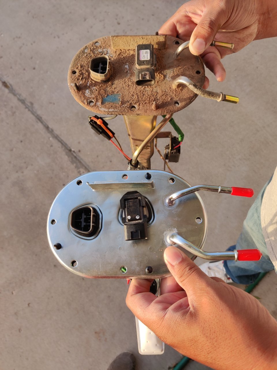

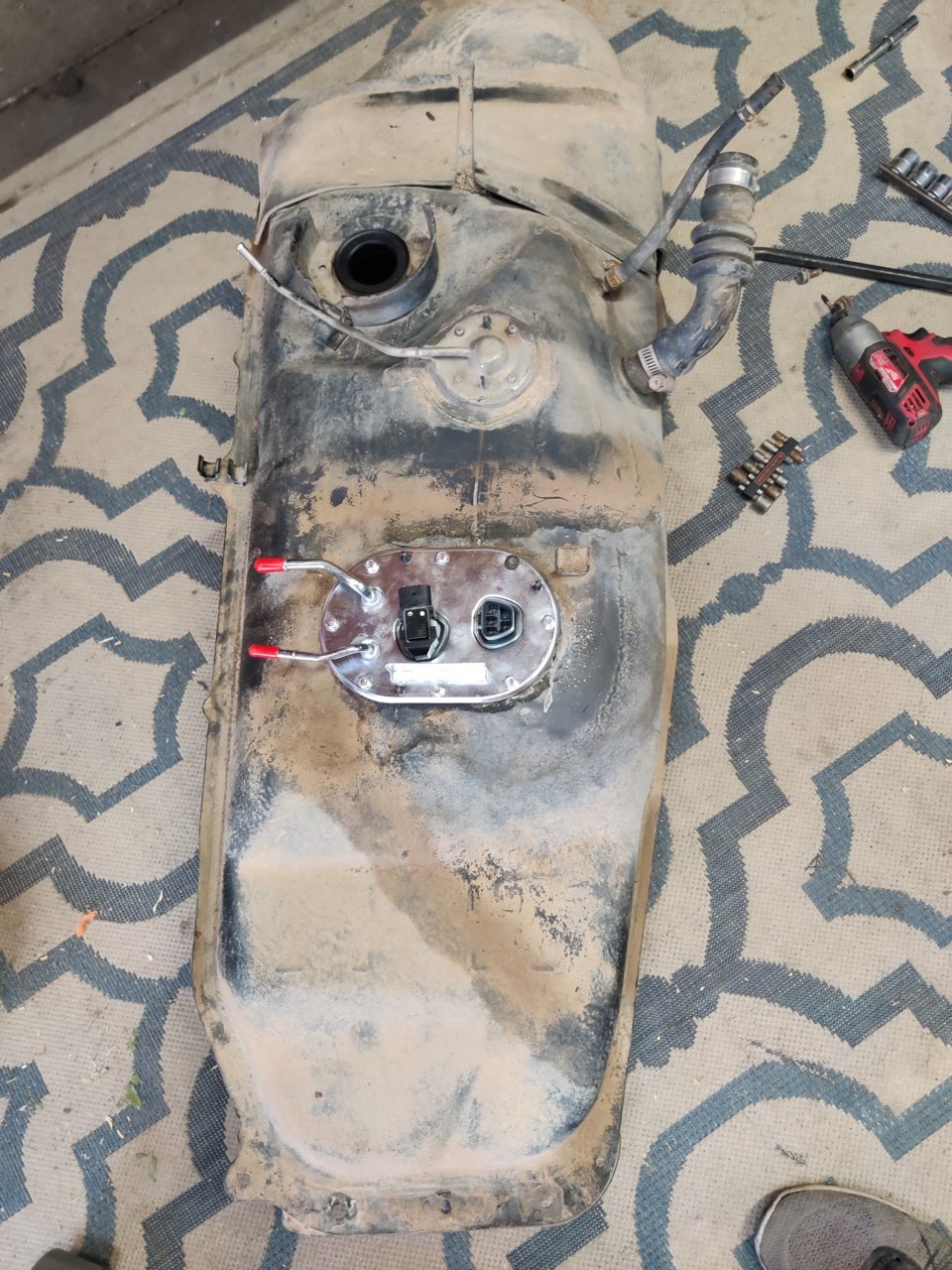

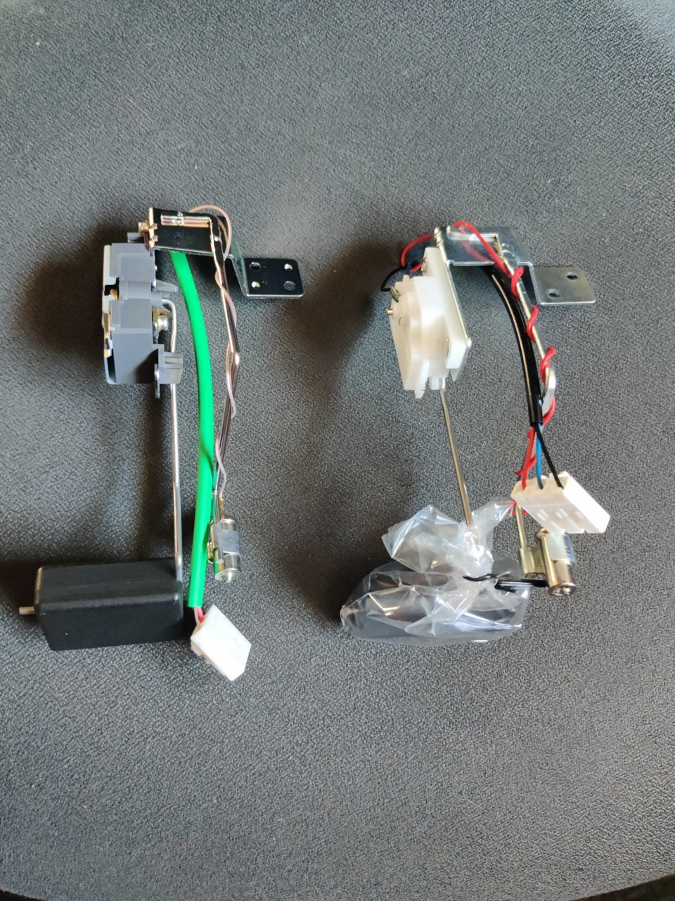

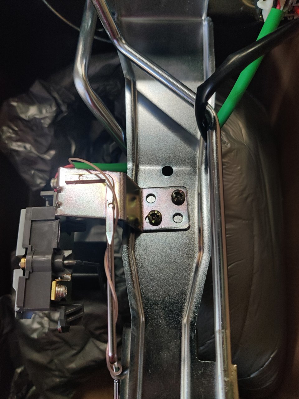

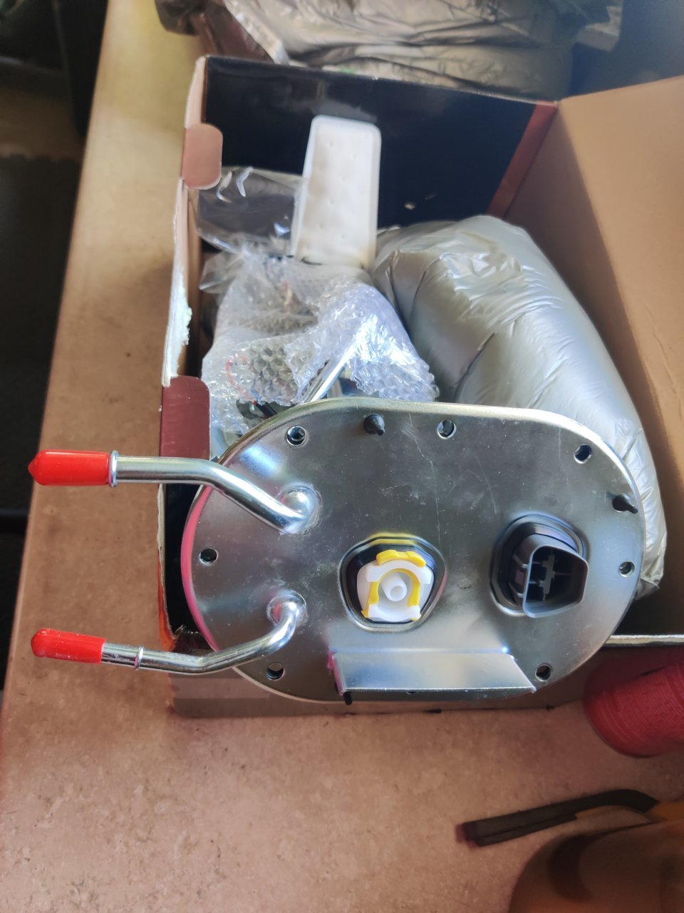

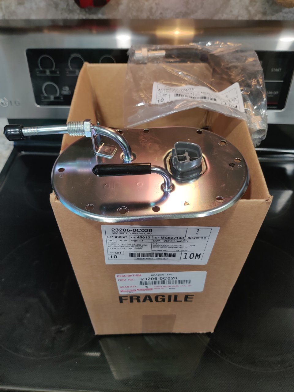

    The fuel pump hanger and fuel line I ordered from Toyota arrived but ended up being a flop (my fault not theirs).
    Parts received were for the 16gal tank found on the extra cab :facepalm:

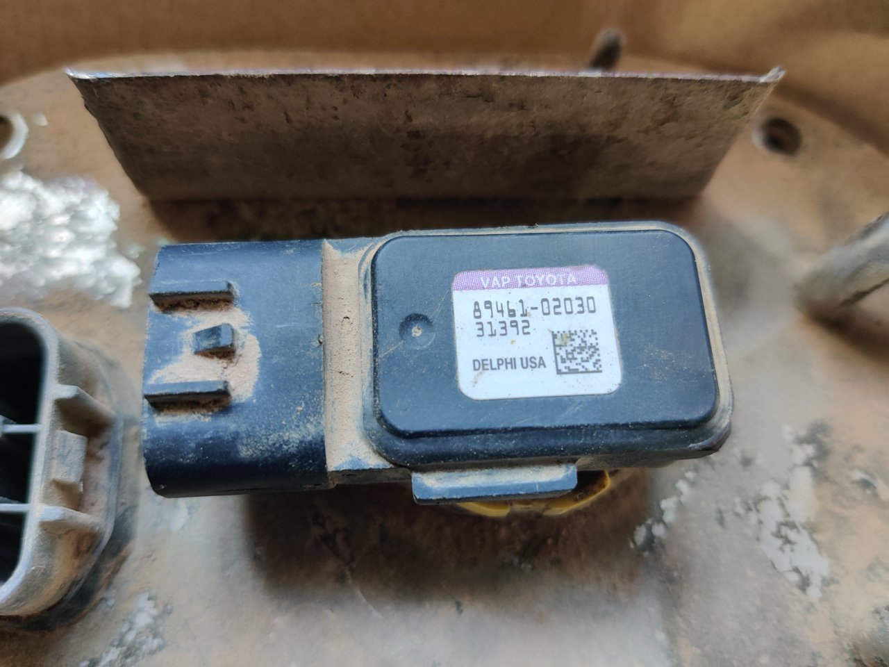

    Dead give away is the missing port for the fuel pressure sensor that receives information from the fuel sending unit and the pressurized fuel line leaving the tank is threaded where mine uses a simple plastic clip hopefully someone can learn from my mistakes.

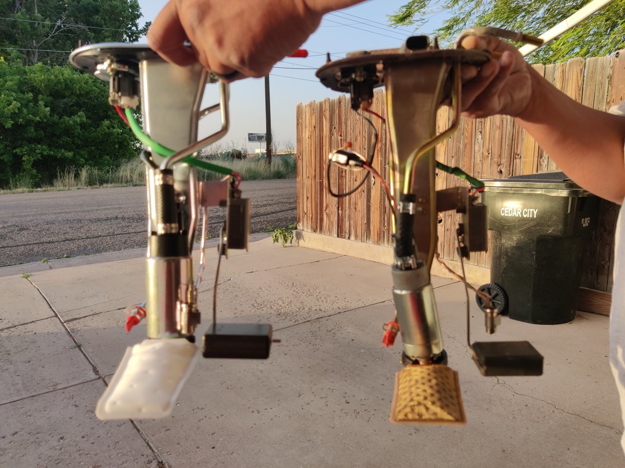

    :anonymous: out of frustration and desperation I ordered a complete fuel pump hanger assembly from Ebay and the entire thing was only $103 delivered to my house. $17 less than just the bare bones fuel pump hanger from Toyota.
    Now that's looking more like it!
    The fuel pump arrived just after 3pm on Friday and the AC in my house happened to be out so it was actually cooler in the garage than it was in the house :bananadead: perfect excuse to hang out in the garage.
    I had already ordered a replacement fuel guage sending unit from Toyota in January so I swapped that onto the new pump assembly before dropping it in the tank
    I did drill 2 holes in the Toyota unit in order to mount it to the aftermarket hanger with the existing hardware, a little unexpected but easy enough.
    Denso sending unit from Toyota was $150 PN 83320-35580
    I had a hard time finding the correct pressure sensor for the tank and ended up going with what they had at Napa for around $120
    Echlin Engine Management Product PN: 25623-60673
    Toyota / Delphi
    PN: 89461-02030 31392
    at least I have a spare fuel pump now.
    New hardware included always makes me smile, no more Philip's screws packed with dirt
    We slapped a new OEM tank band in before throwing the tank back underneath, the old one had bolts busted off inside that were sloppily drilled out for whatever random hardware the previous owner had on hand, I wasn't about to trust it to hold the extra weight of the Low Range tank skid I've had collecting dust on a shelf since November.
    It was definitely nice having a friend over for immoral support this time around, even if he drives a suburban.

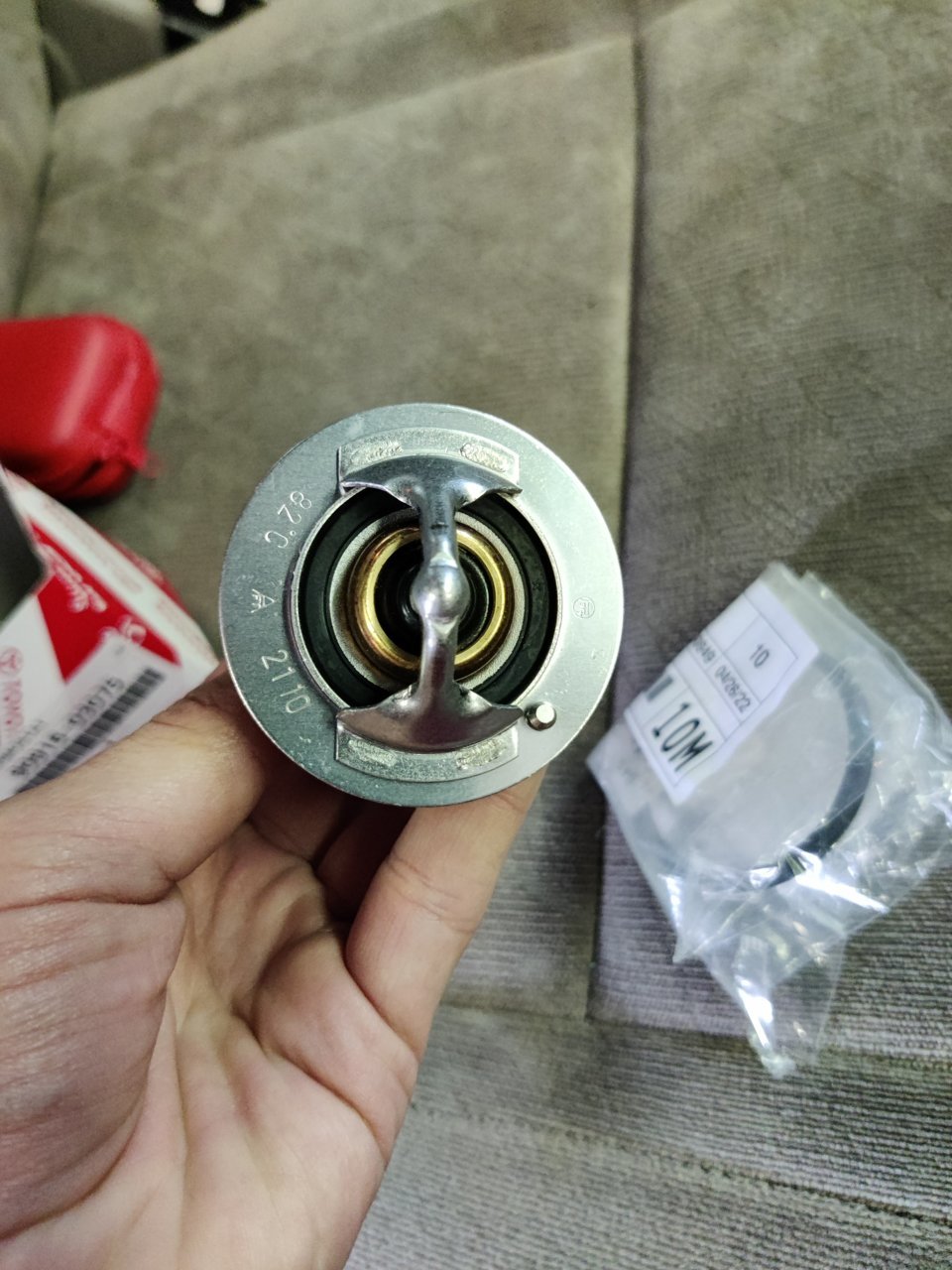

    I've suspected for a while now that the thermostat in my truck was going to have the jiggle valve sitting at the 12 o'clock position and sure enough it was.
    New OEM Thermostat installed with the jiggle valve at 6 o'clock :evil:

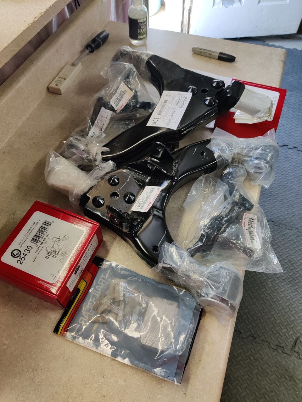

    Oh and more parts arrived :bananadance:

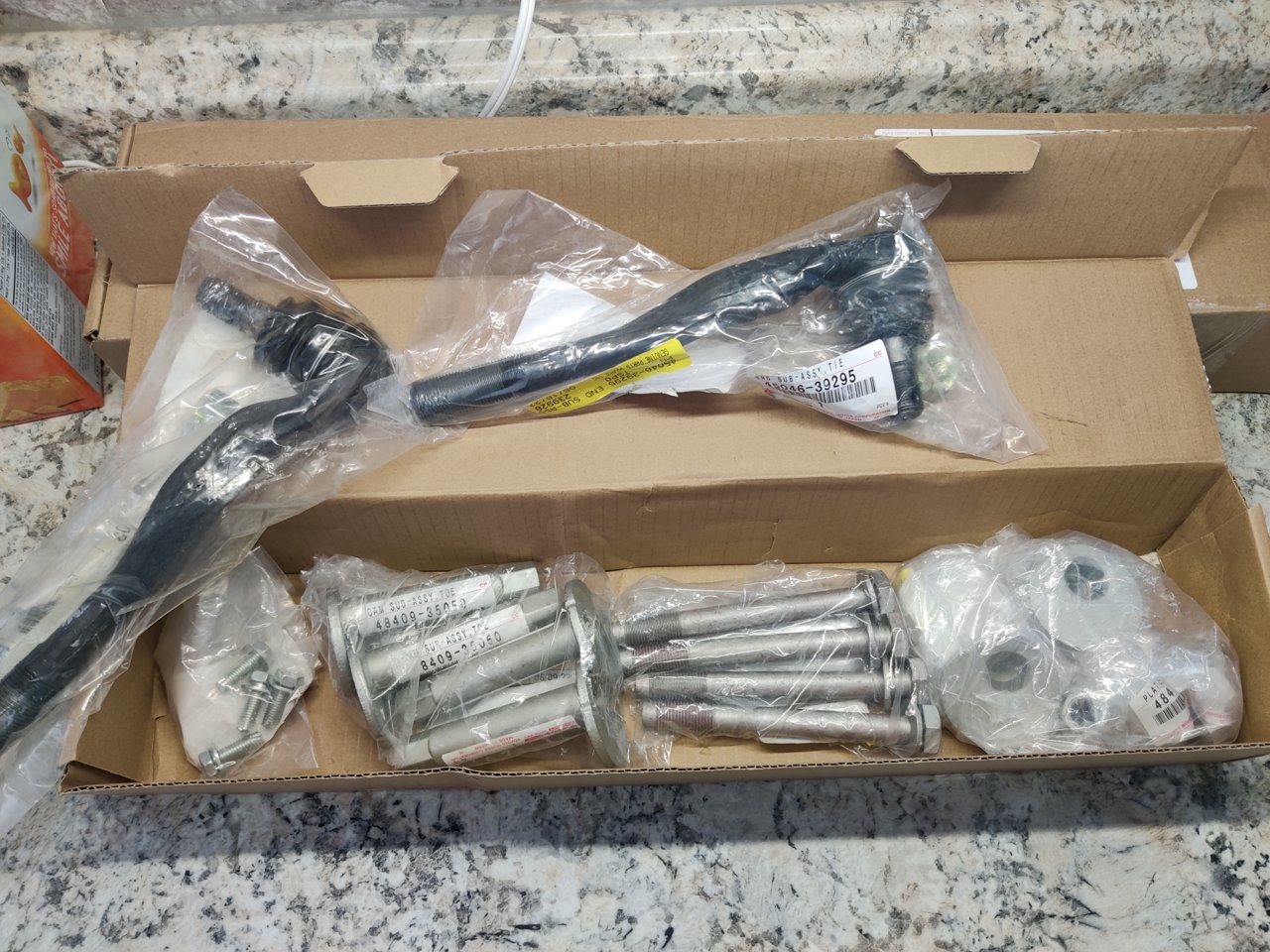

    Now that I have everything for the LCA's project that nagging voice in my head is telling me I should add wheel bearings to the list and finally burn on the Spindle gussets while I'm at it.
