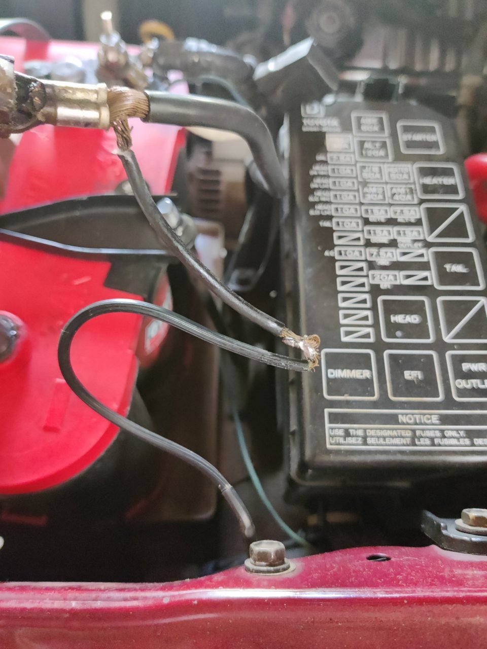

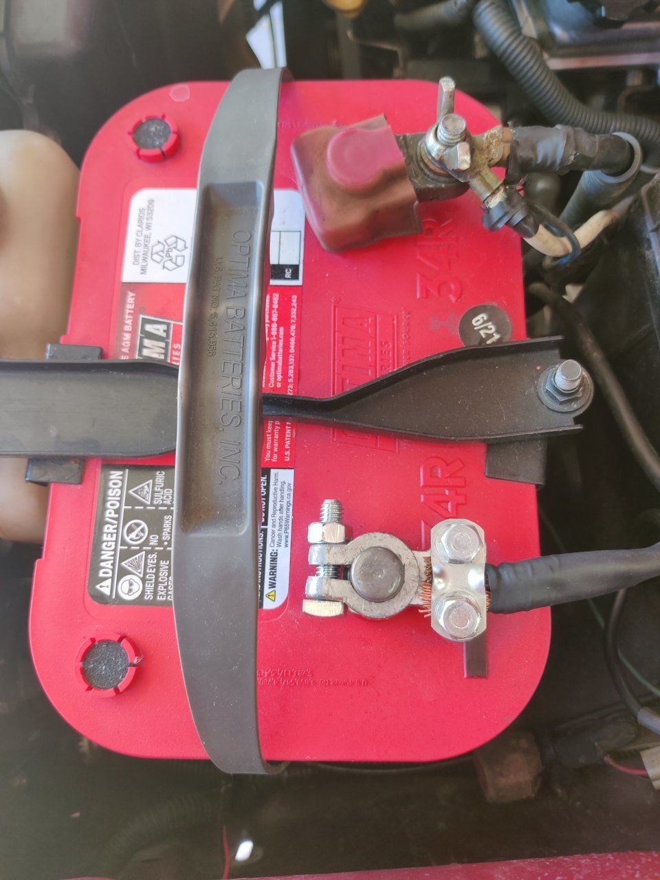

    Installed a new negative battery terminal and fender ground.
    I noticed some electrical tape in the middle of a fender ground a while back and removed it to see why it was there in the first place.
    :puke: at least they soldiered the connection.
    I'll address the positive terminal later so don't be all negative about how It looks

    How are you liking that red top battery? Been contemplating the red or yellow.

    It's been solid! I think there was a 24F type battery in there before that's slightly bigger but this smaller 34R has better specs in every way.
    If they had a yellow top available when i bought it I probably would have gone that route but I don't regret going with the Red top at all.

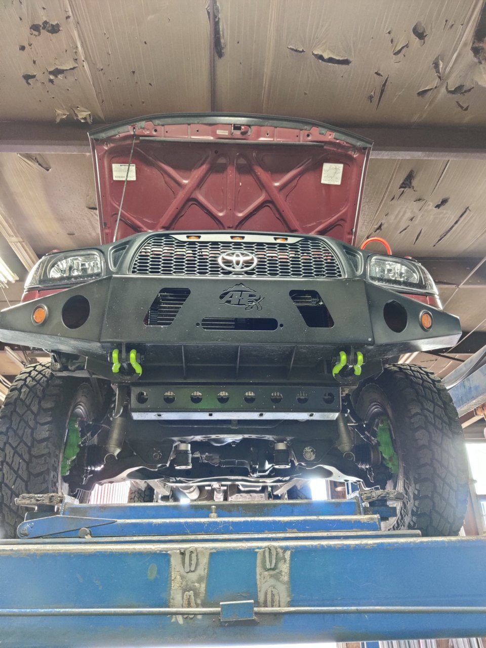

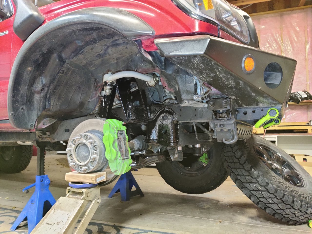

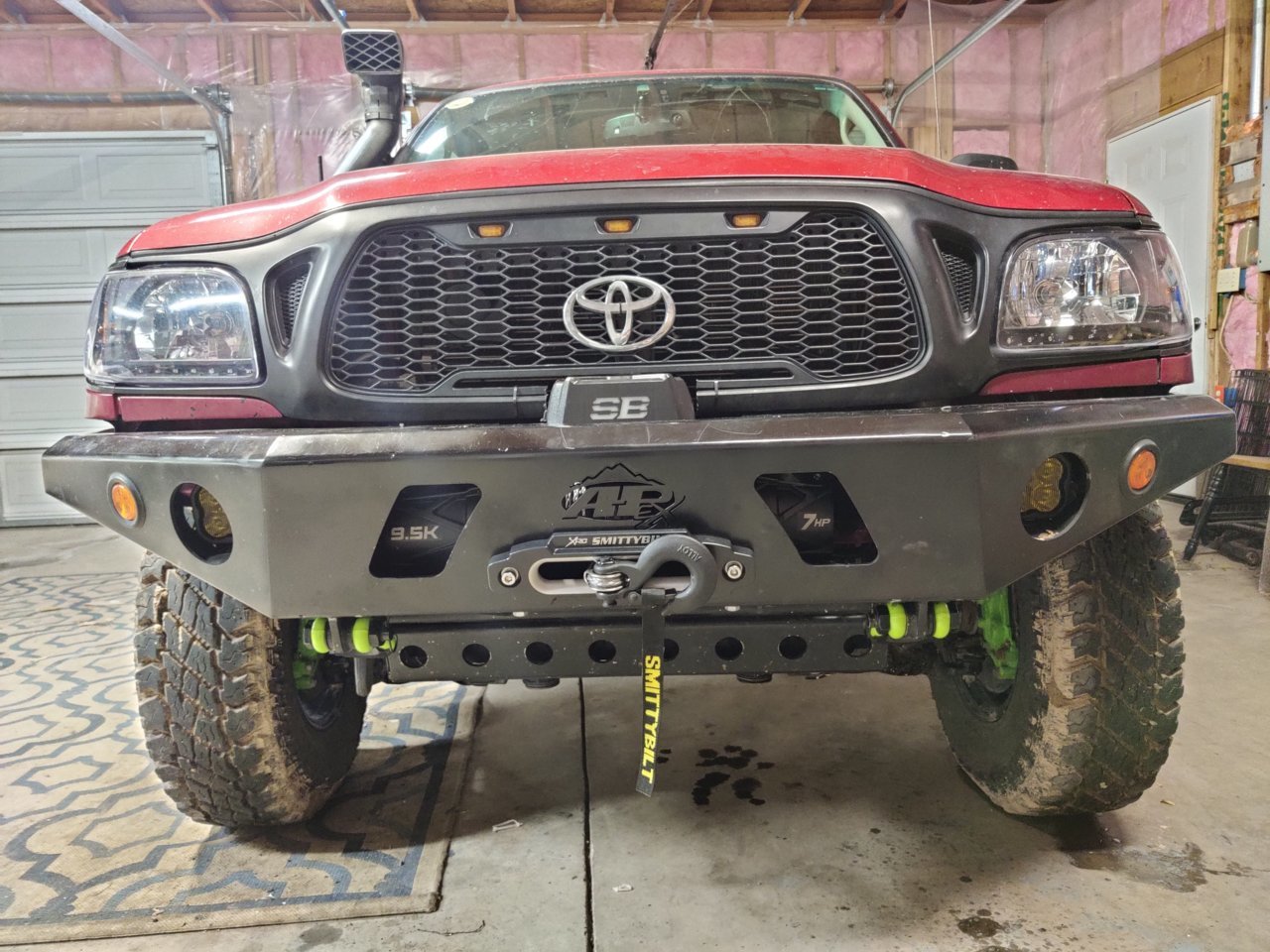

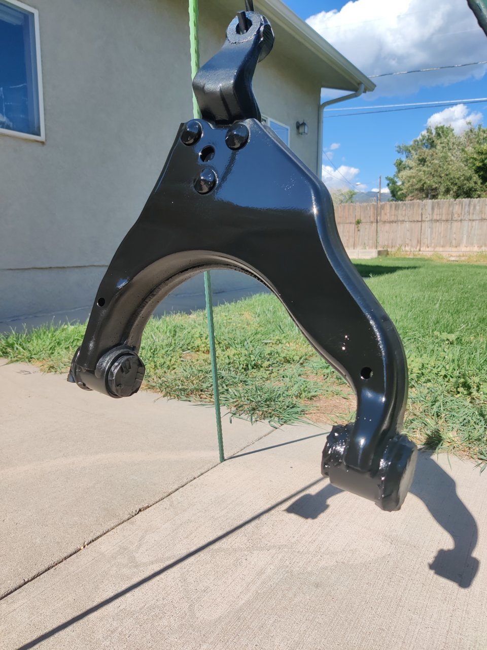

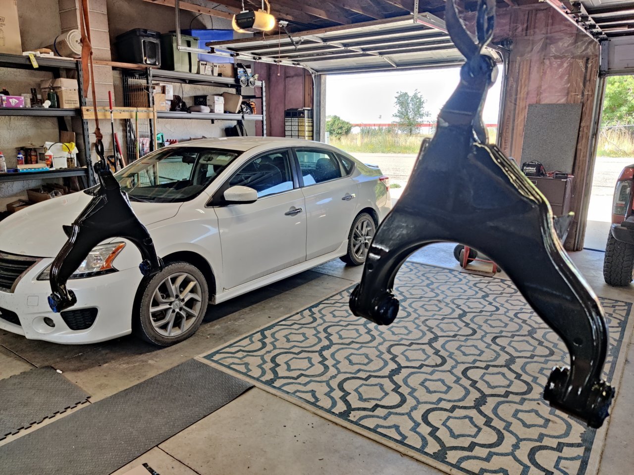

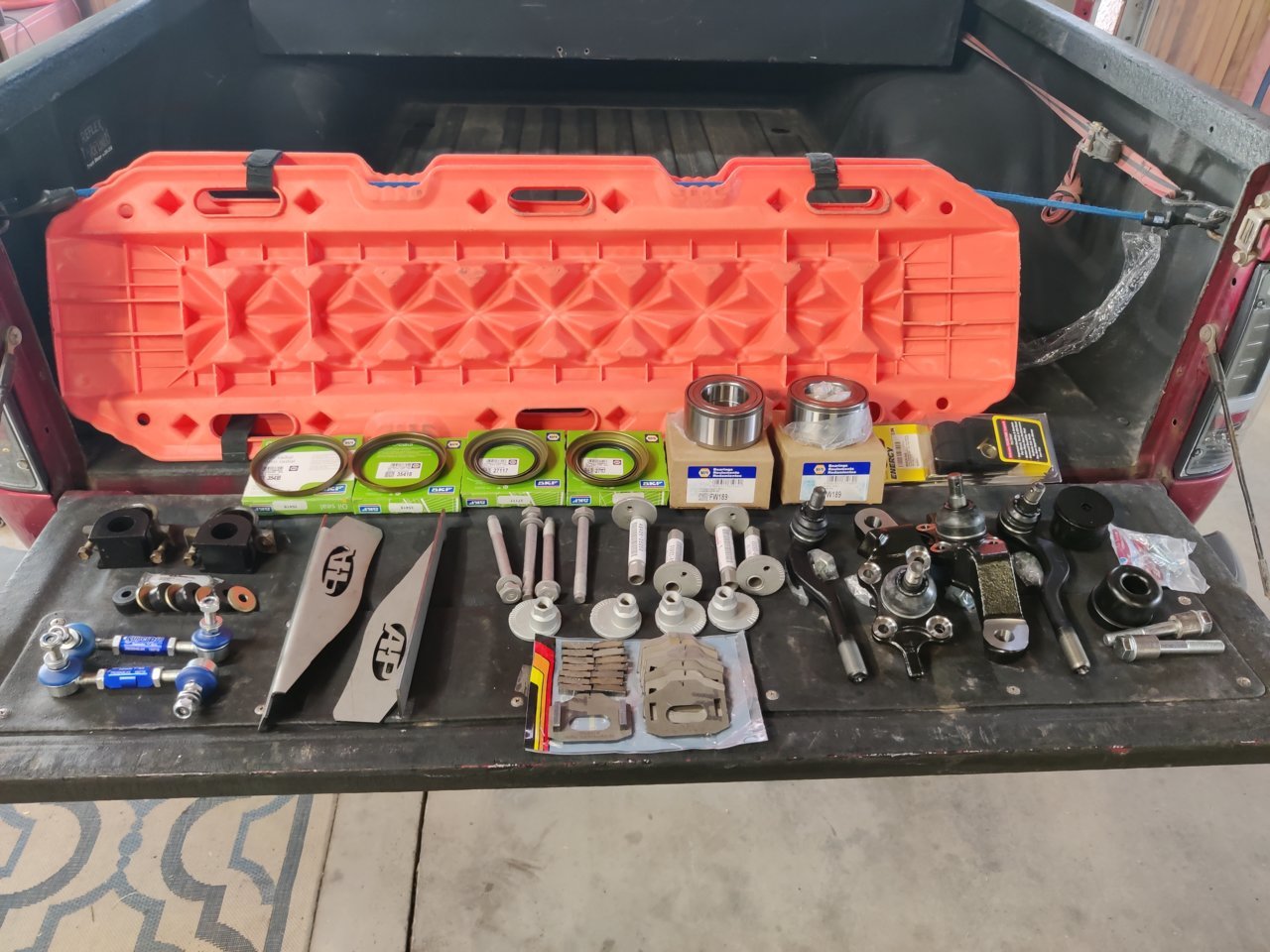

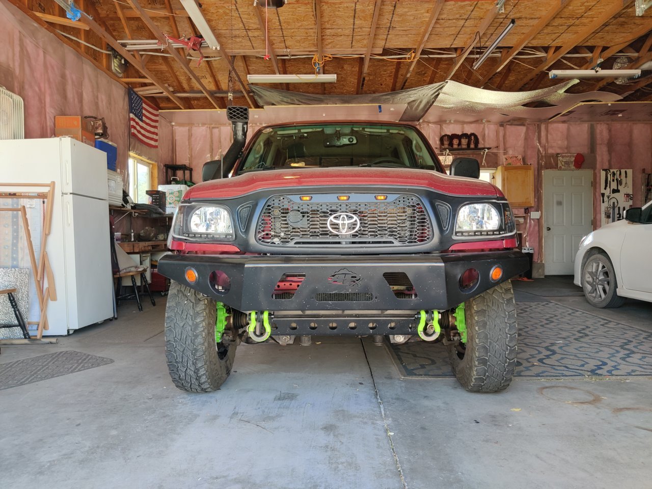

    I took a little time and cleaned up the replacement LCA's and added a couple coats of paint for good measure

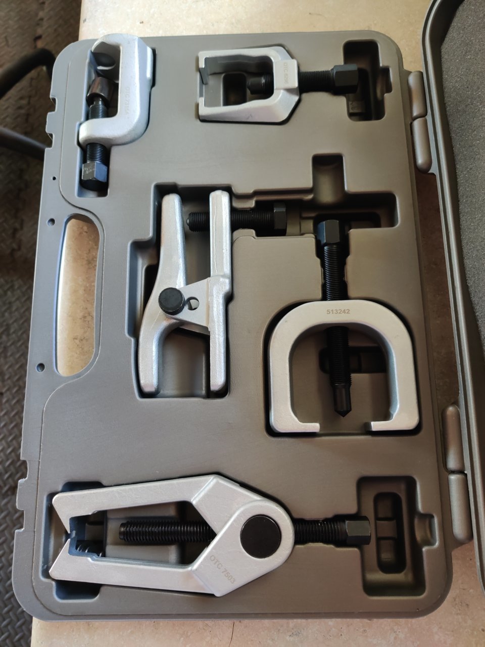

    The OTC Front end service kit showed up

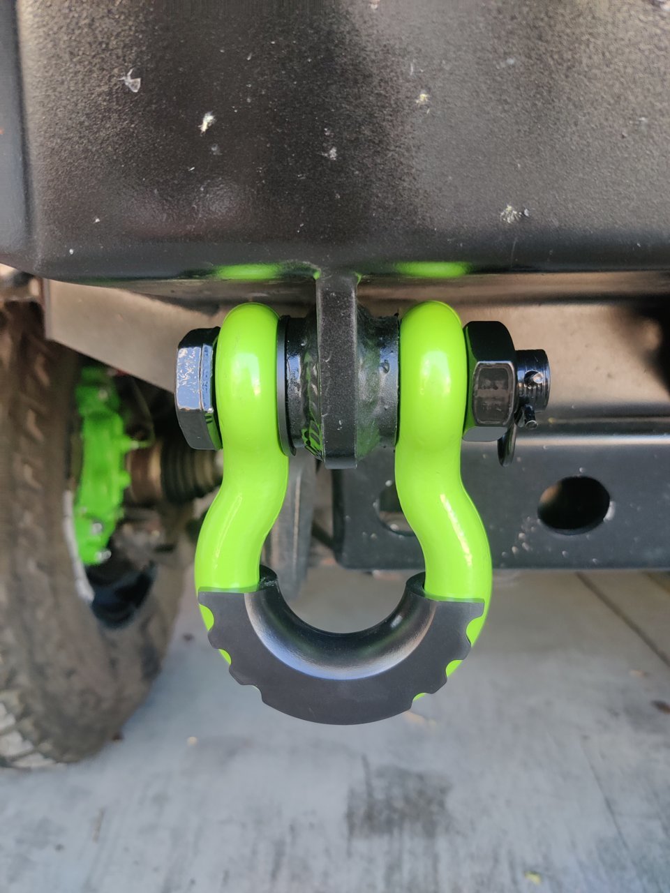

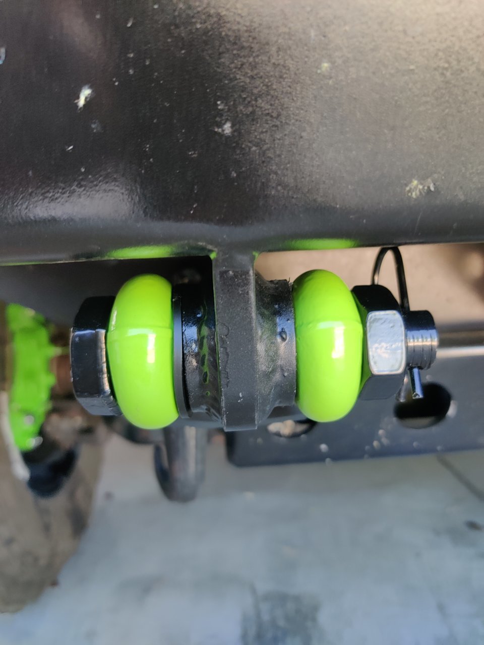

    I also got some new shackles for the front bumper. I wasn't sure if they would fit at first, these brackets for the shackles in the All-Pro Apex bumper are a bit fat and barely left room for one of the thin rubber washers on each shackle.
    Plus side to that is there's enough friction to hold the shackle tucked back under the bumper until needed.

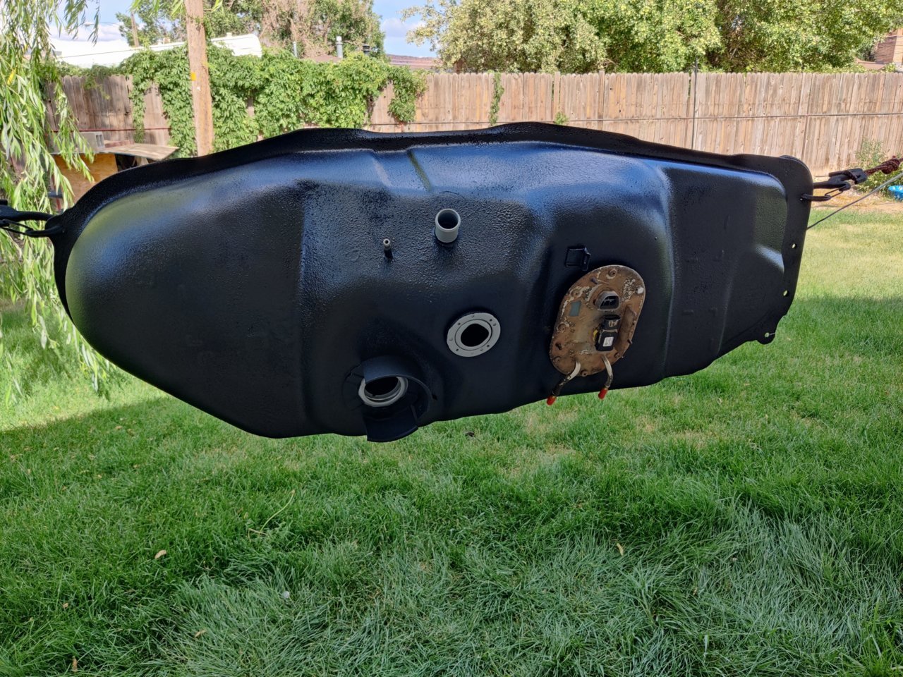

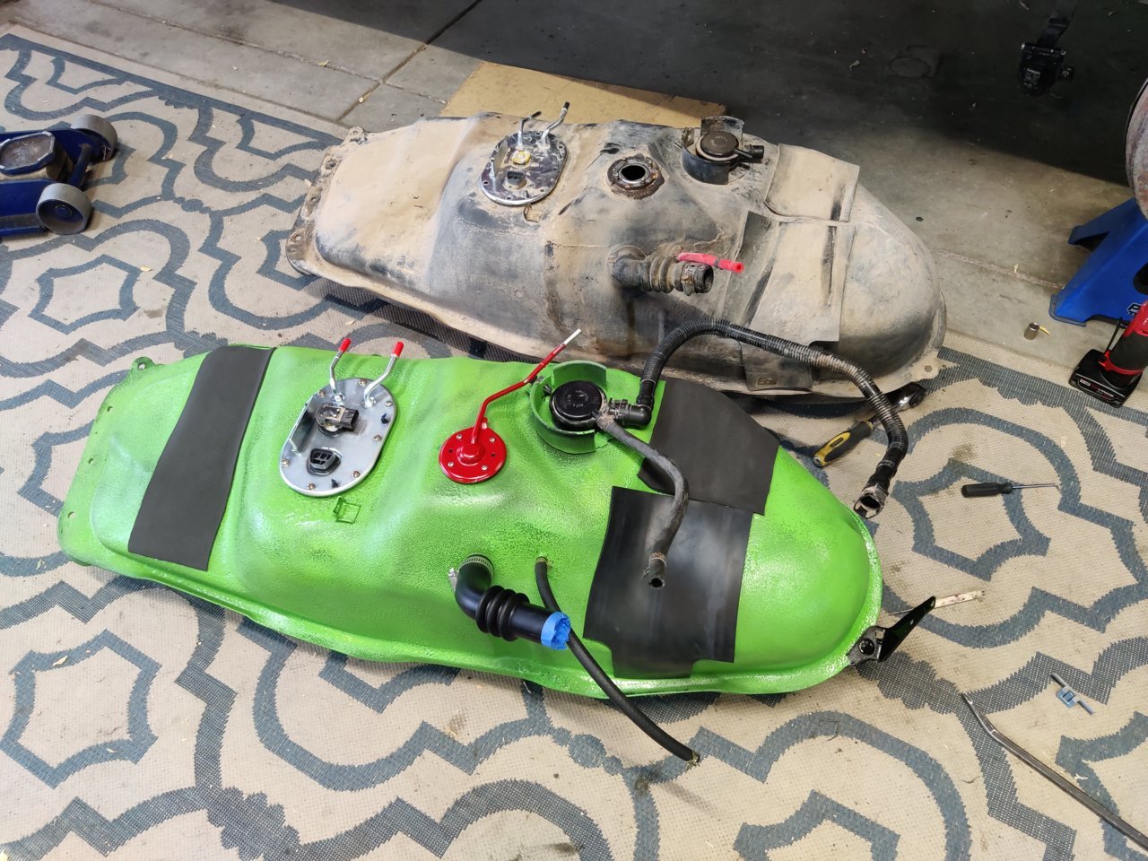

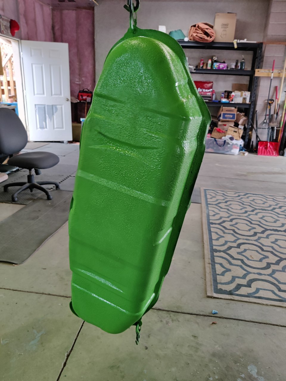

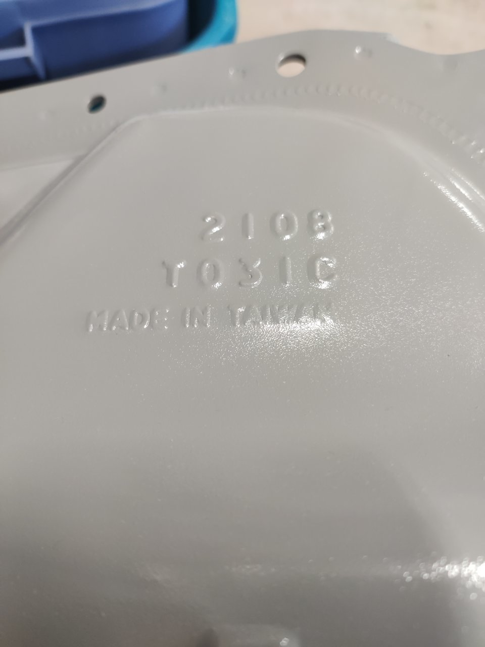

    No more dented fuel tank :thumbsup:
    Spectra Premium T031C 18.5 gal
    1 can of Raptor liner bed liner
    2 cans of Dupli-color bed liner
    1 can Raptor liner undercoating
    Can and a half of Dupli-color engine enamel
    Pickle Rick is that you?
    Gas prices these days feels like being smashed by Hulk penis
    All ready to go in with a new Delphi fuel hanger Assembly, all new seals with Permatex 85420 fuel resistant gasket dressing.
    Toyota only sells one of the gas tank cushions for the back of the tank and its the one that comes in directly contact with the frame cross member and I'm glad I bought that and recommend buying 2 of them.
    For the front of the tank I used a roll of adhesive backed neoprene cut to fit.
    Filled up the tank and so far so good.

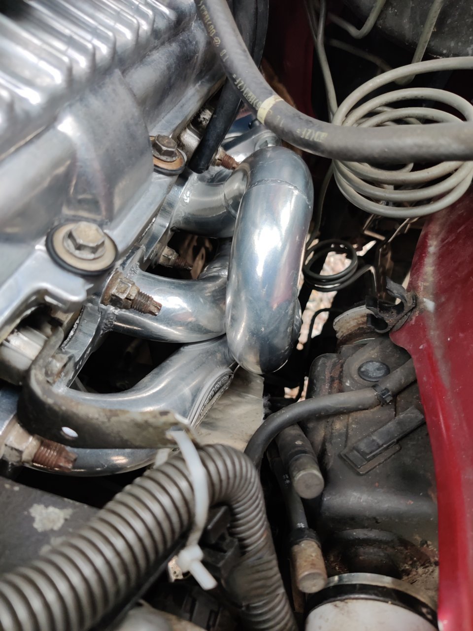

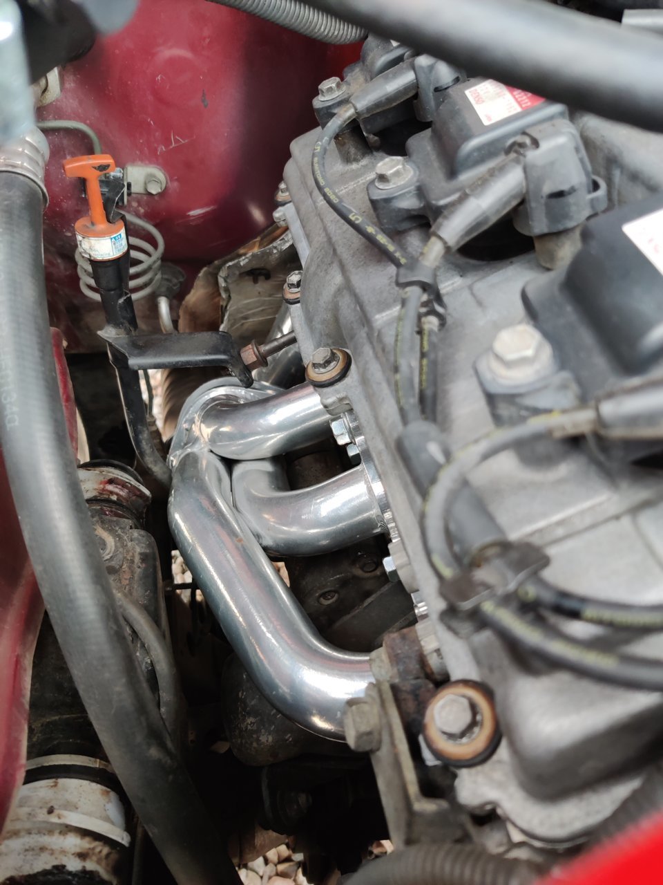

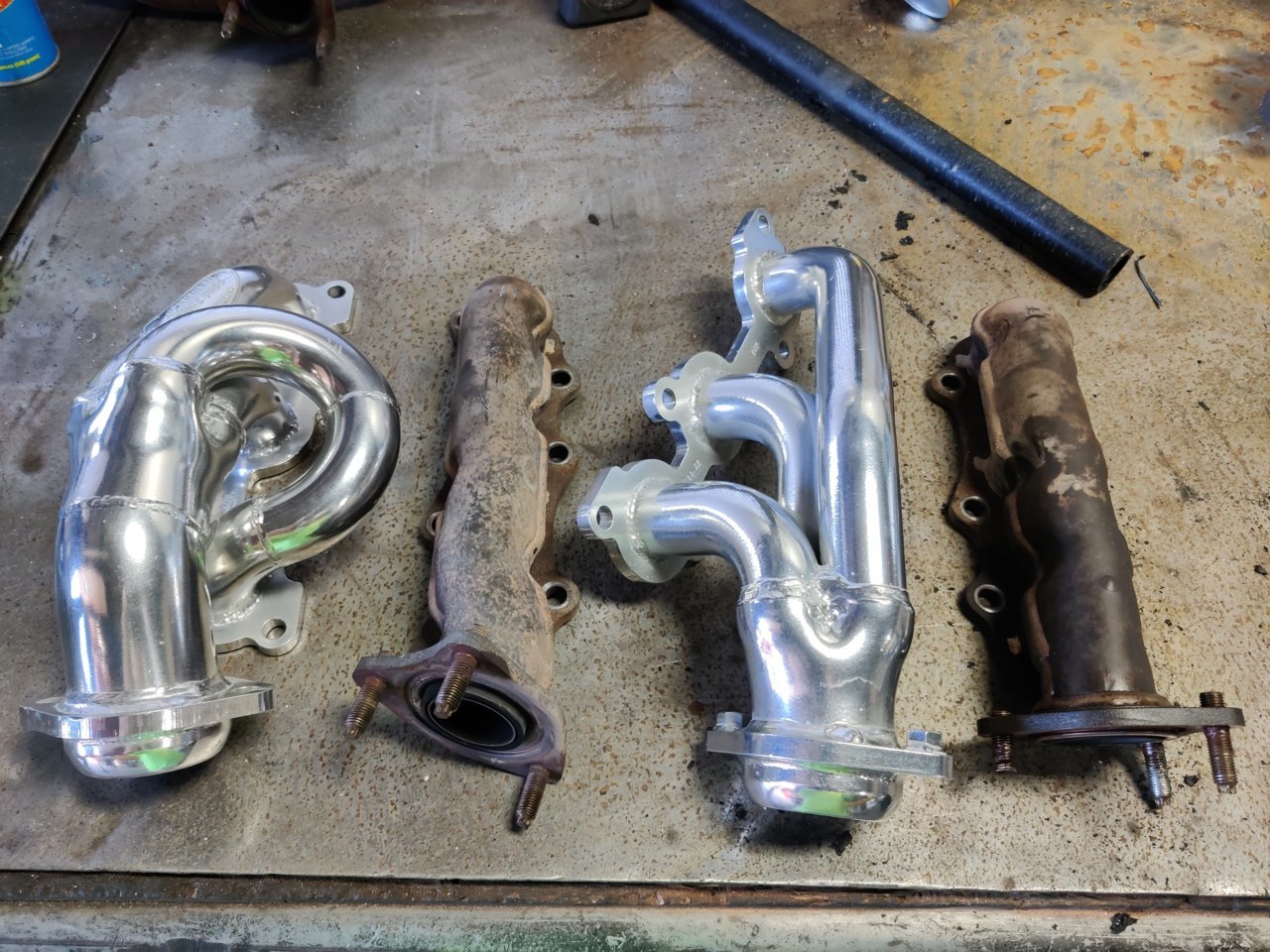

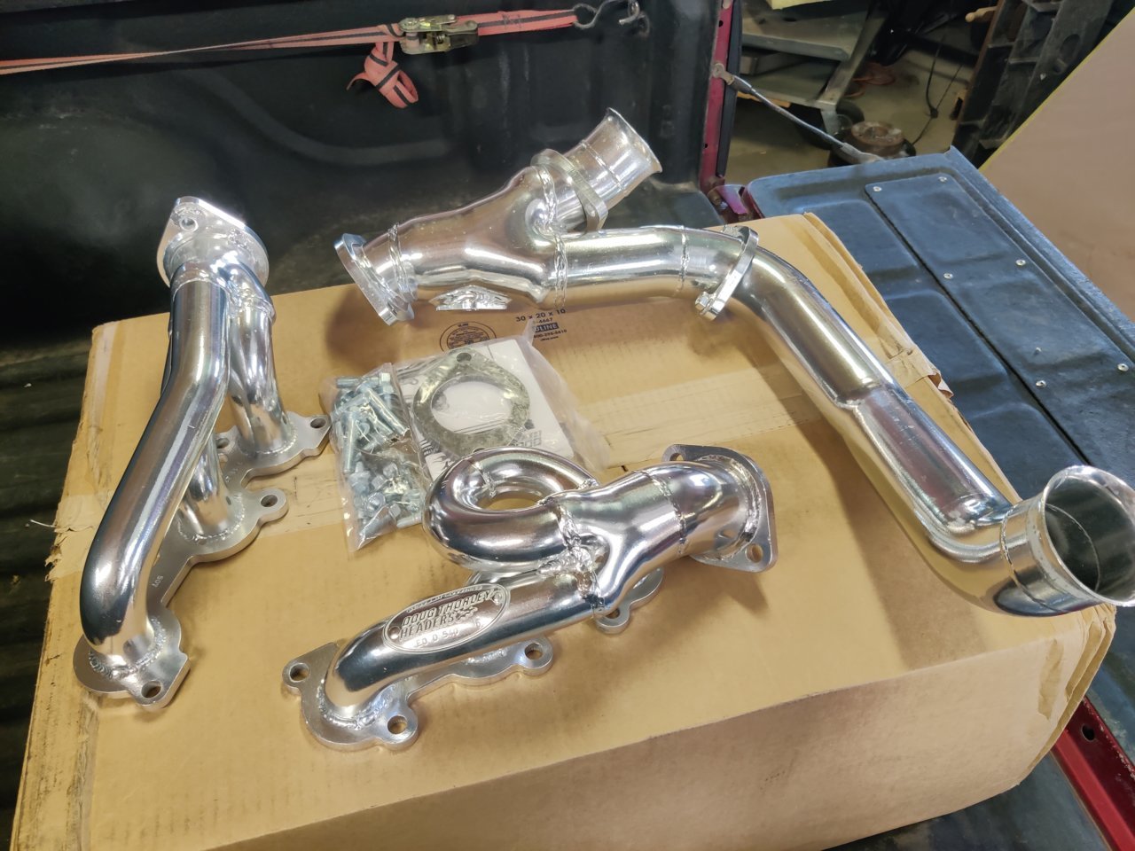

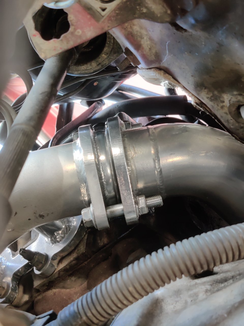

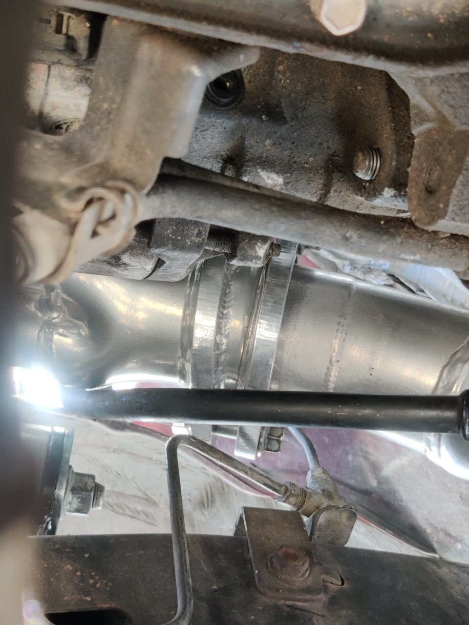

    Spent a full day in the shop with some high quality people
    Instructions went out the window on this one, we were able to get the entire job done without touching the motor mounts or the transmission but we did remove the brake booster.
    We cut the stock crossover pipe on the drivers side and pulled it out through the passenger side
    The drivers side header is very close to the front dif breathers so I have an extra reason to relocate them to a better place.
    The dipstick for the transmission needed to be mounted differently on the passenger side.

    Ball flanges
    Passenger side.
    the nut welded onto the stationary flange on the male side was welded off center enough that it was difficult to get the bolt started
    Drivers side.

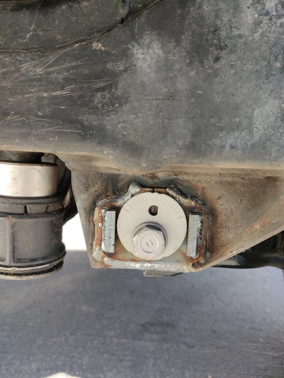

    Finally got the spindle gussets and alignment cam tabs welded up. It still needs a splash of paint and an alignment but time ran short
    MarX likes this.

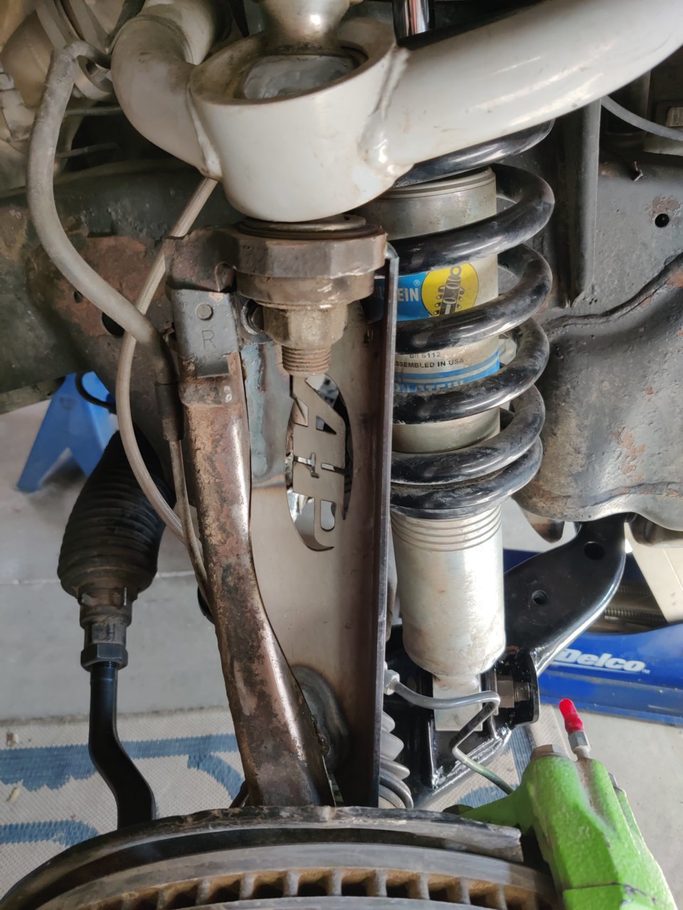

    Snagged a picture of the spindle gussets

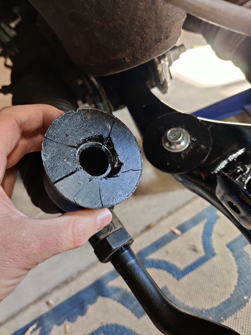

    I noticed a crack in the durobump stop and went to inspect it and the dang thing popped right off. I never even got a chance to use the. they've been on less than 15 miles so idk what happened

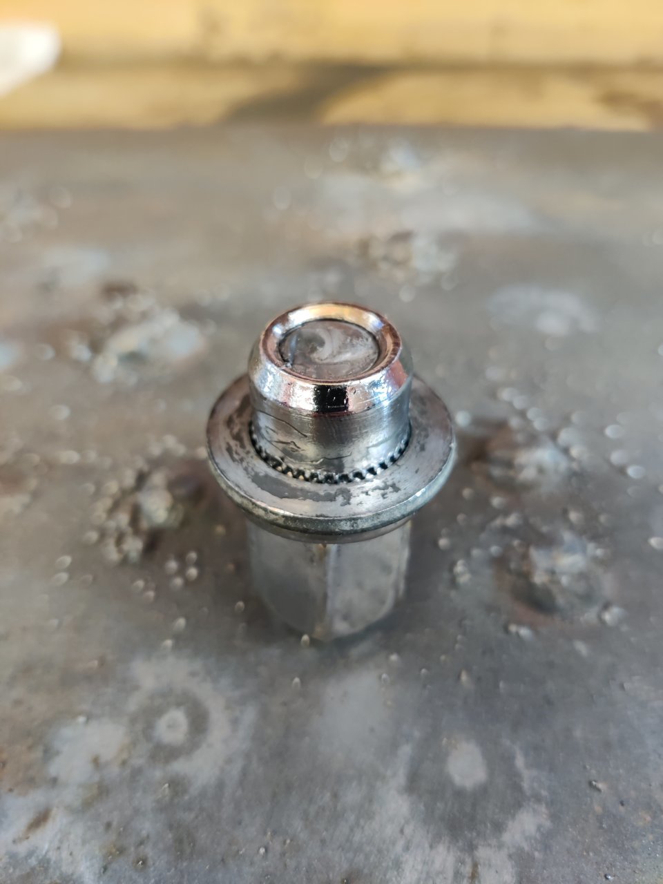

    Happy to report my tires are finally wearing evenly.

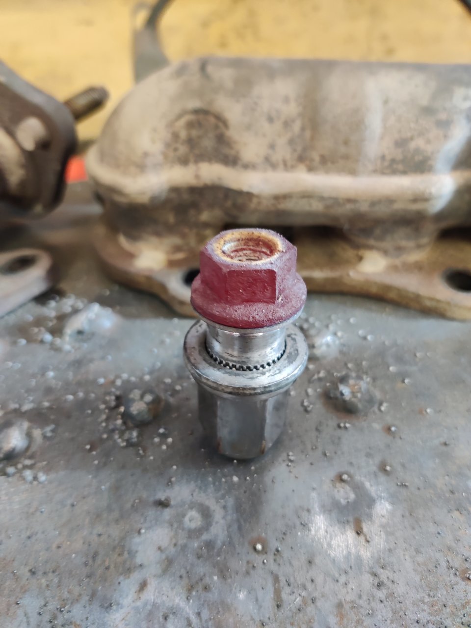

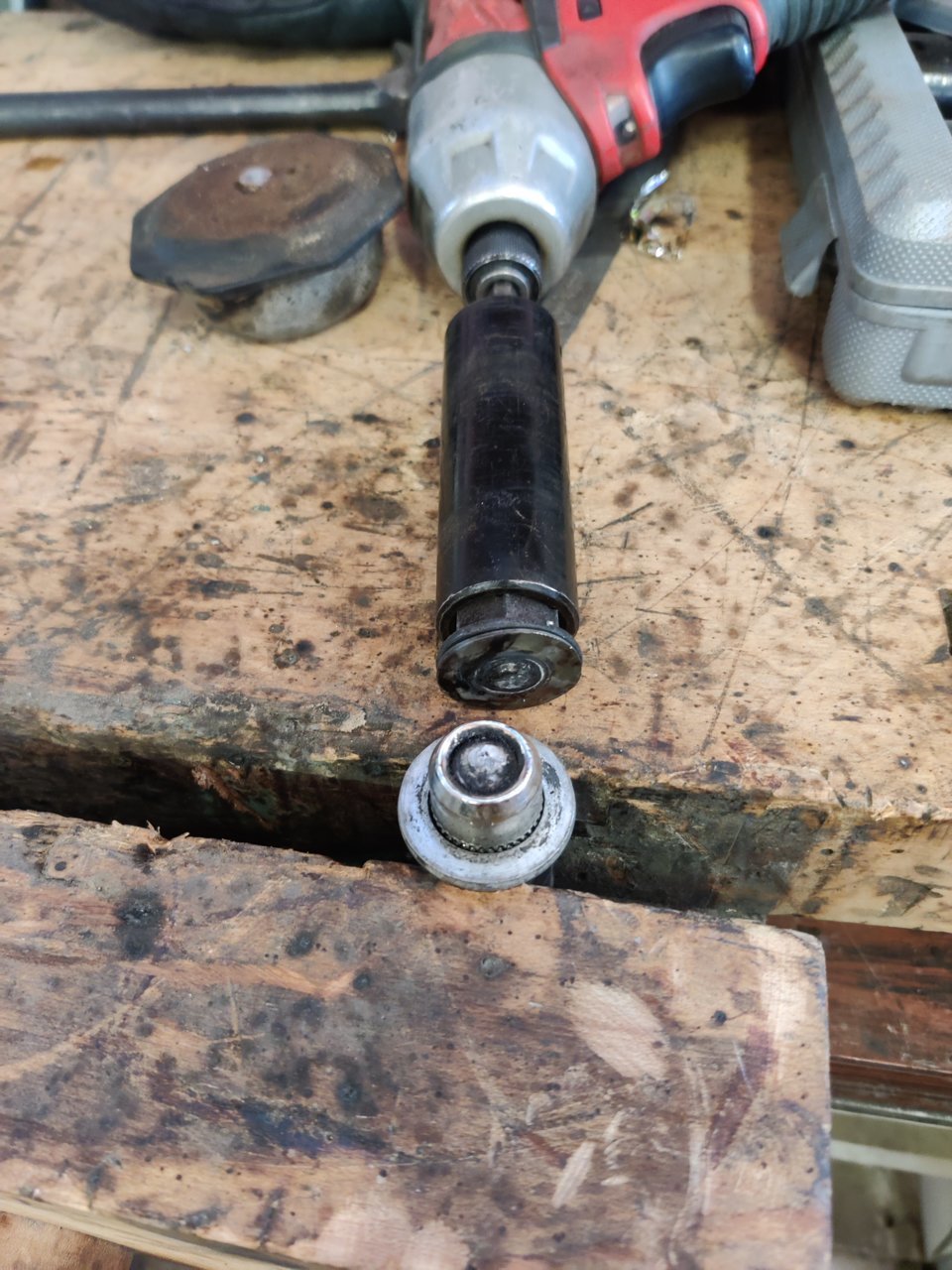

    I did have a lug stud snap at the shop while having the tires balanced (right after trying to tell the tech he was over tightening the lug nuts)
    Some people need to chill with the air impact guns.
    I played around for a minute to see if I could salvage the lug nut
    It started out promising
    :laser:
    Dont touch the glowing metal.
    Damn, but it was fun regardless

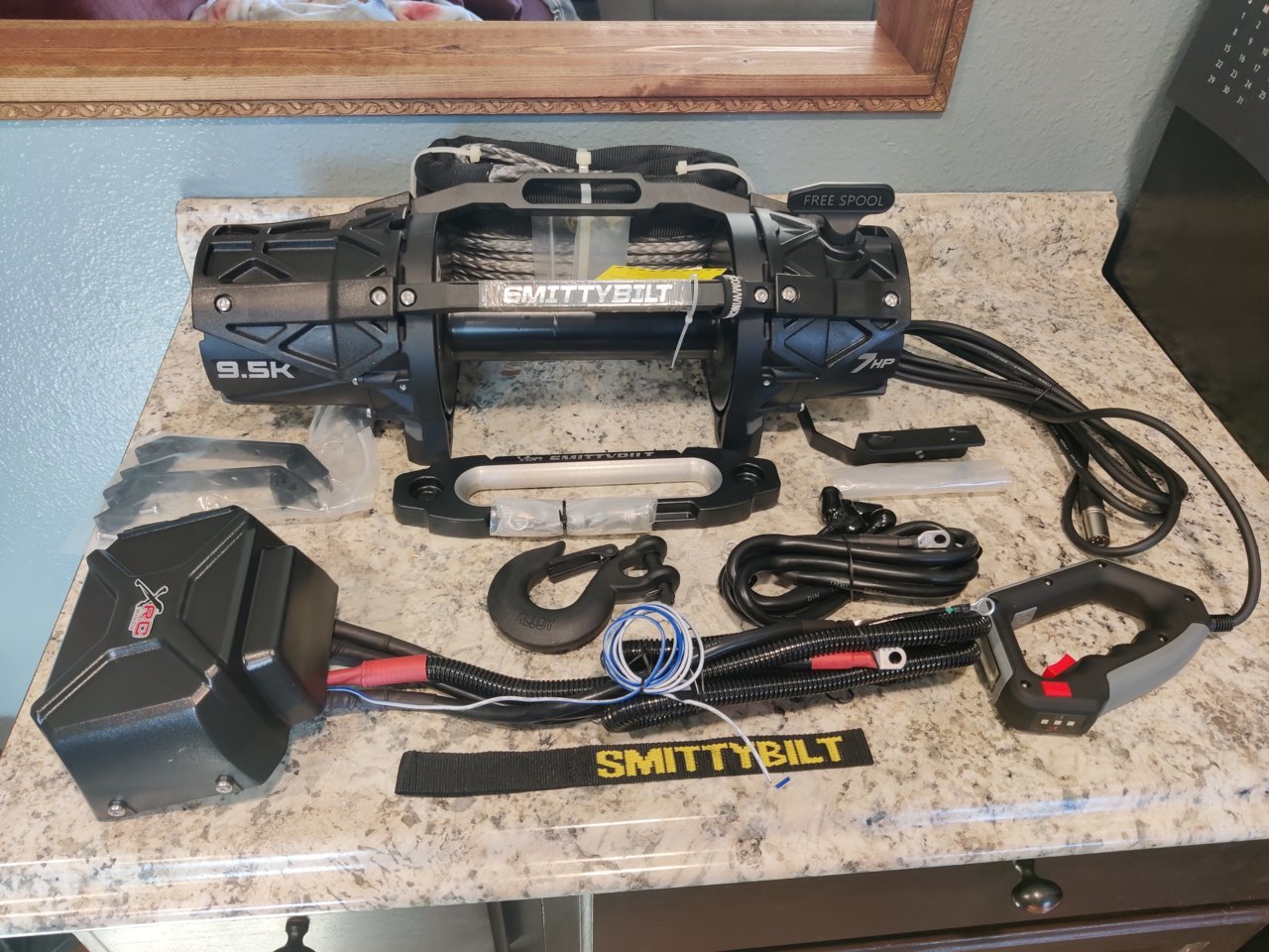

    An early birthday present came in the mail today
    Always frustrated when shipping is a little rough
    Luckily everything looks to be okay. I did find a small crack in the plastic cover above the 9.5k sticker but it's not enough to make me concerned. I did also notice the supplied negative cable looks like it was crushed in a couple spots but nothing serious.
