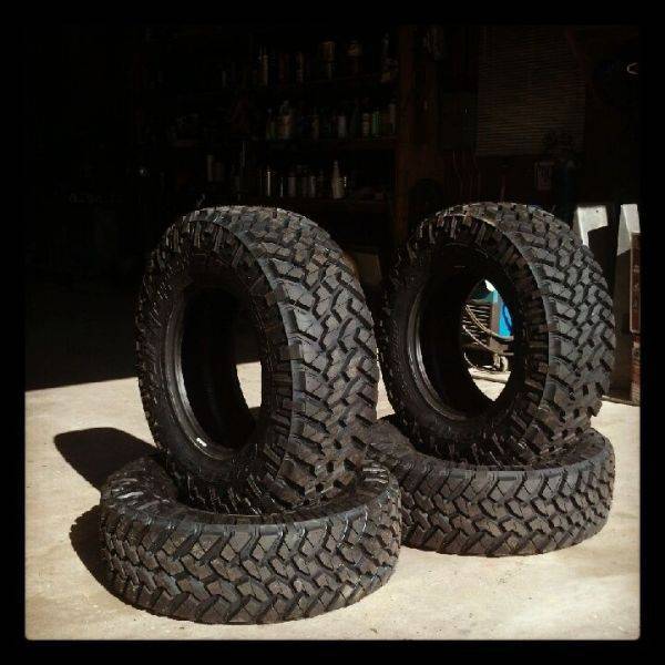

    Got my new tires in today :D

    Negitave, nitto trail grapplers :p

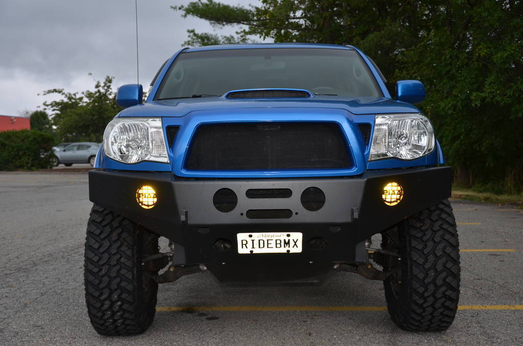

    Sick truck! What type of satoshi is that front grill?

    Thanks dude, its just a regualar full depth satoshi, I just color matched the inner half. :cool:

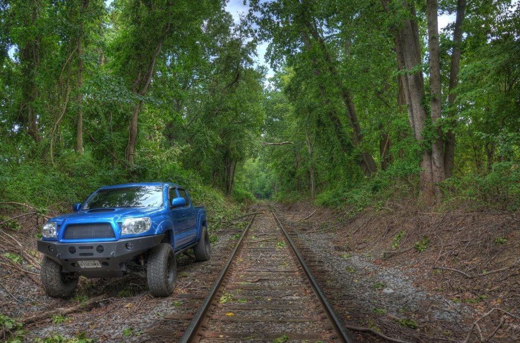

    Was out driving and came aross these railroad tracks, there were tooons of trees down so the train couldnt run, figured id shoot a photo while I was there. There were alot of tire poppers around the track so I stayed off to the side, not the angle i wanted but I like it.

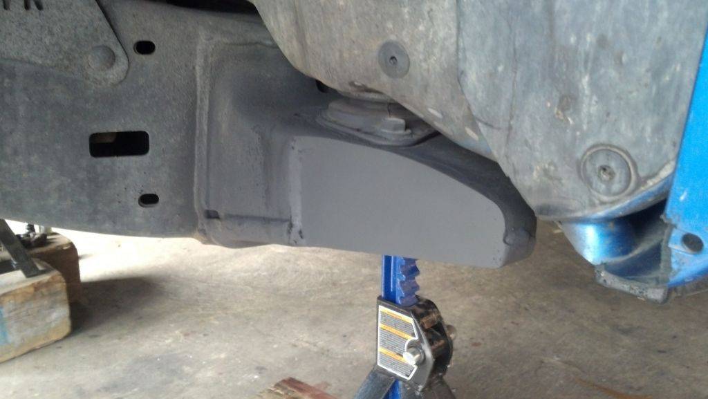

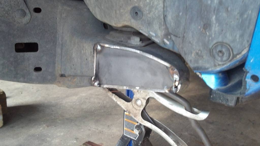

    Got a bit of a update to the build today :D

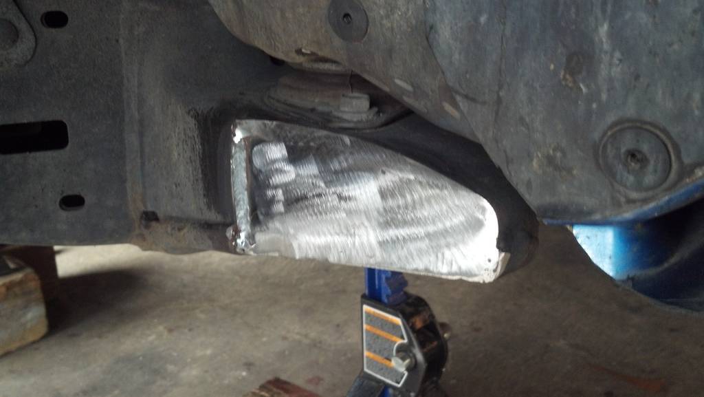

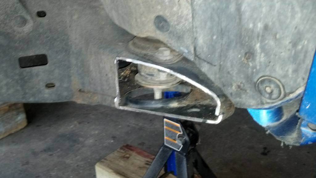

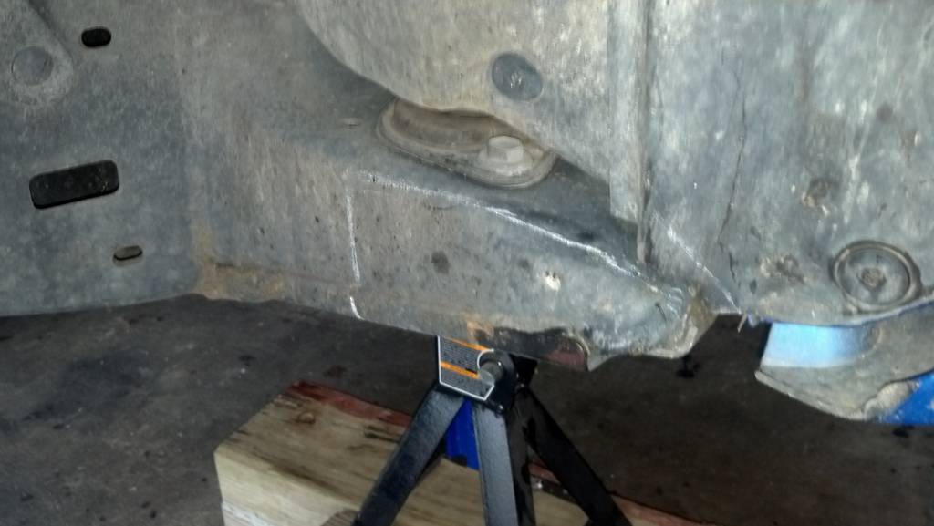

    Got my 285/70/17 trail grapplers put on, couldnt turn for shit without it rubbing the cab mount bad.. After a slow ride home, I pulled it in the garage and popped the front wheels back off and did the cab mount chop, came out looking pretty good and my tire clears it (I think it will still rub if I stuff the tire). Will do a little bit more trimming of the inner fender tomorrow.
    Onto the pics..
