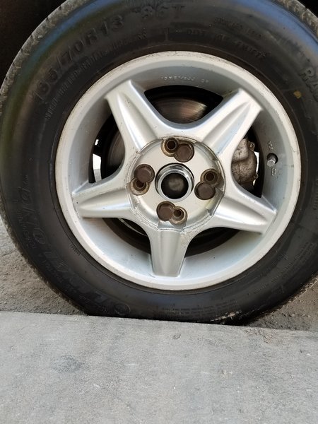

    Truth. And for any of the youngsters who have only driven since the 90's they would have to learn a new habit to start safely, since the interlock is the only thing they've known.
    Tough little Russian beasts. Still a lot of them running about in Cuba, because they are so easy to fix with bailing wire and duct tape.
    Here's one a friend owns with custom wheels modified to fit. Note the lug pattern. :D
