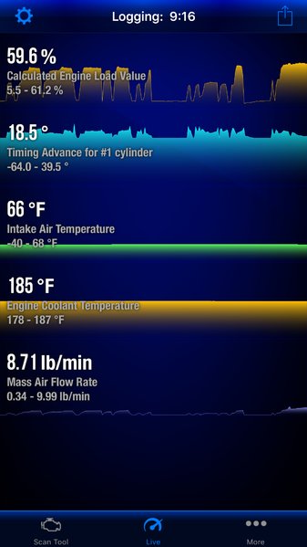

    I have some live data that I got using a bluetooth Lemur reader. I am trying to find out why my system is always running lean bank 1. Here is some info i can give. This is at wide open throttle. If you really need to know the after market parts i can list but it is a lot.

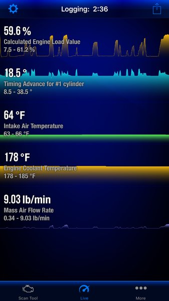

    This was another run also btw

    I'm not sure if this will help you, but it seems to me that your timing advance seems low. I'm assuming this relates to ignition timing, and that you have a distributor (mine does not).
    My 3RZ, with automatic, runs perfectly. I checked my ignition timing, using my Ultragauge, just to have a baseline for the future, and these are my readings ( all at steady throttle, not wide open ) :
    Idling in neutral: 7-9
    Idling in Drive: 12-15
    20mph: 32
    40mph: 35
