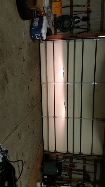

    I took a few befor pics of the lights Pattern. And now I have the truck parked and the light pattern marked out

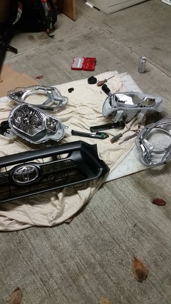

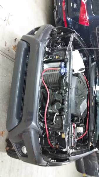

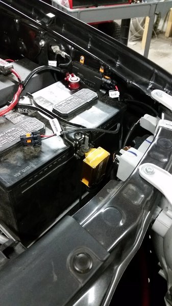

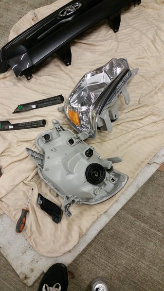

    so finally got the wiring harness in and here is matt. Starting to take apart the grill and bumper.

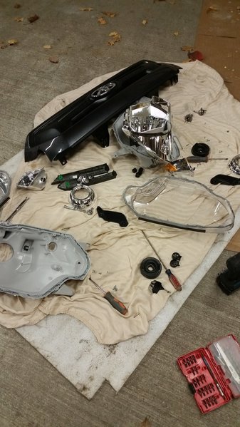

    Finally got it all apart. Yes I have airhorns. Last screw in the wheel well is a pita.

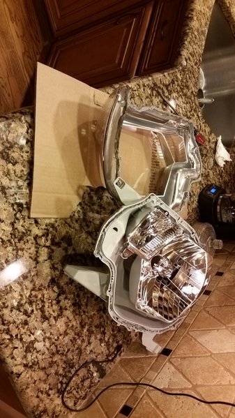

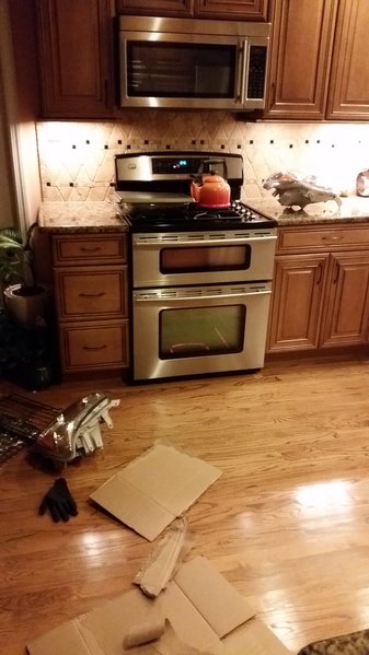

    Now is almost time to bake. Remove all screws and rubber boots. Anything you can take off the headlight. Any suggestions on temp and time?

    I think I did 350 for like 7 minutes? Honestly can't remember. I used a heat gun the times after that and it was much easier.

    By the way be careful when prying off. If the plastic housing gets too hot it will crack easy and you can break off a chunk of it like I did. I got it back on and sealed it good but still best to avoid it

    So I think I'll try 300 for 10 and see how it goes. Time to preheat. Then throwing it jn there on some cardboard. So i don't melt the housing

    300 for 5 min worked great. Cardboard started to smoke.

    So 4 to 5 min at 300 preheated. Worked great. Carefully for the clips

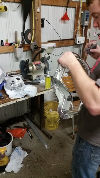

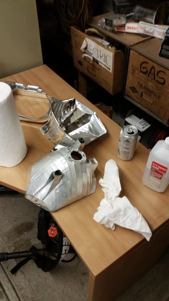

    Now carefully take screws out and remove all chrome. To be painted. Reflector also needs to be ground down

    3 inch bilstein lift. 4runner brake upgrade. offroad bumper. full on board air and electronics
    Grinding the back and scuffing the housing. Alcohol whip is next.

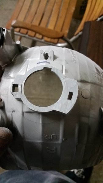

    Grind the back flat. For the lock nut

    Washed in the sink to get all dust off. Now for a much better alcohol. Cleaning. Then ready for paint. The reflector and trim are getting satin black. And the blinker and orange reflector are getting tinted with lens tint
