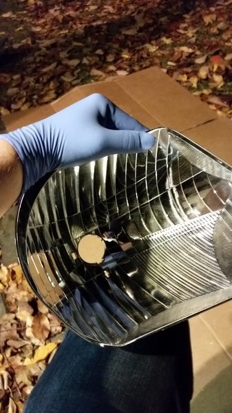

    Use gloves to avoid getting finger prints aND oil on the reflectors

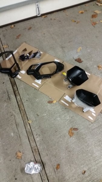

    Got the paint on. Woot. FYI be very careful with alcohol on the shroud. The alcohol ripped the chrome right on

    adding a shield didn't work out. So i painted all the foreground.
    Note I used spray paint on a Q tip to apply the paint. Because the d2s 3.0 are riveted together. When applying paint. Avoid the pivot point on the cut off. Avoid the solinoid components. And try not to get it on the top edge of the cut off. Otherwise it may affect the color flicker.

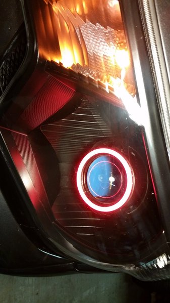

    Unfortunatly when I aimed them I didn't quite have the headlight sitting properly so the passage side it a little slanted but not to bad. The color flicker looks awesome. And the halos look mean. However the halos seem to be a little off with the colors. One doesn't seem to be putting out quite as much red. So when you have a mixed color like purple. One looks a little more blue. Because it's lacking the red.
    Also other them the fact it is crooked. My original alignment was not even passage was higher than the driver side. So now the one cutoff is high then the other. Should they be even. And this is not to much worry as you can still use the factory light adjustment to adjust up/down left/right.

    Picture time. Halos loom great. best decision ever. Other then the slight color difference

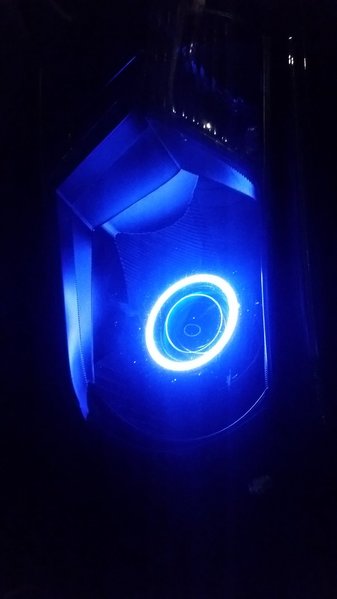

    Sexy halo and passive eyes.

    Reflector is tinted sexy
