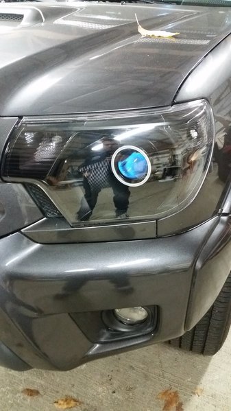

    But with the tint is still reflects nicely

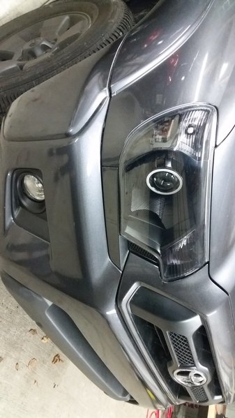

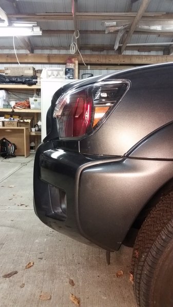

    Looks beautiful. Sorry for the pictures the rotate sensor on my phone broke. Screen won't rotate

    Passive eyes

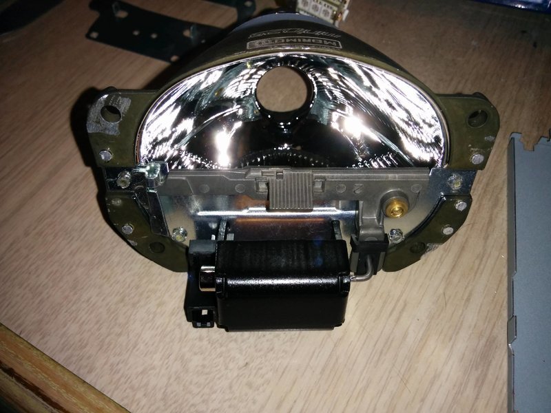

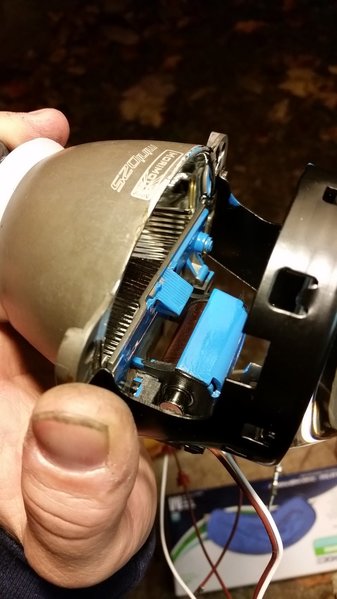

    https://www.theretrofitsource.com/morimoto-h4-motocontrol-bi-xenon-wire-harness.html#.V4wo4cspDqA
    Yes there still is high beam. And the high beam is amazing. It's so bright and it has distance to it.
    Only difference is stock bulb high beam has a second filament. It the projector. There is a cut off line. And when you click highbeam the cut off on the projector gets pulled away. So the bulb stays the same. But the cut off is moved. And i was surprised how bright everything got. My highbeam are brighter and shoot farther than my lightbar

    Here all the parts painted blue are the cut off for highbeam
