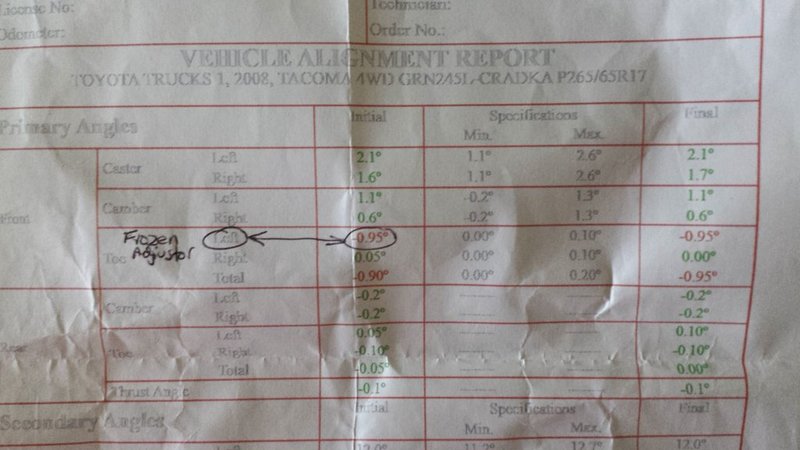

    I went today to get tires mounted and an alignment. And of courseThe drivers side alignment arm nuts were seized. So they couldn't get the toe in spec. I'll post pics of alignment sheet when I get home. Tires balanced up nicely. Hankook dynapro atm's 255 75 17 and they look great. So I'll be soaking that alignment arm for a few days and see if I can break it loose. The alignment shop tried heat with no success. And if I get loose they will finish alignment for free. Any suggestions other than pb blaster and wd40?

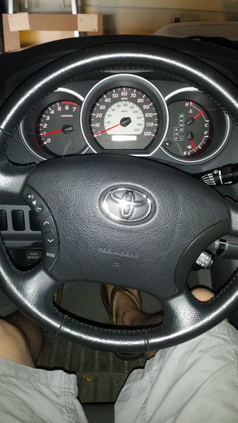

    Here my spec sheet. Any suggestions to have them change anything other than the toe thatis being caused by mot being able to adjust siezed adjusting arm?
    Also would the toe being off cause my steering wheel to be off center like this when I'm driving straight ? How can they fix that?
    Thanks
