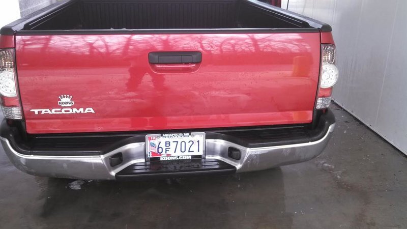

    13APR2014
    Debadged the back a bit, need to get rid of the rest still

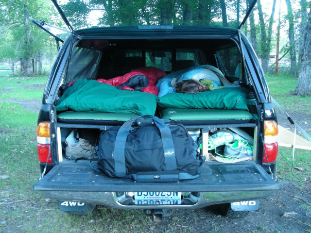

    Yeah, yeah, it's a first gen, but here's my low-key sleeping setup in use:

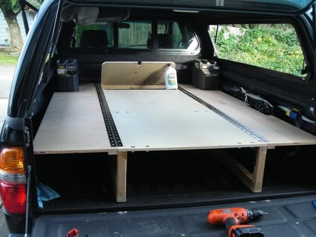

    And during construction:
    Sides fold up for easy access through side windoors and also for bike storage. They rest on the wheel wells when down. There's a storage cubby all the way forward for lesser used stuff. I made curtains and screens for the side windows that velcro to the carpet on the shell. Back window curtain is held on by snaps. Nothing for the front, but you can't really see in when the other curtains are up. There's not a whole lot of room for getting dressed but it's doable. Works just fine for sleeping, but I wouldn't want to try to spend a couple of days weatherbound in there.

    Sounds like an awesome trip either way. Have you decided how you're setting up the back yet? I feel like I'd rather a hard shell than an RTT if I'm going up higher on the New England coast.
    Sweet setup! Clearly works well enough for what you need. I'm thinking of building up the sides a bit more and having that center part be able to drop down to work on that dressing area issue and so I hopefully don't hit my head as much. I'm going to bring a tarp that I set up off the back so we can hang outside a bit too and live a bit more comfortably in weatherbound weeks. Thanks for sharing that though, definitely giving me more ideas.

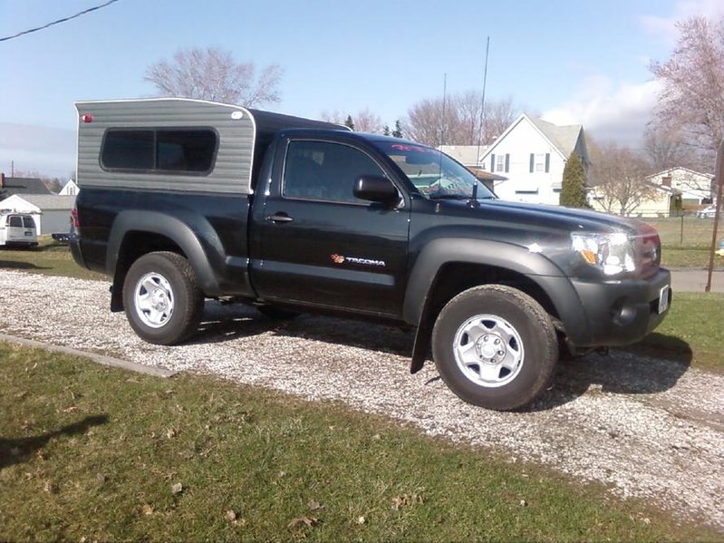

    IMO any 6' small truck cap will work then modify the shit out of it.

    Here is a wood frame and vinyl sided cap I maybe should have kept.
