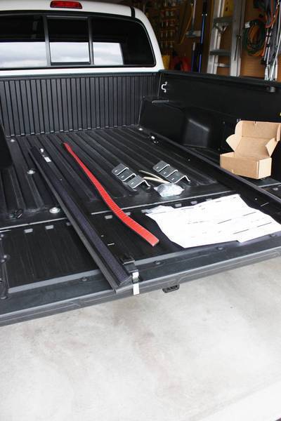

    The parts, excluding the actual cover:

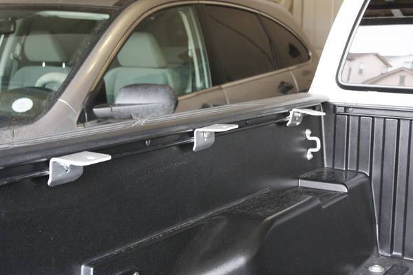

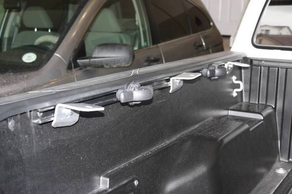

    Remove the cargo rail end plugs and the tie down cleats. Slide the brackets, three per side, into the cargo rail:
    Put the tie downs back on, between the brackets. They go in the cut outs in the rails:

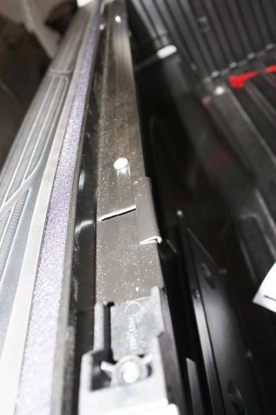

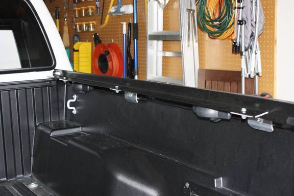

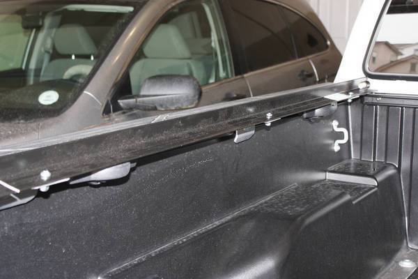

    Attach the rails to the brackets, leave loose for now:
    After make sure the rails are evenly positioned, tighten everything down, both sides:

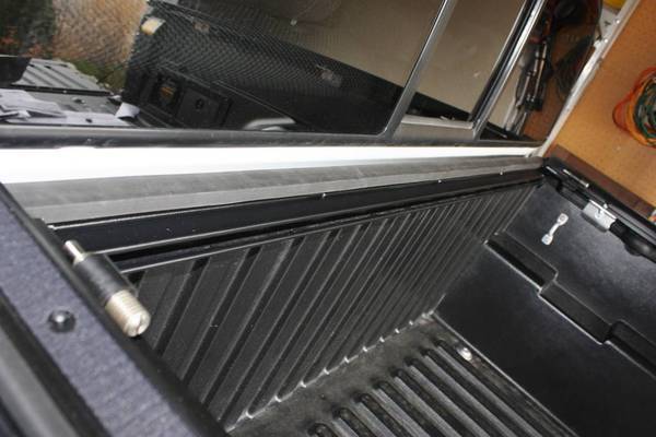

    Install the weather stripping at the bulk head:

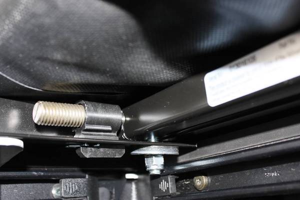

    Attached the header & cover to the rails at the bulk head, do not tighten, leaving some play in header. Here's the other issue. Nowhere in the instructions does it say to make sure the straps hang down. Make sure they are accessible so you can secure the cover when rolled up:

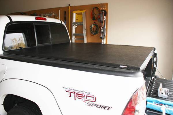

    Looks good. Would be better if it closed tighter around the tail gate. I will have to play with it a bit to see it I can get a better seal. Happy with it for now.

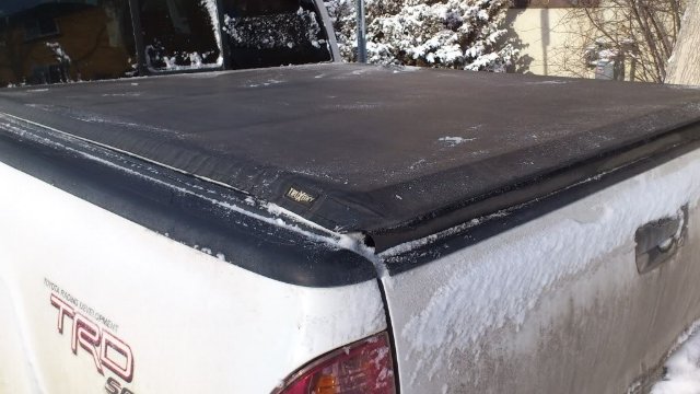

    This is how mine looked liked around the tailgate.
    d8b21248-ab1f-457e-bcde-50bd8e650d0e_zps_7b653b391d7ce589bde979ade1580e31f7576f24.jpg
