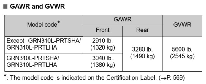

    #33528
    451
    Here are the 3rd gen Tacoma axle ratings. The slightly higher front axle rating is for DCLB.

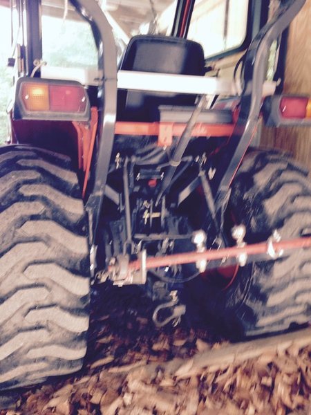

    A tractor would be ideal for that work. I maneuver loads like this and greater around with just a 35 hp tractor. It's nothing for them and they are much easier on the ground.if the spots are tight, I put a receiver hitch on the bucket and push it ahead of me. You can turn on a dime.image.jpg
