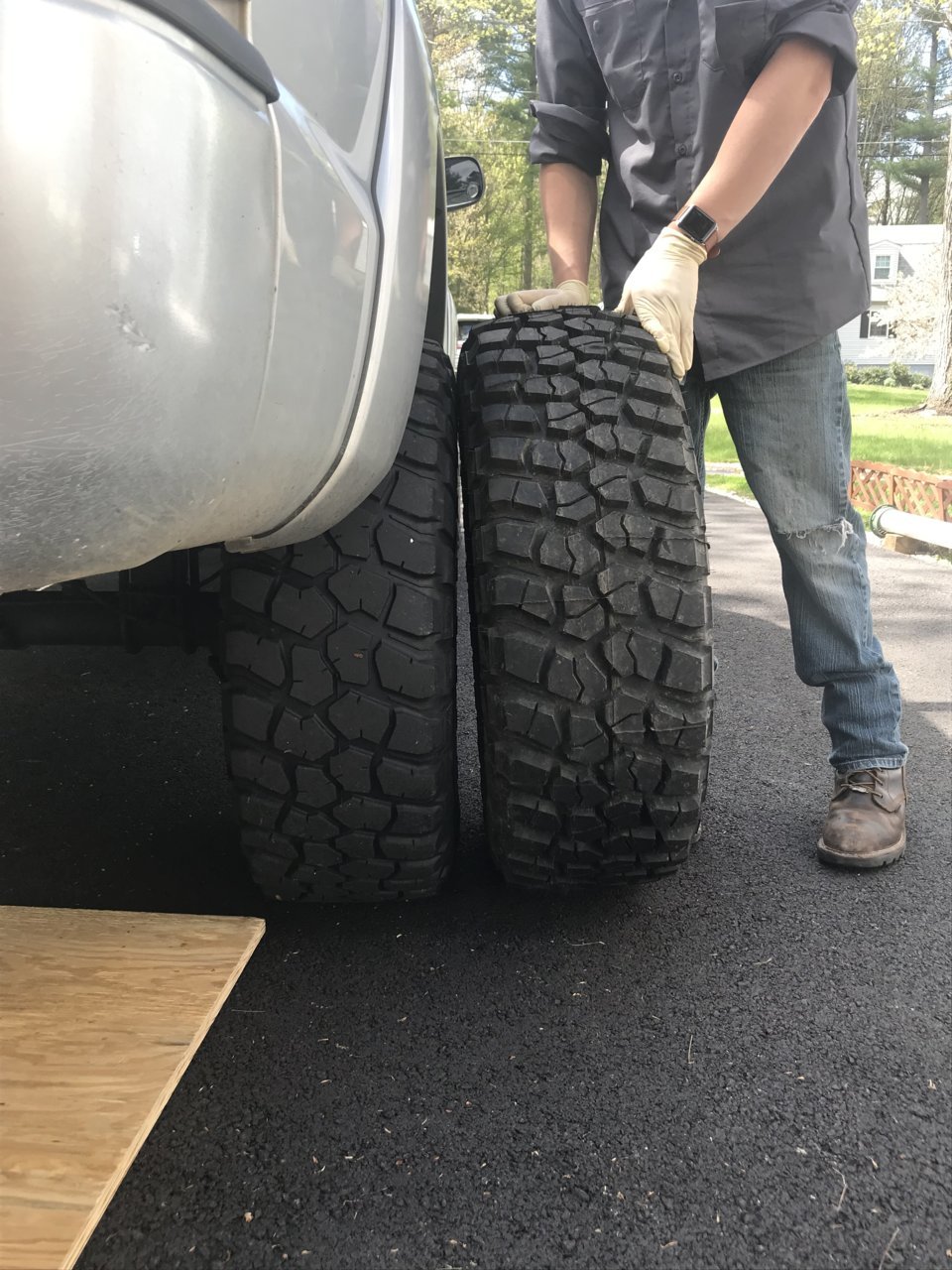

    I'm at the point of where my truck needs new tires. I currently have 285/70/17 BFG Mud Terrain KM2 in load range D.
    The new KM3 is only available in load range E in that size as of now and I tried sourcing another set of KM2, but ended up empty handed so far.
    My question is for those with load range E, how does your truck ride? I have a double cab short bed truck, no extra weight from bumpers or anything yet. Just seeing what people have to say about them. This is my 4th set of KM2's and id like to stick with BFG but if not i may have to go with GY MTR.

    It's about air pressure. I have E rated tires on both my F150 and Tacoma. With the right air pressure ride is fine and fuel mileage is the same. The tires are rated for 80 PSI when carrying the tires load capacity on a 3/4 or 1 ton truck. Most of those guys run 50-60 PSI unloaded. No reason to run that much air in a Tacoma or 1/2 ton. The wheels on lighter duty trucks aren't designed for that much pressure. I keep about 35 PSI in the Tacoma and 40 PSI in the Ford. The ride is just fine and I have more than enough air in them to carry more weight than the trucks are rated for.
    How well the tires ride and fuel mileage has more to do with the tread on the tire and tire width . The ones in the pic above are going to ride rough and get poor fuel mileage in any load rating.
