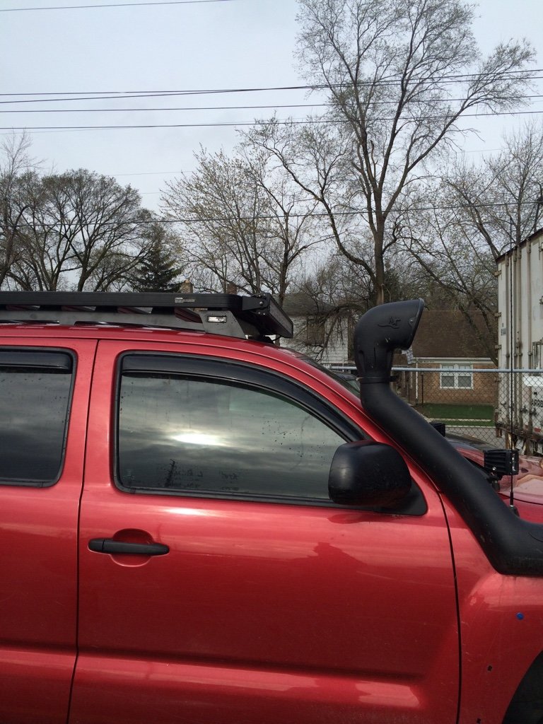

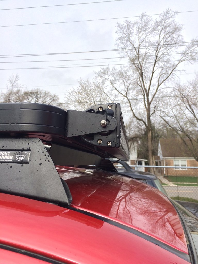

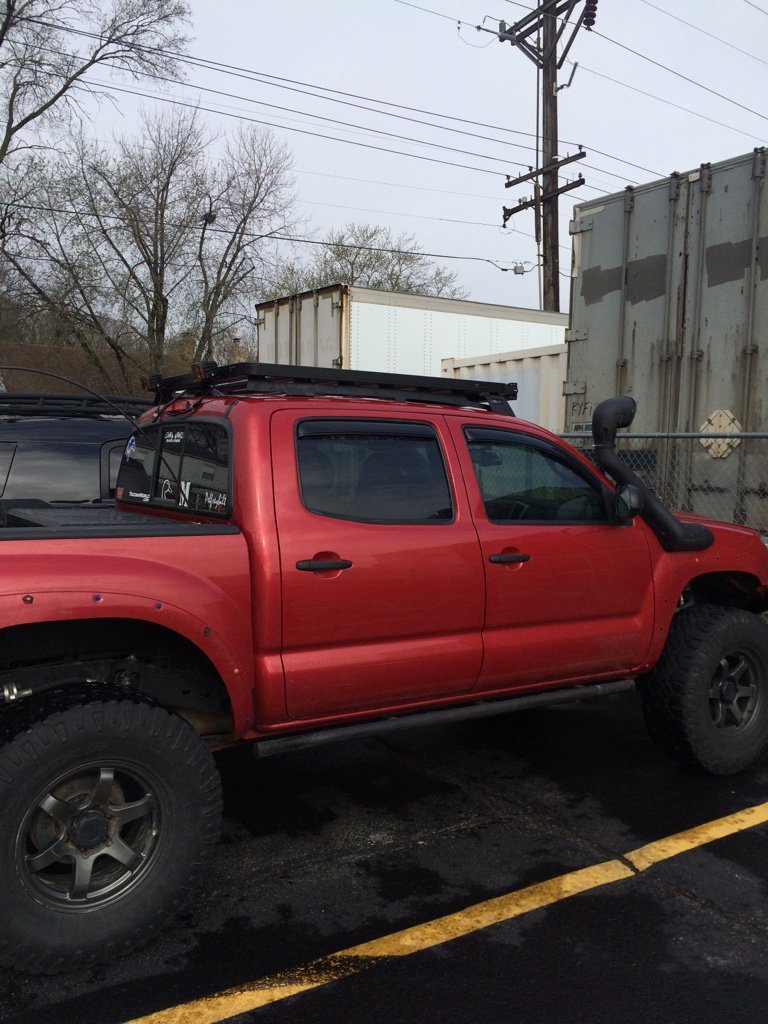

    Got the new roof rack installed. I still have to clean up the wiring, but I love it.

    Looks good

    I like that Front Runner Rack!

    Thanks! I am very happy with the switch!

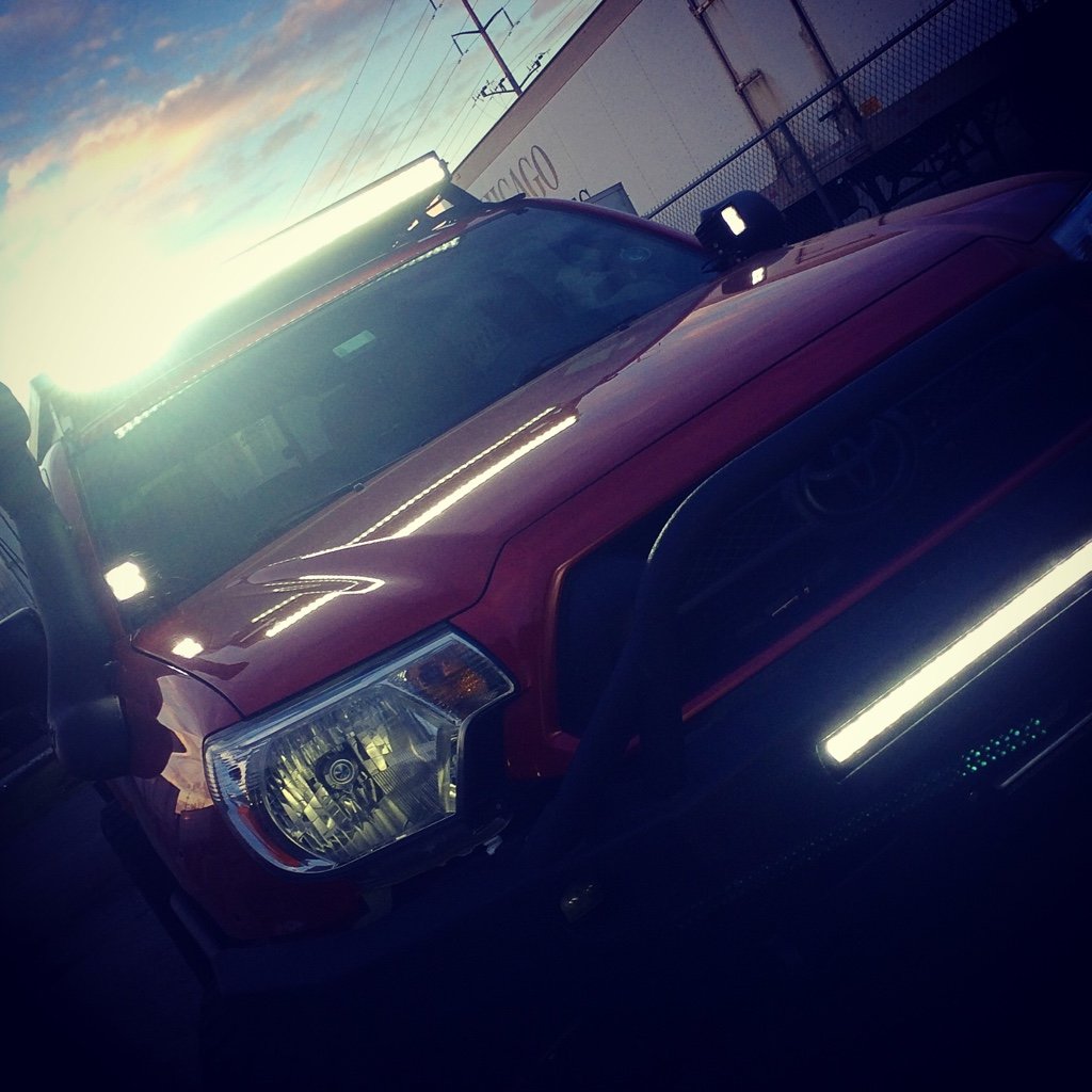

    How's the wind noise with the double row LED bar?

    So there is a high pitched whistle noise when the bar is at a certain angle. After a process of elimination I determined it is because of the spots I had to drill out to mount the light bracket I used. They are a little jagged still on the top and bottom. I put some painters tape over those spots and it eliminated the noise at completely. I do have my bar mounted pretty much dead center on the front runner racks so I don't know if it would make a difference it it was slightly off center.
    No noise comes from the bar itself. :thumbsup:

    Thank you for the insight. I'm still deciding whether I want to mount a double row like yours or a single row under the rack and in front of the wind deflector. Hard to experiment with since Rigid light bars aren't exactly cheap!
