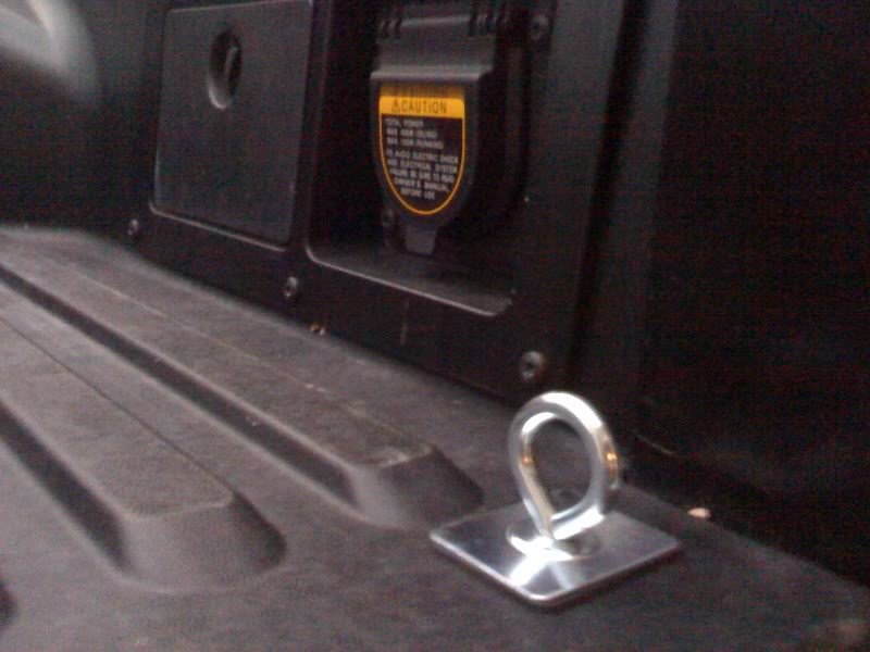

    You need 2 front bed D-rings like the 2 in the back of your bed. The sliding ones along the rail will not hold your bikes safety. Can get from dealer or get from hardware store for a few bucks like many of us have done. Search D-rings or see Cheap mods thread.

    $30.. Just do you own tie down points.. I did six of them for under $30. Im goint to plasti dip them I think though.

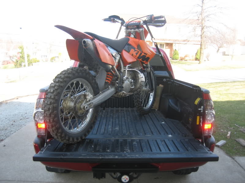

    I tied down 2 dirt bikes and it was a tight squeeze. The biggest problem is the handlebars hitting each other. We angled each front tire into the corners so the bars wouldn't hit. If you do that, you need to consider the tie down points.

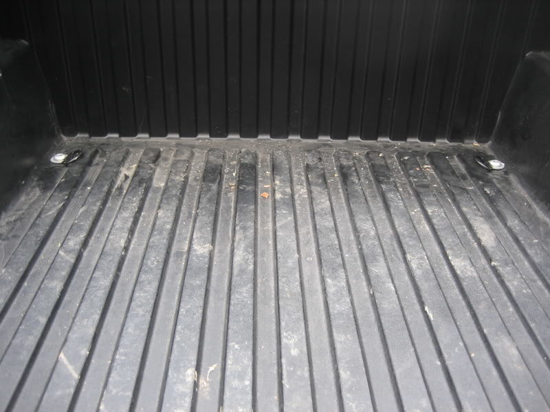

    We used the cleats for the outside side of the bars. I will not use them again! They easily bent and I was very worried about it popping out of the rail. They are only good for light tie down points.
    For the inside of the bars, we crossed over the tires and reached the D-rings I added to the bed bolts.
    Here are the bolts I added:
    Here is one 7" dirt bike loaded diagonally. Note the use of the right side cleat. When we loaded 2 bikes, the fronts were in the corners like this picture but the back end were more centered on the tailgate.
