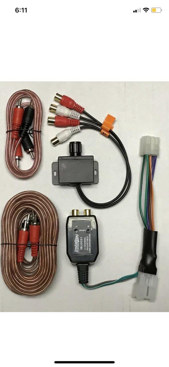

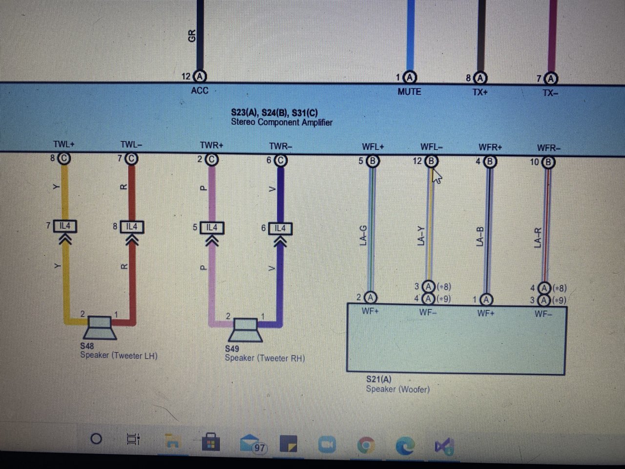

  14. May 29, 2021 at 11:58 AM
    88kiko
    88kiko [OP] Member
    May 23, 2021
    #366506
    5
    2016 Toyota Tacoma sport
    duh

  15. Jul 31, 2021 at 4:37 PM
    BamaDansTacoTRD
    BamaDansTacoTRD Dans18BlkTRD
    May 23, 2020
    #329064
    45
    Daniel
    Alabama
    2018 Midnight Black TRD Sport
    tint, Rough Country step sides, Rek Gen flaps, BAKFlip bed cover, AMP bed extender, bed mat, black tip etc
    Duh what's this? Is this what you used to connect to jbl and it worked? Do you have link? All I want to do is add amp for rear sub and I'll be golden
