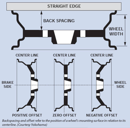

    So I bought my lift and 285/70/17 toyo open country AT2's.
    The rims are ION 171 all black 17x9
    I feel confident when I say 0 offset is gonna be 5.00 backspacing.
    I told them that was wrong and I need -12 offset to gain the correct 4.5 backspacing I "believe" I'm going to NEED with this 3" lift and 285's.
    They went back and forth with me over and over and their logic "9 wheel zero offset split 9" in halph you get 4.5 makes sense to me yes BUT!
    All the offset to backspacing calculators I can find all say the same and that's that you need -12 offset on a 9" wheel to achieve 4.5 backspacing not to mention the online sites selling wheels stating 17x9" wheel with -12 offset and 4.5 backspacing.
    Am I, the countless other places selling wheels and the crazy number of guys running this setup correct "OR" is this local shop?
    I haven't taken these wheels and tires yet. I want to be 100% sure first.

    They are forgetting (or don't know) how "wheel widths" are measured. A 9" wheel is actually 10" wide. The 9" refers to the width between the beads, you add about 1/2" per side to get the actual width edge to edge.
    With a 0 offset 9" wheel, you have 4.5" from the mounting flange to the BEAD EDGE, which is about 1/2" short of the WHEEL EDGE. So a 0 Offset 9" wheel has 5" approximately of backspacing. 12mm is 0.47", so with a -12mm offset wheel, you get 4.5" to bead edge + 0.5" bead edge to wheel edge - 0.47" offset correction = 4.53" backspacing.
    Which is exactly what you get with the various online offset/backspace calculators.
    If your shop continues argue with you, have them grab a 9" wheel from inventory and put a measuring tape to it....
    But you are right, they are wrong.

    Here's an update, lift went in tonight wheels DOnT FIT! I told those guys twice and all 8 of them told me I was wrong and promised they would fit. Well.... They don't even clear the calipers. Aluminum on caliper rubbing is not what I paid all that money for. Very pissy now and now I gotta sleep on it all night before I can go back.

    They are hitting the outer side of the caliper, so where the spokes roll out from the mounting flange there isn't enough clearance.

    It's the wheel design and not the size thats the issue. What's known as the X-factor is where the problem is.
