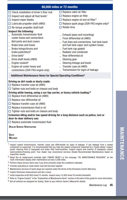

    Heres the maintenance requirement from the Manual. Id only have them do whats actually needed based on your driving/usage
    If you still choose to have those done i would stay away from shops like Jiffy lube and such. I've heard nothing but great reviews about C&R Tires in Anthem. https://www.candrtire.com/Auto-Repair
