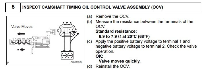

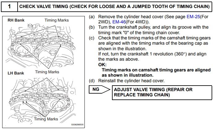

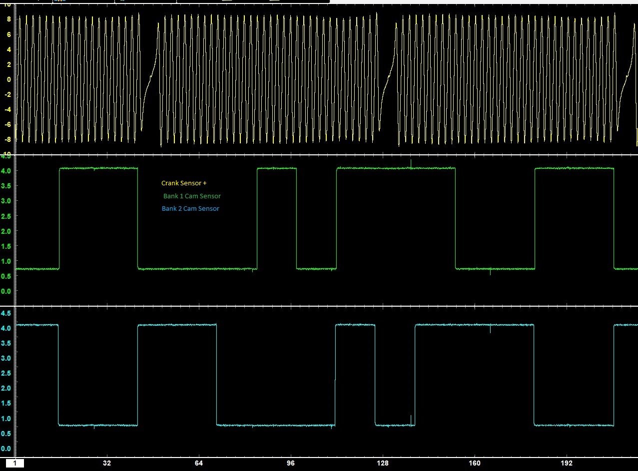

    If I was checking it I would be checking Cam/Crank Correlation with an oscilloscope, not being able to do that about all you can do aside from pulling the valve cover and visually checking timing is pull the oil control valve and inspect/replace it.

    Checking Cam/Crank correlation with a scope would be the best least intrusive way to verify timing but unfortunately not many people or even shops/techs for that matter own one or know how to use one.
    Without a scope your limited to doing the checks I posted above, the only other thing you could check is to take the inspection cover off the timing chain tensioner and see how far out it is.
