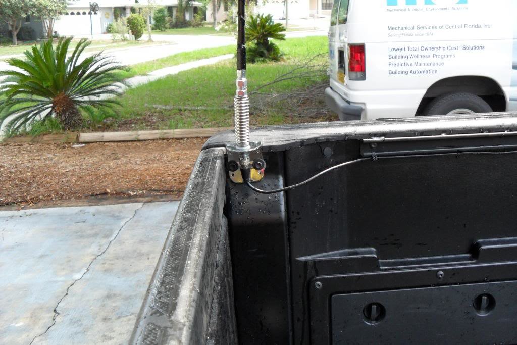

    Firestik instructions specifically request a 12" cab clearance for best standing wave ratio performance with 60% of the antenna above the top of the cab. If you measured less than a 4:1 on a Firestik less than 4' mounted directly behind the cab, your SWR meter needs to be replaced, because it's not functioning properly. I'm just going to stop there, because I've done countless experiments with several different antennas and three different SWR meters to substantiate this.
    Also, here's a pic of my setup for the OP.
