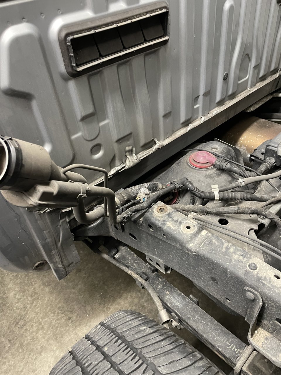

    little update in case anyone is interested. I decided to remove the bed to get at the Evap line that is leaking (This will also help a little when Removing my 3rd-member as well as it is leaking) i finished undoing everything that needs undoing tonight, buddy is coming over tomorrow to help me lift it off the truck. I never did find a good write up for what needs to be take apart to remove the bed on a 3rd gen so I made some short clips that I will put together this week and throw up in this forum. I’ll link to in on this thread to once I got it. Overall pretty easy job. Biggest hurdle is not breaking all the plastic clips that hold wiring to the bed. More to come this week, thanks again

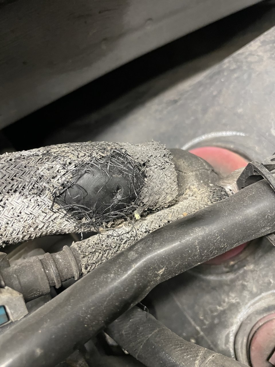

    Hey guys, got the truck bed off today, that was a little difficult with 2 people. Found the source of my leak. A tiny pin prick in this hose. I am wondering if anyone has any idea the part number to this thing? Was looking online but can’t seem to find the exact match. Other thought was taking it off and wrapping it in duct tape to repair it but don’t know how solid that repair would be. I’d hate to have to take this bed off again.

    I did purchase the tube off of https://parts.toyota.com/ I had to use their schematics to find the part but it does exist. Let me see if I can dig up a part number for you.
