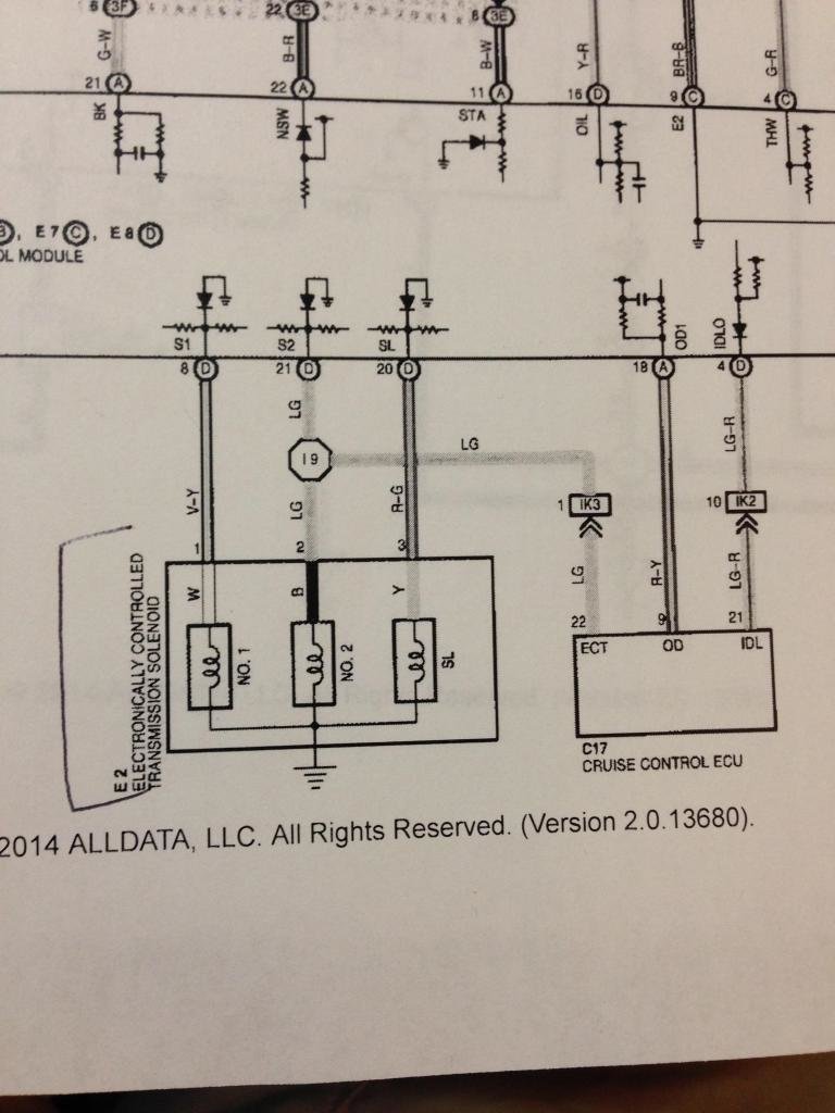

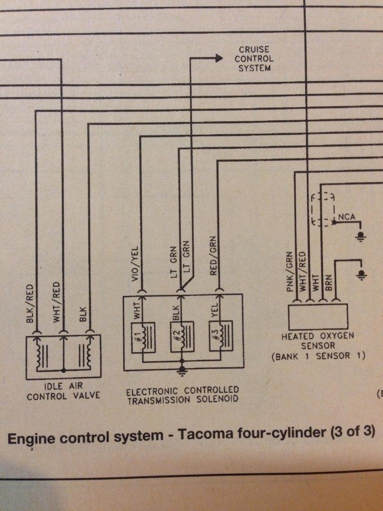

    Alright all, I (almost) finished my '99 Prerunner to 5sp/4wd swap; All that remains is some dreaded rewiring. I am following a write up on wiring resistors to the shift solenoids so that it will trick my auto ECU into thinking that there is a resistance (auto tranny) so that it will be factory like. I believe I have found where the solenoid wires are on the wiring diagram but need some help and confirmation on where exactly the solenoids wiring harness plugs would be on the old auto tranny so I can double check that I am using the same wires according to the pins. Here are the two diagrams I am looking at, ones from the Haynes manual and the other from Alldata. photo24_zpsabfd1872_a39dfcdacf34b04f533bd3e3cc988f061c93bf95.jpg
    My question is are these the right leads to be wiring to the resistor? Are NO. 1,2,and SL the same as A,B, and E? Anyone else done this before?
