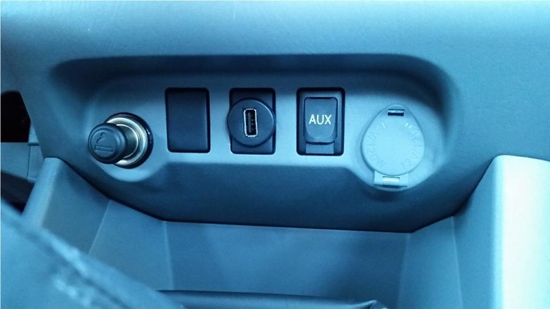

    PAC-USBCBL from Amazon.com installed into blank filler plug under A/C controls

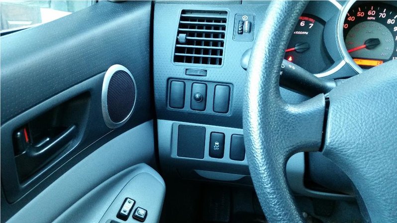

    Microphone supplied with JVC H/U installed in blank filler plug to left of steering wheel. I drilled a hole in the filler plug and used RTV to hold the mic in place.

    For the mic I was thinking either the false plug next to my fog light switch or the top of the A pillar. I have an 08 so I don't have the blank switches under my a/c controls. I'll figure something out though for the chord. Thanks for the tips!
