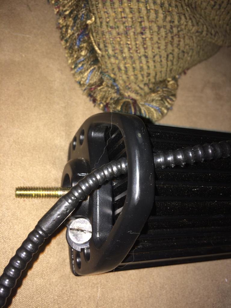

    So I finally came to a solution to securing my light bar, it's not 100% secure, but is fool proof and should be adequate.
    I bought a thin high quality bike lock, then undid the end plates on the light bar. Once undone, I threaded the lock through the end plate and between the grates on the back of the light bar. Did this on both sides.
    C90AA513-5DE6-4964-897D-43D13CCC7CA9_zps_773fdfebcc72d5bcf807fd5cc73a150b8e306ca3.jpg
    I haven't mounted it back up yet, but with the lock/chain being taught behind it, even if someone wanted to pull the light bar out they wouldn't get anywhere with the locks being be there. And the small space would make it hard to get bolt cutters inside and undo the chains. And by the time that happens, my viper alarm would be going off so they'd be gone
    Its fo proof and theoretically makes sense, so hopefully it works well!
