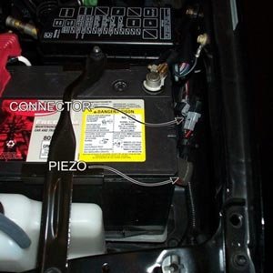

    I wasn't comfortable leaving the wires loose and yet the beep was killing me and my dogs. I took the mechanism out and stuffed it with some old rag I cut up and it works great IMO. It's there but only for me to hear. Hope this helps.
    Note: There are #3 Holes on the beeper. 2 smaller ones and 1 bigger. I only stuffed the bigger one and I got the result I was looking for. Thought of then wrappiong it in tape. But was rather happy without any further work.

    This is a link to the write up on CustomTacos on how to disable the beep from locking and unlocking your doors. There are two methods, on that works on 95.5-00's and the other method for the 01-04 crowd.
    http://www.customtacos.com/tech/index.php?article=34

    Doing mine tomorrow. I also hate the beep, and the double for the driver side door. Plus, it locks after about 30 seconds on its own!
    Just put some insulation tape over the annoying beeper, wow thats more like it.

    Just unplug it and throw it in the trash. That was mod #1 for me with this truck.

    The beeper has a small hole..may 1/4".
    I stuffed a foam ear plug into it. It still beeps but you can barely hear it.
