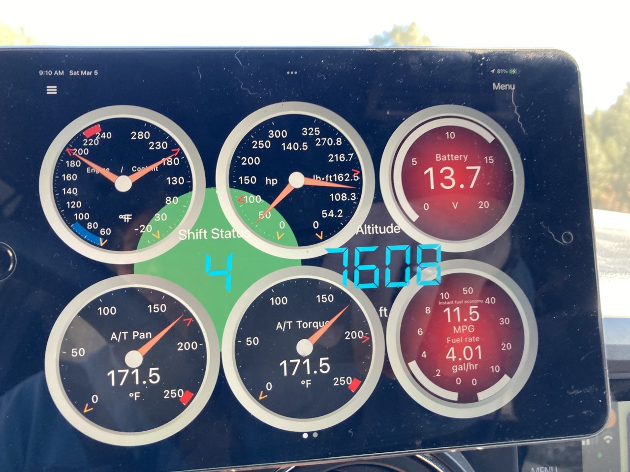

    Think of the torque converter like a clutch. When it’s locked it’s not making heat, when it’s unlocked it’s slipping and generating heat. Less heat is good for transmissions. The TC only locks in 4th, 5th and 6th whilst cruising I believe.
    My 2020 manual no longer mentions using only S4 ECT for towing, just recommends ECT and using S5 and lower in regards for engine braking and charging. The manual actually implies using D and ECT.
    When I tow I use S5 without ECT and monitor temps and lockups to decide what gear to be in. Have towed 4,700lb some 5k miles this year and can average 12mpg regularily.
    This is one of my dashboards. The green circle behind the gear indicates ‘lock up status’. This was as I peaked a 3,300 ft ascent…

    I wish it would stay locked above 58mph but unfortunately doesn’t. 5th unlocks quite easily and temps skyrocket if you’re not paying attention.
    I do use 5th a lot for towing but I am very conscious if it’s locked or not. Driving barefooted is really useful when towing, have to be very gentle with that pedal to reap the mpg benefits of a locked tc.
