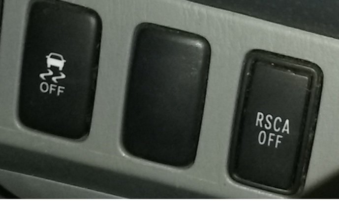

    mw
    2" suspension lift/wheel spacers.
    And if they keep it...
    2 extra switches on a 4X4 truck that they'll never figure out wtf they're for in 9 years minimum.:proposetoast:

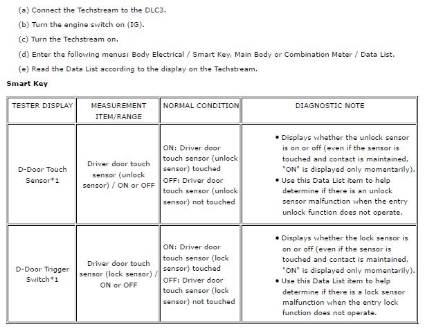

    found info related to Smart key entry function on page 2366 in the 2016+ Toyota Tacoma Service Manual (see below):

    Don't forget the glare from that non-functional hood scoop.. Sounds like a hunk of garbage to me.
