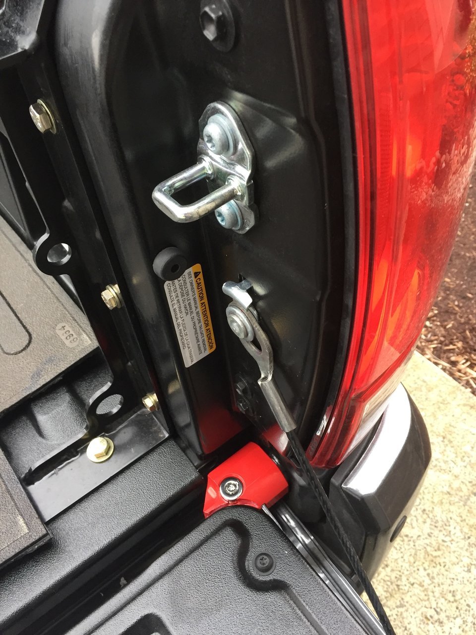

    After seeing how much it costs to replace a tailgate and knowing it will be well over my $1000 deductable, I decided it was worth putting a couple 20-cent washers over each of the tailgate cable eyes to lock them in and $1 for a stainless hose clamp to lock the hinge. Ive accidentally left my tailgate unlocked before and it’s apparently easy to pop the lock too. If it helps slow someone down enough that they leave the tailgate, its worth it!
    If you use a hose clamp, turn it backwards and tighten it from below and behind the bumper with a long screwdriver - makes getting it off harder.

    Depending on the clamp, you may be able to swap it out for a Torx bit. I’ll probably do that if I go that route.

    PS...fill & cover the clamp's screw with JB Weld and a screw driver cannot take it off..!
