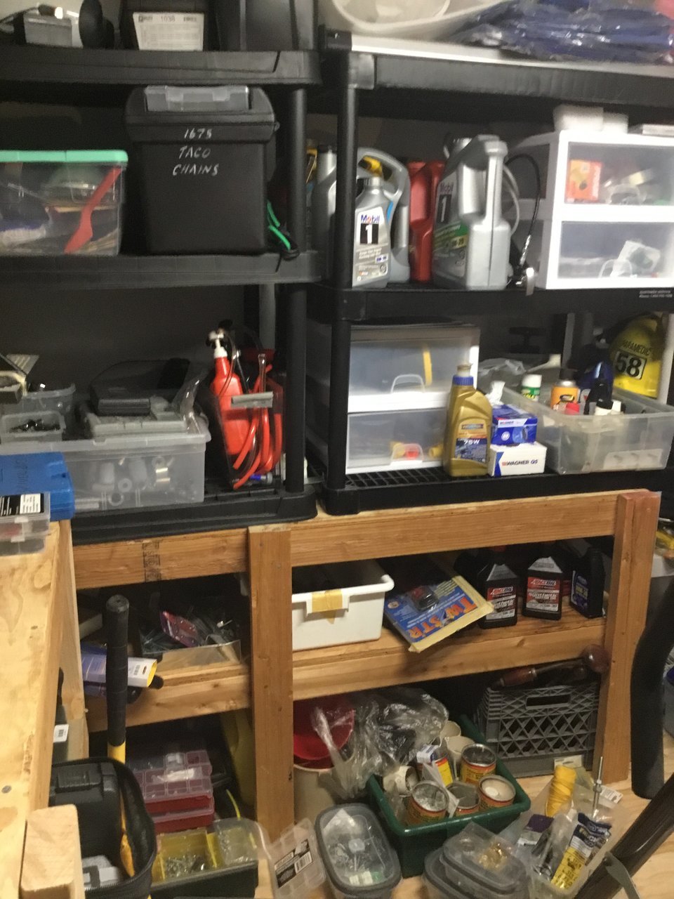

    My post was meant as a compliment! And that is some organized garage. Also, a compliment!

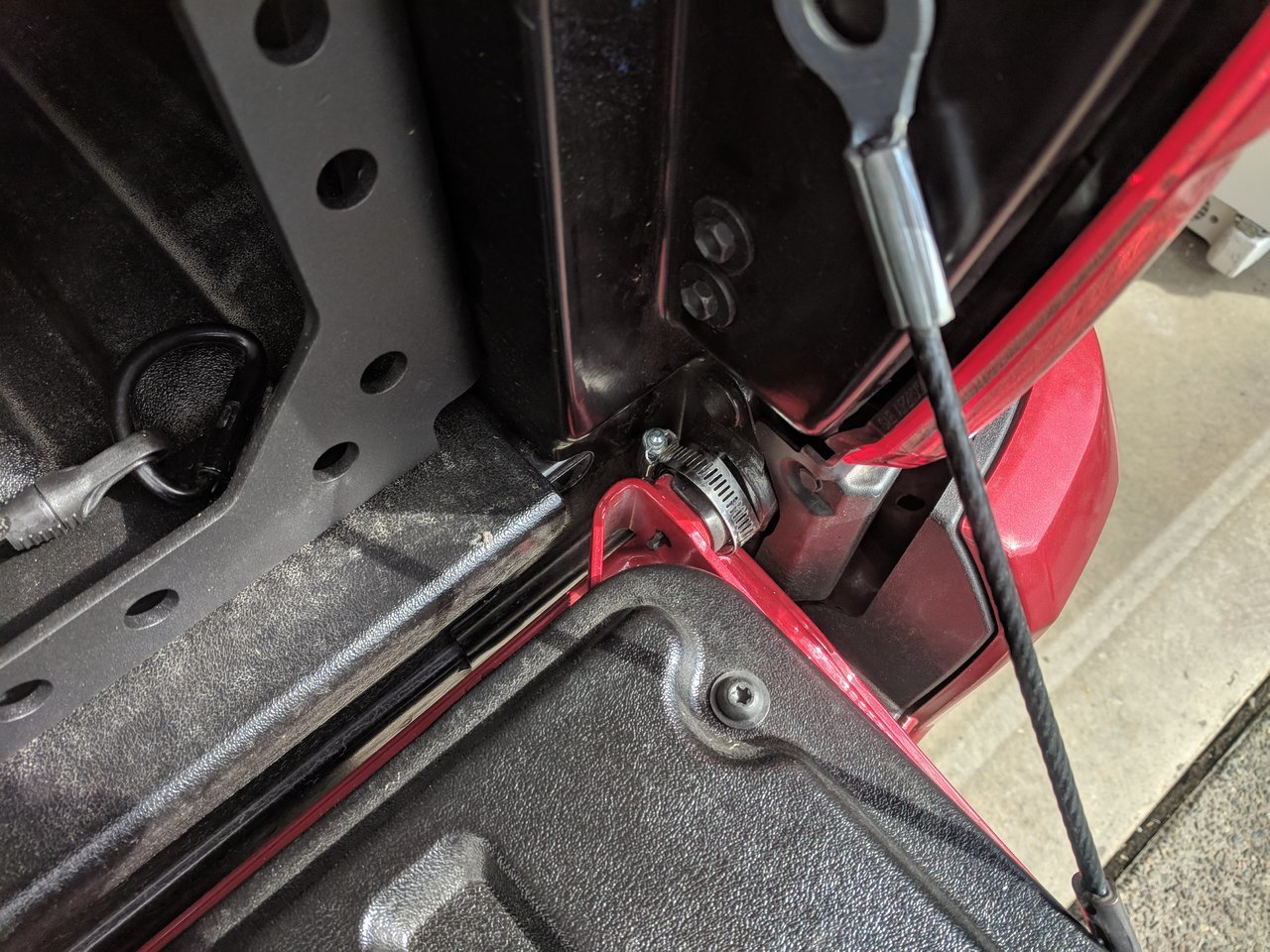

    I installed the clamp soon after I joined here. I was bored today, so I did this:
    Took just a few minutes and really decreases the target-of-opportunity level.

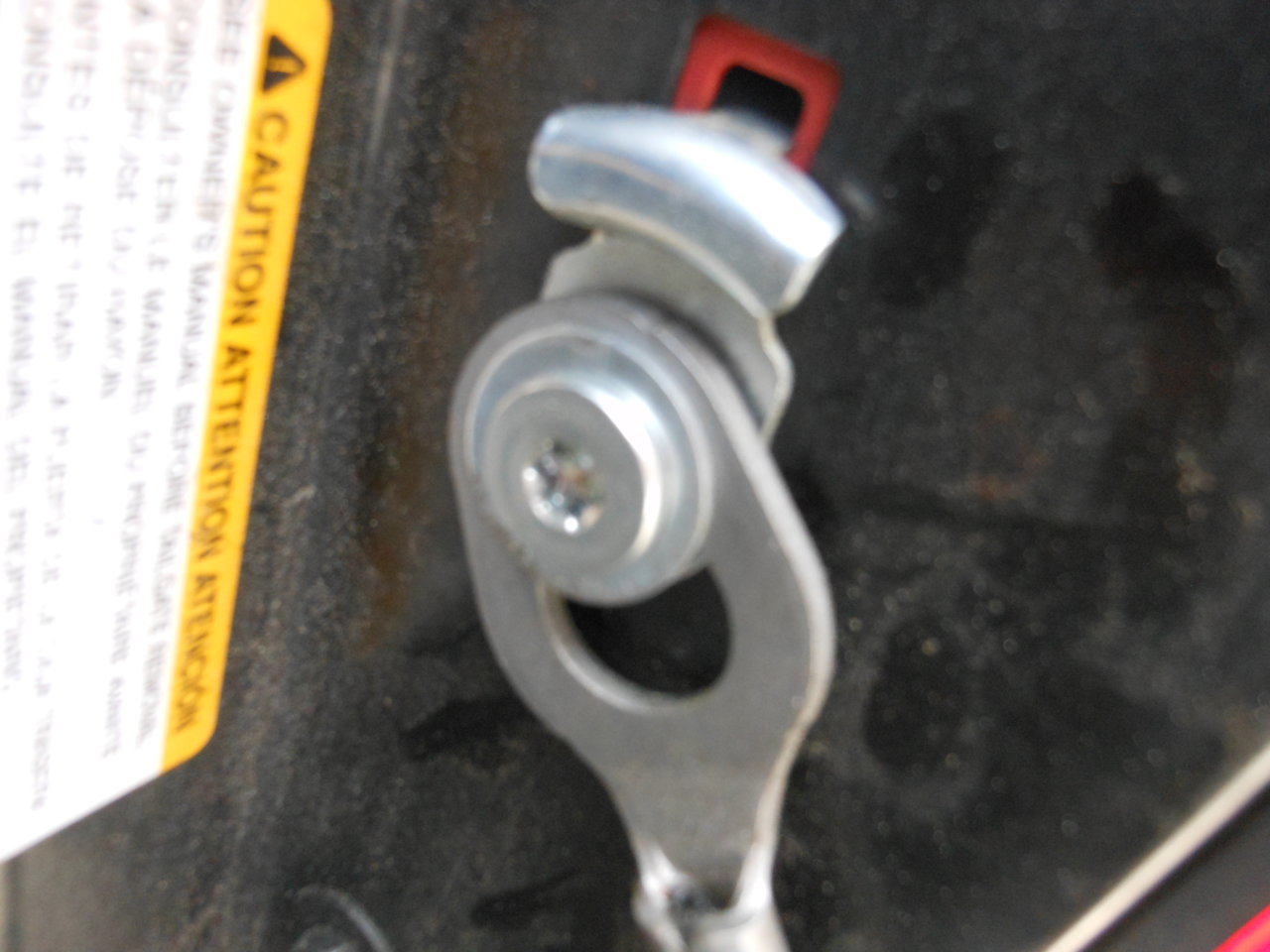

    Yeah, I thought I might get a "motivated" thief, so I turned my clamp over as well and then I put JB Weld all over the screw head part of the clamp...They would have fun getting anything on that clamp to remove it... If I need to remove it....4" grinder and 5 seconds...
    Also.... I added washers to both cables, so that they do not disconnect without removing the Torx screw on both sides.....!!

    Pic of washer installed....

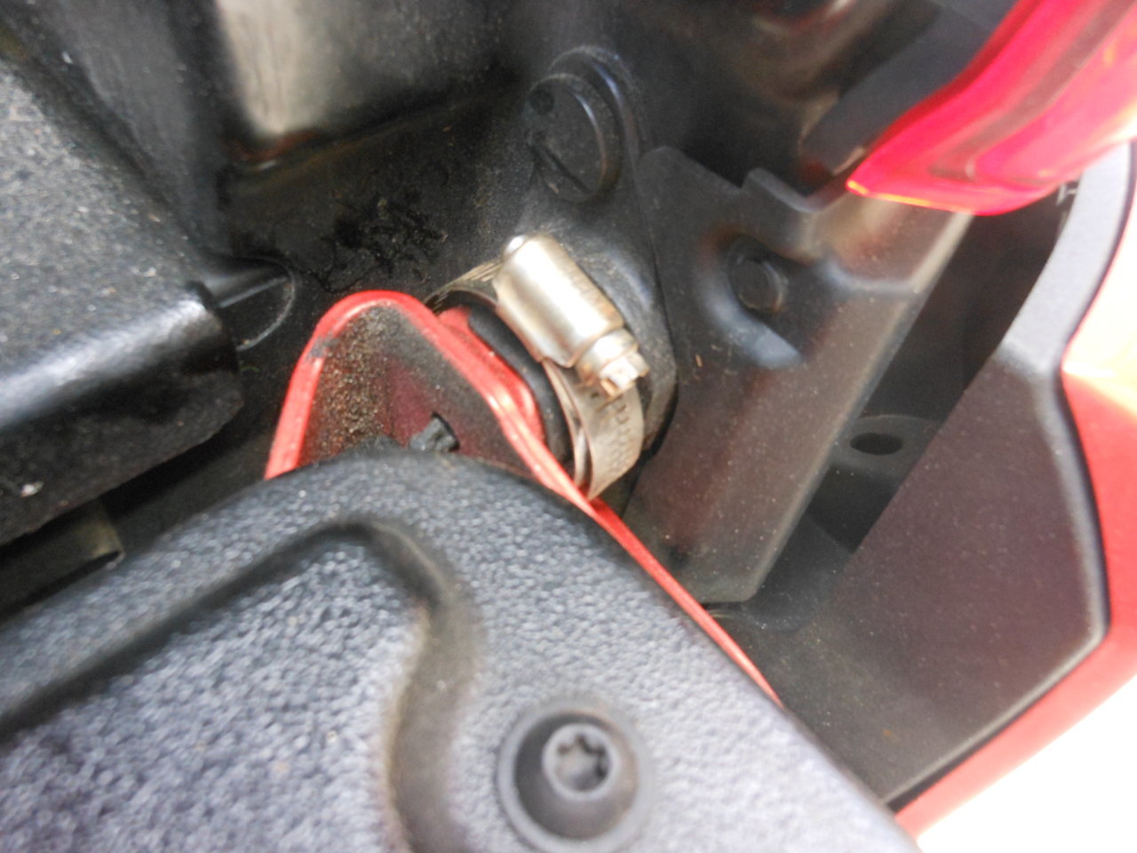

    Found a size #20 3/4"-1-3/4" stainless steel hose clamp for $1.00 at my local hardware store. Positioned it so it has to be tightend/loosened with a long screwdriver from underneath, between the bed and tailgate.
