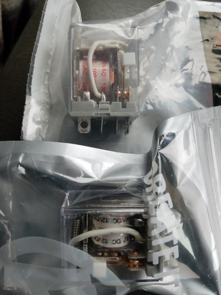

    Yup ran to radio shack, got different relay, got stuck in parking lot to get wheels to spin. Relay clicks and locker works all the time. Here's the ac relay with red writing and dc relay with black writing
