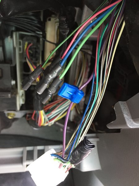

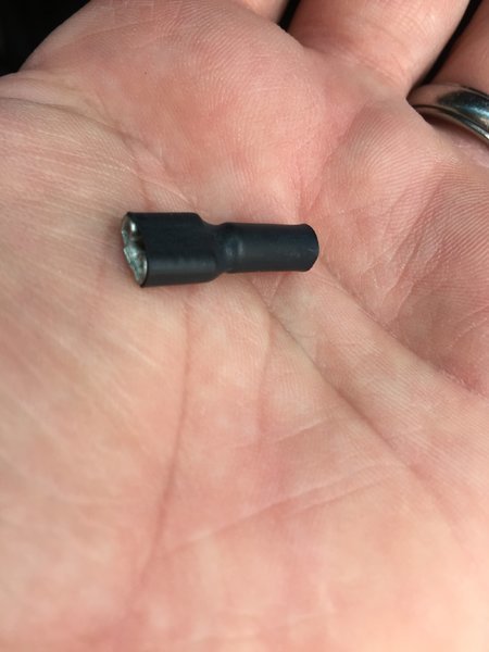

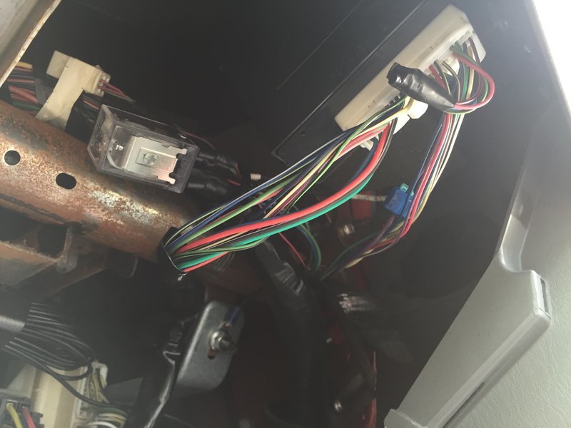

    WOW! I LOVE this mod! Here are a few pics of mine. A couple things to mention...
    1. As we discovered, be sure to match up the colors from the plug, not specifically the plug placement as mine was the opposite plug as described.
    2. I am a little anal about things and it made me nervous to have the ends of the connectors exposed and possibly arc against something else, so before crimping them on, I added a little heat shrink to each connector so nothing would be exposed when they are attached to the relay. IMG_3477.jpgIMG_3479.jpg IMG_3480.jpgIMG_3481.jpg

    That's a good idea. Looks good!

    Nice job
