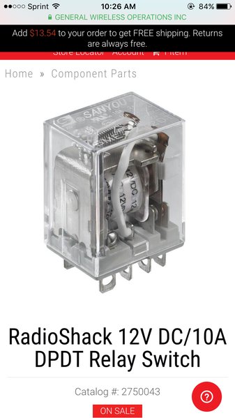

    image.jpg Put it back to stock and the locker worked right away..must be a faulty relay because the motor was getting no power. I'm going to pick up the radio shack relay this time .

    Did you use 1 of those blue 3m wire splices?
    I've had a lot of trouble with those on the smaller gauge wires.

    I removed about 1/2" of insulation on the purple wire and twisted the y to it. Had intended to solder it but my soldering iron was broken.
    The relay was clicking when it was on but j guess it wasn't delivering power to the locker. My crimp connectors are all fine because I'm using them right now in "stock" format. The only explanation is the relay, the ground, or the y. The ground and the y are both ok.
    Hopefully I can pick up the new relay soon! Was happy to see that locker light come on!
