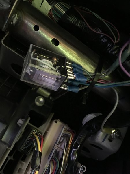

    Finally after 2 years of knowing about this thread I finally did it haha great write up :thumbsup:IMG_0762.jpg

    Looks like those contacts are too close to the metal. I would def wrap that thing up in the electrical tape
