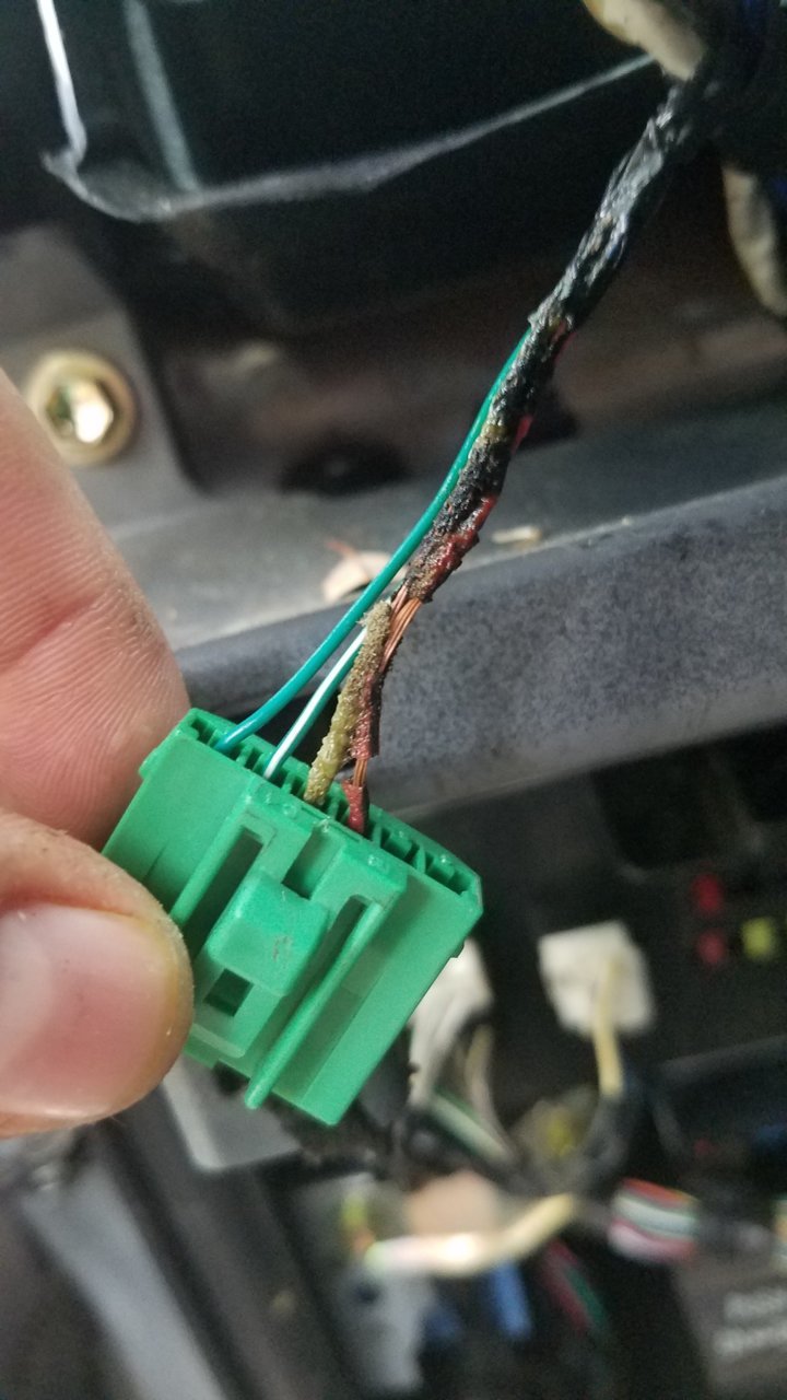

  5. Jul 28, 2018 at 2:27 PM
    #465
    Fizzy
    Fizzy Member
    Jul 23, 2017
    #224847
    17
    2006 TRD Off Road Access Cab
    Well it appears I'm in some shit but I expected that. Here are the wires at the switch melted together. Any idea where that yellow wire goes? I'm just going to run 2 new wires obviously.

  6. Jul 31, 2018 at 11:23 AM
    #466
    TXpro4X4
    TXpro4X4 Fuck Cancer!
    Oct 29, 2011
    #66093
    28,674
    Bryan
    Costa Mesa, CA
    2011 TOY
    :eek:
    Have no idea. Might be in here somewheres
    Good luck
