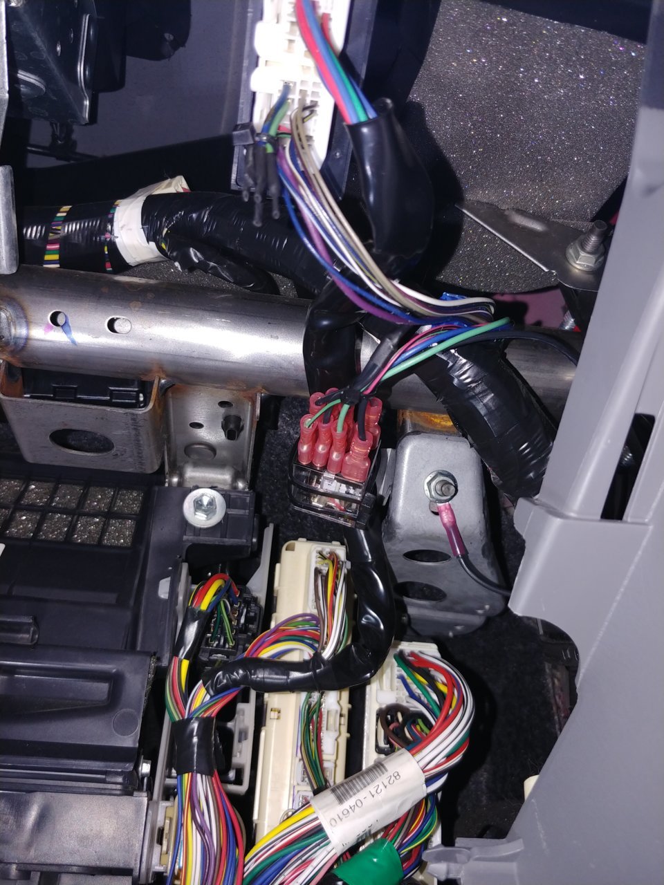

    Finally got around to doing this mod this weekend. Used a relay off of Amazon, soldered a 1N4007 snubber diode between the terminals for the relay coil, made all the crimp connections fit and so far so good! Tested it out in a big dirt parking lot. Everything seems to work 2WD, 4Hi and 4Lo. Wicked pumped to finally get this done. Doesnt happen too often, but theres definitely occasions when having the rear locked up in 4Hi is useful. Seemed to work pretty good this weekend doing some mild snow wheeling up a pretty steep little hilll.
    The scary part:
    Making the y-connector - pre-solder. Really only needs to be 3-4 inches long, but better long than short I suppose
    You can see the diode I soldered into the relay under the cover. Its under the heat shrink. The band marks the cathode (negative) but gets installed opposite. That way it will snub out the high voltage spike as the magnetic field decays. If its installed the way that you would expect (pos to pos) and (neg to neg) then it will conduct straight to ground and blow the fuse. (at least thats my understanding ...) So in this pic the one terminal that isnt hooked up yet is the ground pin
