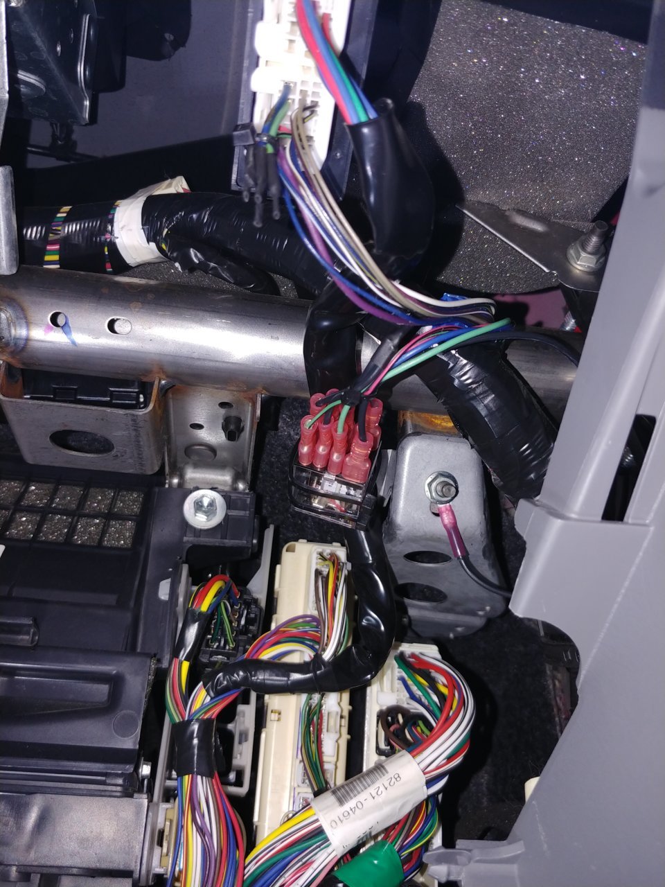

    So where did you guys mount your relays??
    I ziptied mine up to the other wire loom coming from the 4WD ECU as pictured. Not super happy with that location though because the back of the glove box actually hits the relay as it opens and closes. Theres not a ton of slack in the wires to get it somewhere else though obviously..

    I have had no issues with location.

    Mines just zip tied to the side of the support where yours is. It's never been a problem and the glove box doesn't hit it.

    This is how mine looks

    Yeah Ill have to get under there again and take a look sometime. It was starting to rain /sleet pretty good as I was wrapping this up so I kinda just stuck it up there. But Im sure a few zipties will get it squared away

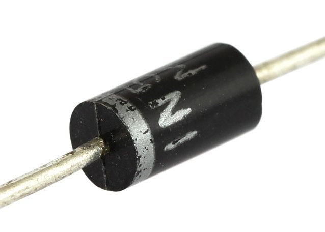

    Just to be sure, these are what I follow if I made it myself and used the relay that you suggested (with LED)?
    Also, will the ends from the diode making contact with any wire in the relay itself cause any issues? After I soldered it in I noticed that it may be leaning against some of the wires going to #5 and #6.
    Thank you for any help!

    Glad you asked. There are a number of ways to go wrong with this. The LED relay cares which way the diode goes in and the video is for the non-LED relay. (which doesn't care which way the diode is installed. ) If you look closely at the diode it will have a white band at one end.
    That end of the diode MUST go to pin 8 on the relay. The other way won't work and may even blow fuses. The extra length of wire at each end of the diode needs to cut off close. If not they may short the other pins and the will cause problems. If you follow these instructions you will follow this connection pattern.
    1. Green / Black Stripe
    2. Violet (one end of your "Y" cable)
    3. Violet (the other end of your "Y" cable) ((the third end of your "Y" cable is connected to the violet wire using the vampire tap))
    4. Pink
    5. Green
    6. Blue
    7. Ground (if you are using a diode equipped relay it's important that 7 and 8 are connected correctly. If you do it backwards fuse ig1 no.2 will blow.)
    8. Red / Black Stripe
    Hope this helps
    04tacomarob[QUOTED] likes this.
