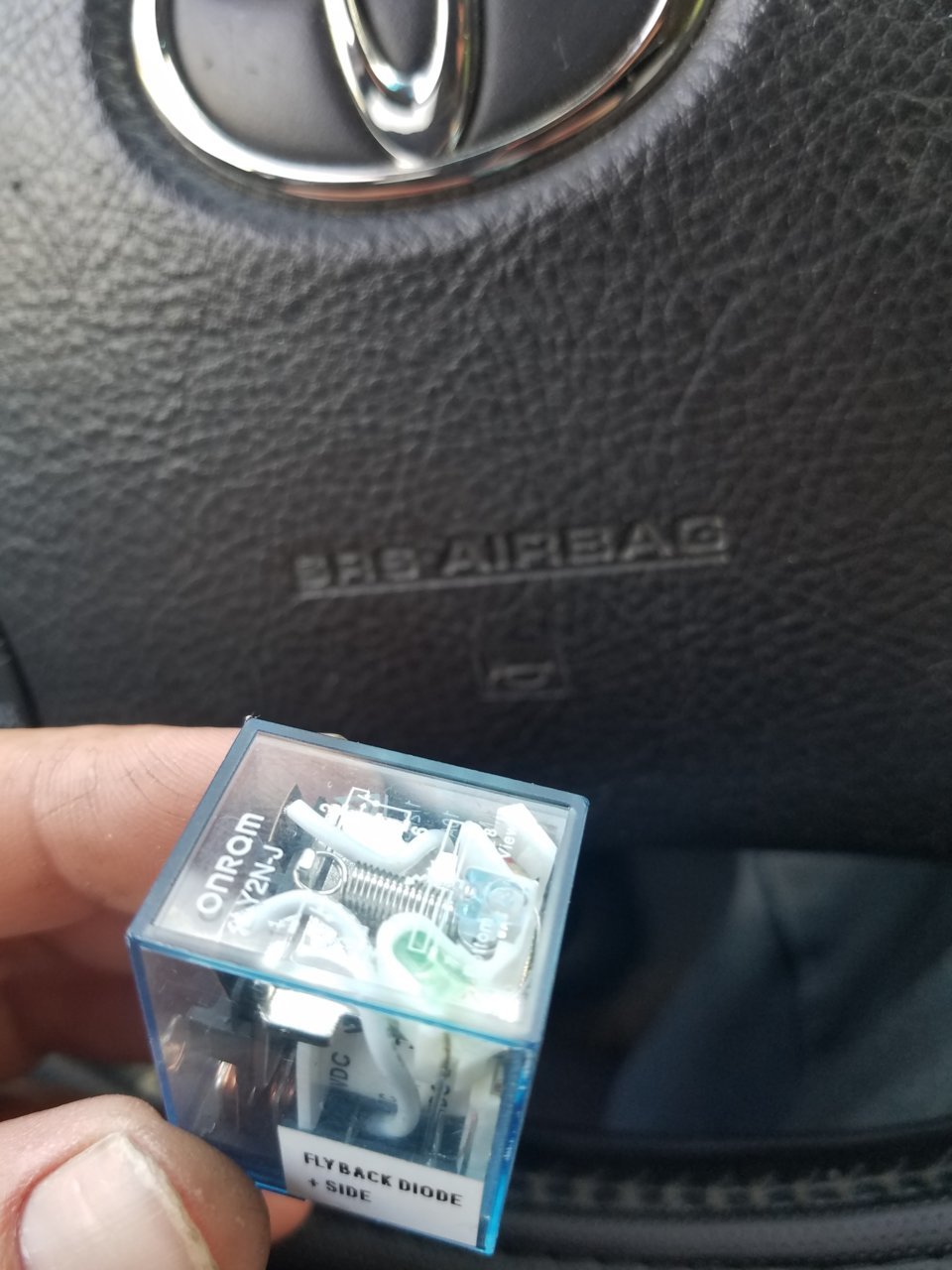

    As soon as a starting troubleshooting I knew it was the wrong coil.
    No problem. I put it back together with spades so the new one will drop right in.

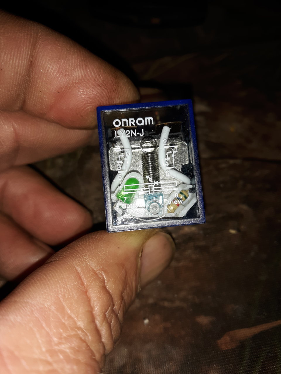

    I got your email. There is a green led in it though

    Alternating and direct current or two different power sources.
    Strange is when I looked and this happened to me after switching the wires around like after reading in your first paragraph of the first post about the wires being switched around and still having issues I looked at the new relay and it says 12 volt DC so I thought all is well I just thought I was having issues so I gave up.

    Etsy email replied.
    All green here.
    Thanks for following up on this.

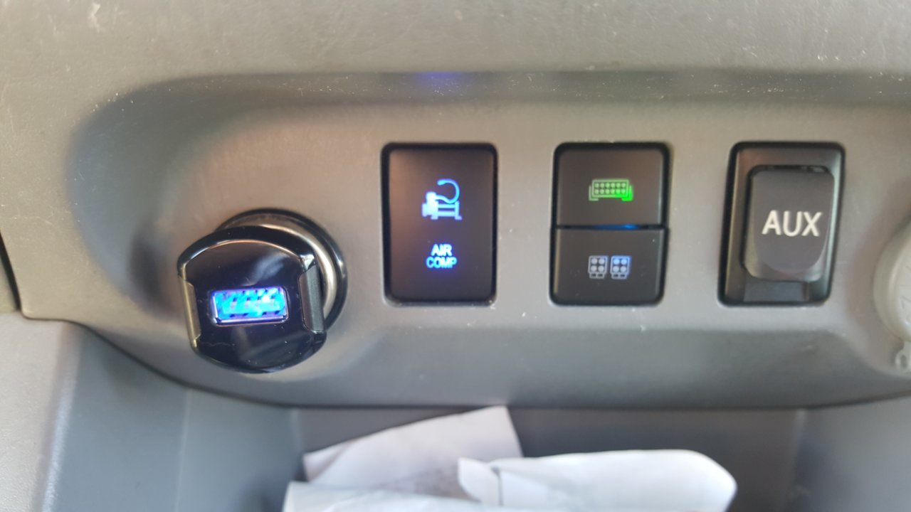

    Edit: No.. no air locker yet, just temporary switch till then

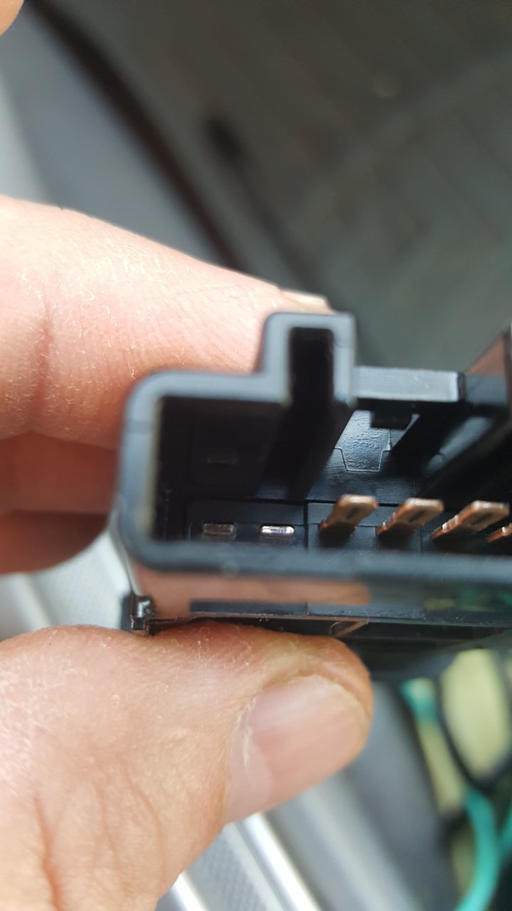

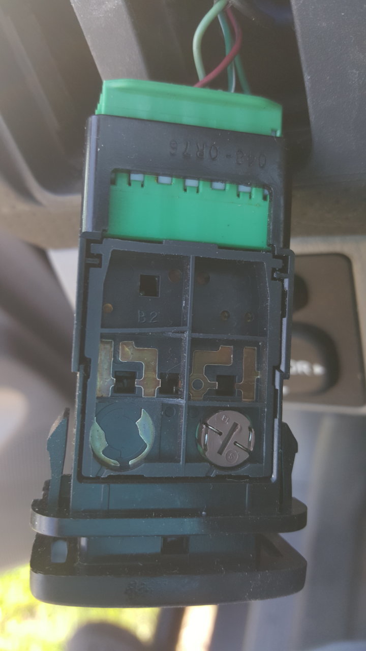

    Its weird! Looks like the switch almost has the spot for the light with even the contacts where the light makes contact but not fully cut out and has the pins but cut short for the second light. If you took a second spare switch you can probably drill a hole and re-pin extra pins in the switch to make it illuminate 20200217_153724.jpg 20200217_153744.jpg
    Not sure if a newer taco than my 07 has that option
    jungleman and TXpro4X4 like this.

    4 wires in the plug looks like?
    I'll have to go through the wires to see what they do. I figured there would be three.
    I dig into it when I get the new relay and have it all apart.

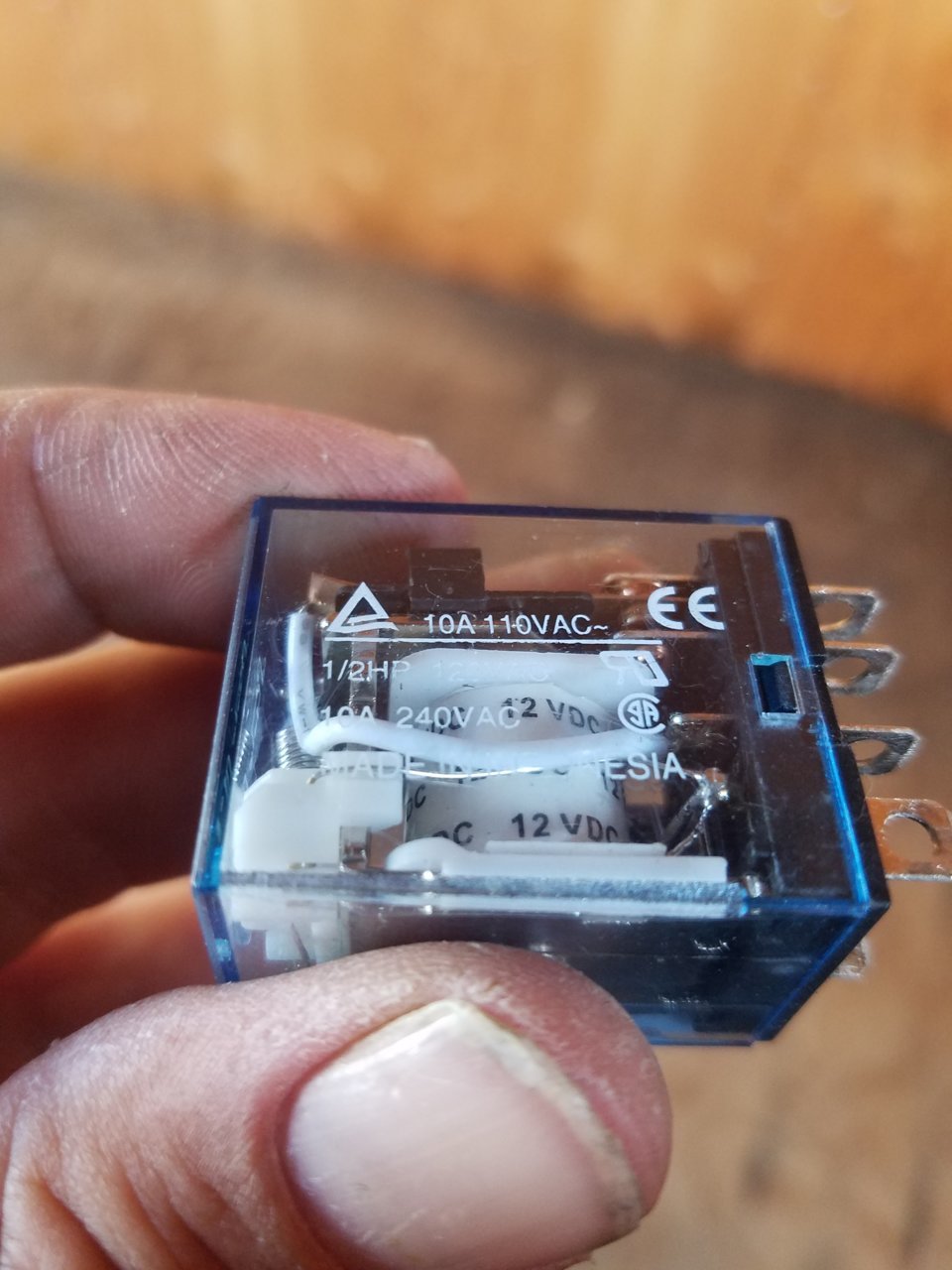

    I was looking at the relay and if I'm not mistaken this relay is made for 110 volt A/C
    This 1 is not going to work.
    Even though the coil on the inside says 12 volt DC and it doesn't have enough power to operate that's what the relay does is interaction of the Transformer so energy can pass from one side to another, this relay is actually made for something for a house not a car.
    I'm pretty sure it is.

    That should work. The coil is what we need at 12vdc. The contacts should not care what the voltage is as long as it is below 120v/240 10 amps.

    I will double check and cross reference with the relay that works at lunch tomorrow. Beer:30 right now :cheers:

    I would think you where right but if that where correct then it should work. All I'm doing is swapping 2 wires basiclly. That's where I'm lost. I'll do it after work. To busy to go take it apart from behind the glove box.
