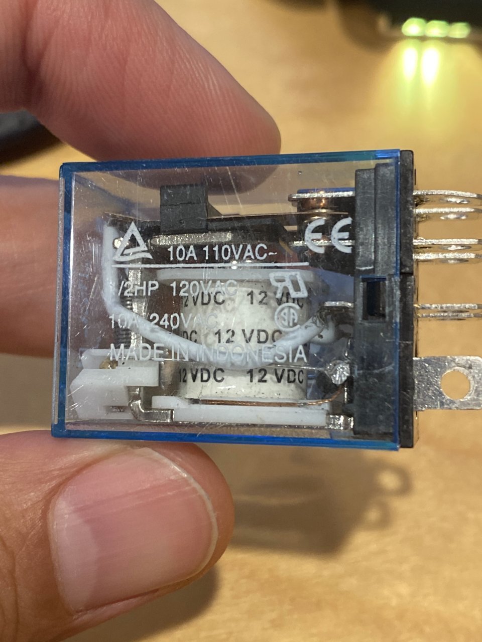

    That looks OK to me. The actuator coil is 12 volts DC (vdc) The 10 amps 110 volts AC on the case is referring to the maximum load the relay contacts can handle. I just measured the load put on the contacts in my truck at .0012 amps. That's nothing compared to the rating of the relay.
    (warning! Nerd moment read at your own risk. :D )
    Because AC goes from + voltage, through 0 voltage, to - voltage it is easier to switch than DC which is constant voltage. DC will sometimes arc across the contact so manufacturers lower the rating for DC applications. Typically the DC rating is around 10 times lower than AC.
    So, what does that mean in our case? Comparing 110 VAC with 12 VDC is sort of an apples and oranges thing. However if we convert the measurement to watts we can look at them on a level playing field. The relay is rated for 1100 watts AC (10A * 110 V= 1100 watts) That would derate to 110 watts DC. In our trucks we need a relay that can switch .0144 watts DC (.0012 A * 12 V). In other words it's like we have $110 in our pocket and we're spending a penny.
    (/nerd)

    My original relay was an AC coil so that would blow the 10 amp fuse regardless of how I configured the red/black and the ground.
    I should have the new one in a couple days and we can compare what is going on.
    I would like to know what you find though.
    Should be here Friday so the USPS tracker says...

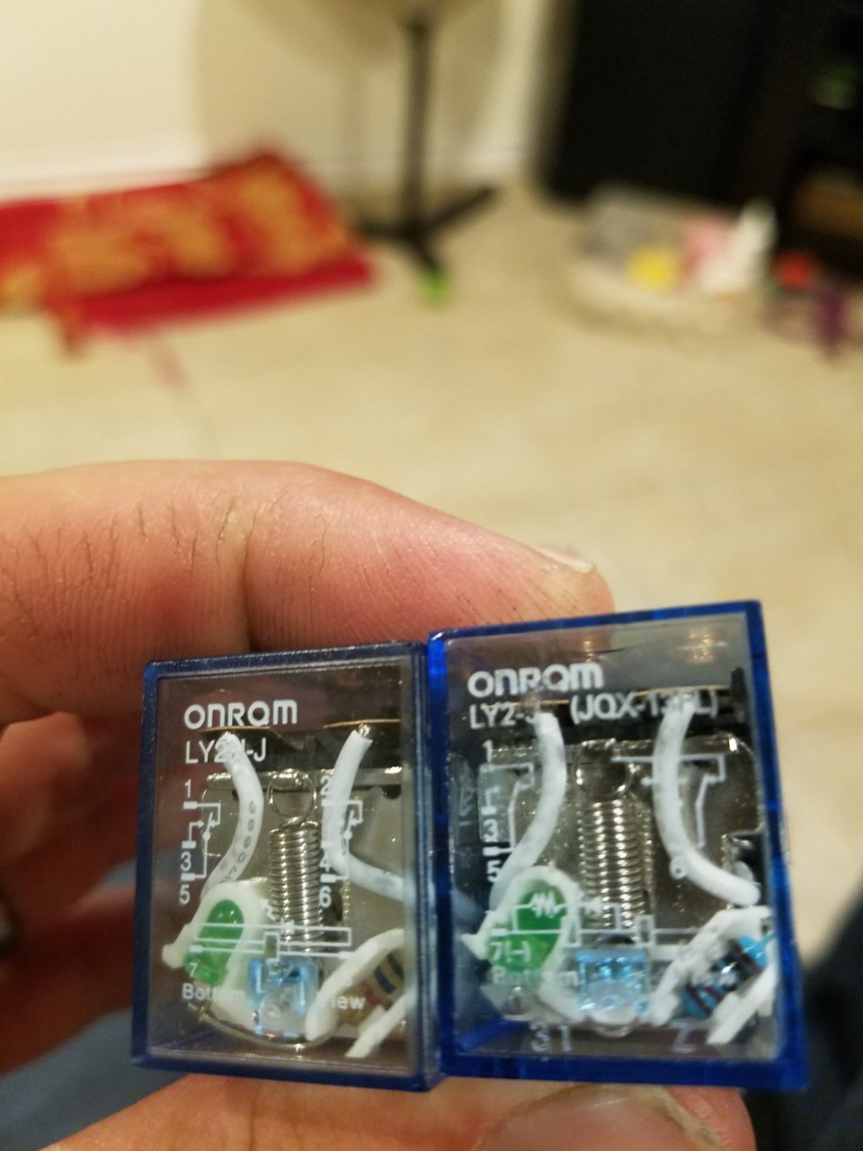

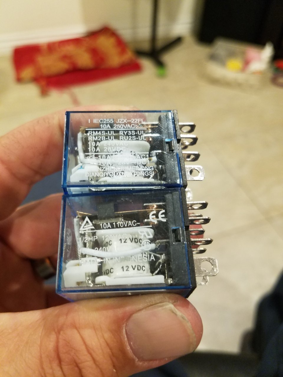

    New one on the right
    1582682868229655082515316405564.jpg new one on top
    :fingerscrossed:
    Thank you again! @jsi

    Reporting back. All works as advertised with the new relay!

    I think I might have the wrong relay as well.
    Ordered on 12-JAN-2020
    Transaction ID: 1784046191
    I haven't had the time to install and try it out and have also been watching the thread to see if I do indeed have the wrong relay.

    From what I can see you should be good to go. The bad relays had a red LED.

    Both of mine are green but look at my last post wit the pics.
    The relay printing is different
    And the new one on the right has more Id numbers on the top and side.
    Have not had a chance to install yet and try.
