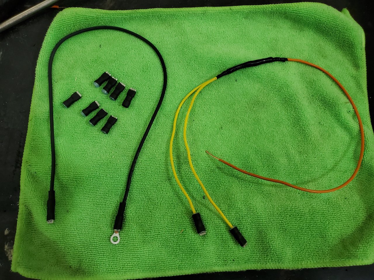

    Getting ready :)

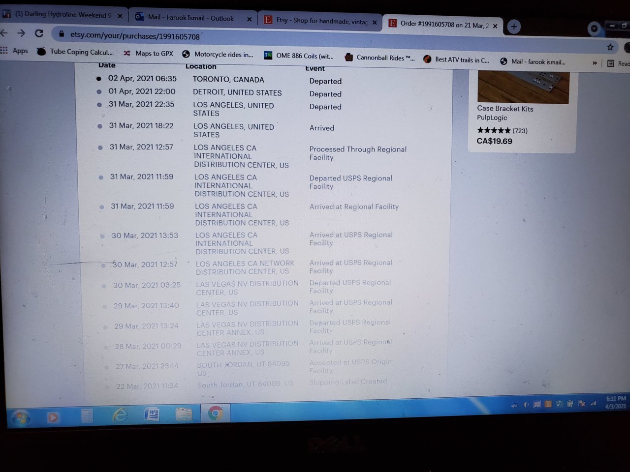

    I think its.getting closer:)
  20. Apr 3, 2021 at 3:18 PM
    #660
    jsi
    jsi [OP] Well-Known Member
    Apr 25, 2013
    #102881
    1,986
    native earthling
    That's just crazy!
