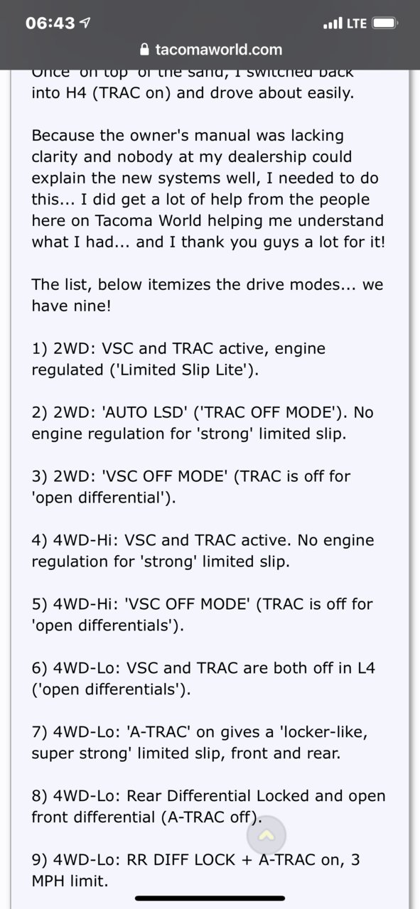

    I just ordered your last relay. I'm excited to get it and do the mod. I wouldn't mind having a spare in case it went bad. How long do they usually last? I also had questions about the mod. When the locker is activated with the mod will the traction control be turned off or is that something you have to do manually? I have two different buttons. One has the picture of the vehicle slipping like traction control. The other one says A Trac. Can anyone tell me what the A Trac is and if I have to manually disable that when using 4x4 or lockers. I sure miss the older vehicles with solid front and rear axles and no traction control.

    That's good to hear about the relay. I started reading about the A-TRAC and from what I am gathering it can be used along with the lockers. People are saying it's the closest thing to having front and rear lockers when you have it engaged with the rear lockers. Apparently the TRD off road has 9 driving modes. This is what I found on the site.

    I wonder how #8 and running in 2WD-Lo would compare in actual driving/trails.
    Is 2WD-Lo considered Open?
    The front driveshaft doesn't rotate.
  13. Oct 9, 2021 at 9:17 AM
    #693
    JJ78
    JJ78 New Member
    Sep 22, 2021
    #377783
    4
    John
    2011 Tacoma TRD off road
    I'm thinking that open diff means your still in 4x4 but you don't have any kind of traction control. So if one front tire started spinning the other tire that wasn't spinning loses power because all of the power is sent to the tire that's spinning. I bet if you had the locker anytime mod and locked it in with the truck in 2 wheel drive with the A-TRAC on it would do pretty well. Apparently A-TRAC sense's a tire spinning and slows it down with brake control and sends power to the tire that isn't spinning. But I guess technically your front is considered open in 2wd because those wheels aren't going to start spinning. It's still a little confusing to me. There's too many options. I'm going to have fun figuring it out though.
