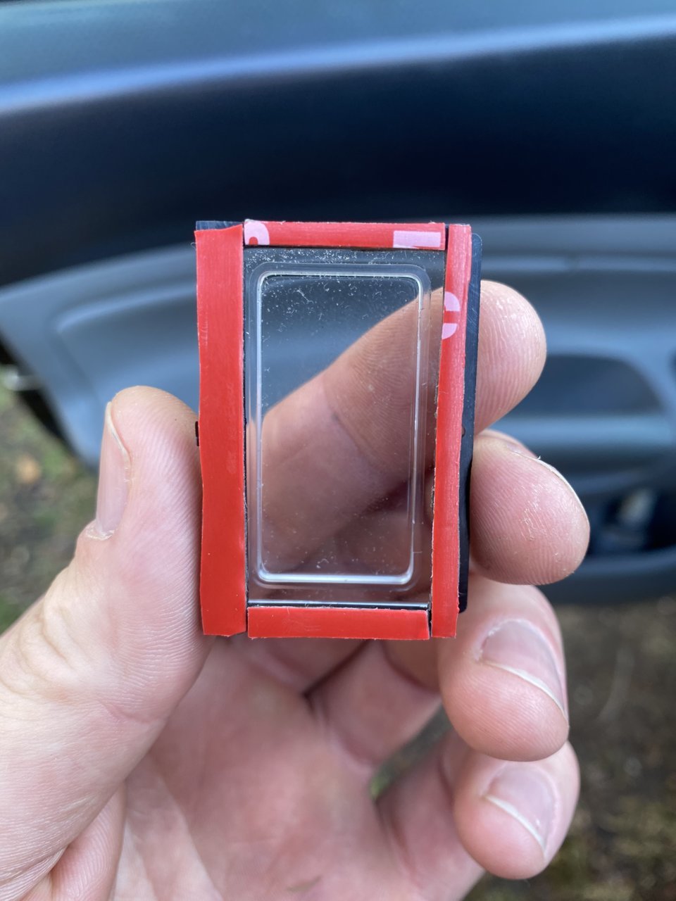

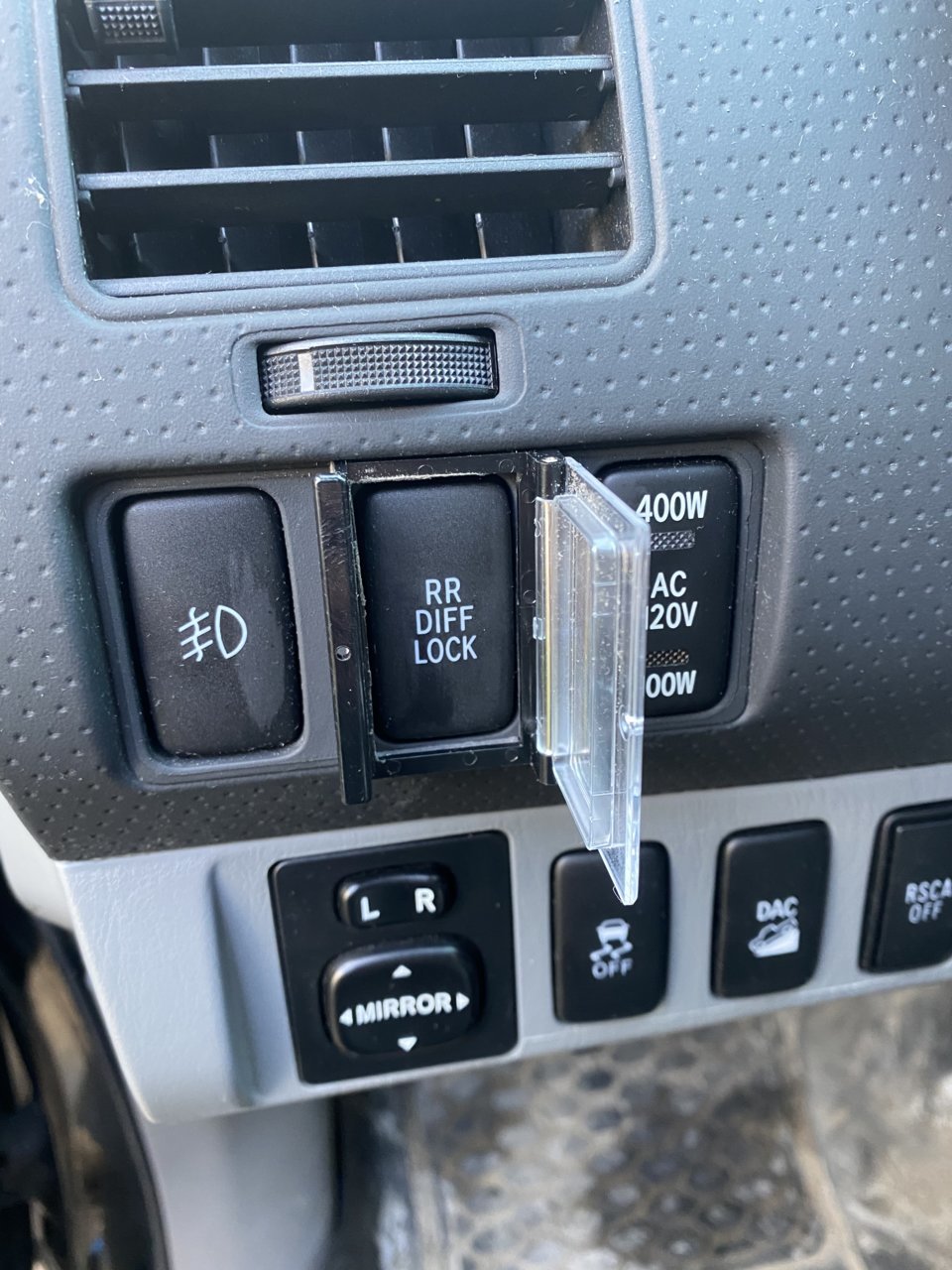

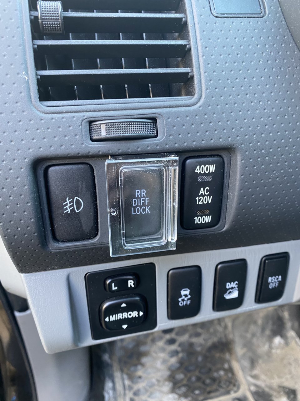

    This mod is awesome, the only thing I didn’t like was the idea of hitting the switch by accident. So I found this switch cover and decided to add it on top of the locker switch to prevent that from happening. The fit was just a little snug so I filed the top and left side down just a hair, installed 3m double sided tape and stuck it on there. Just installed today so can’t say whether it will come loose over time. Cost was about $30 after shipping https://www.alliedelec.com/product/eao/03-925/70029836/?keyword=70029836

    I like that a lot. From personal experience I have hit the locker button on accident, more than once. The last time was at freeway speed :eek:. It's no big deal to activate it at speed, but activating it when you're stuck and one wheel is spinning could be expensive.
