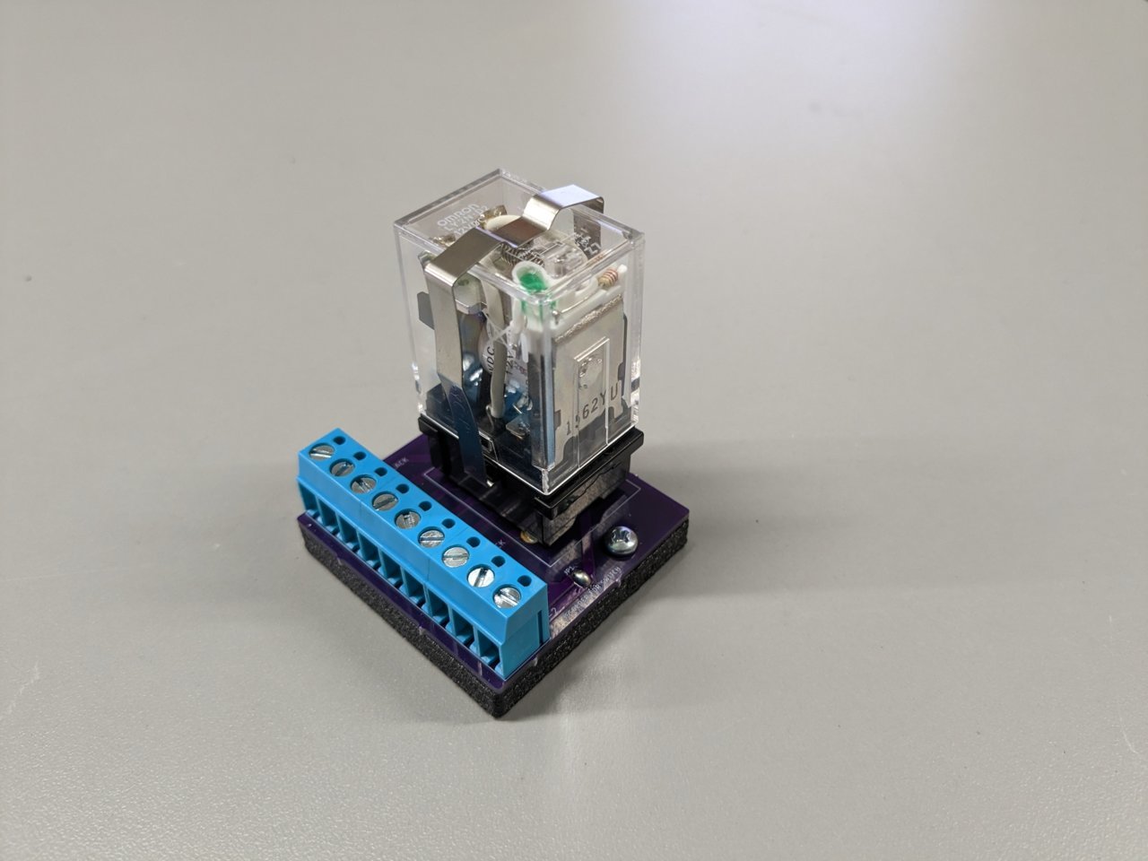

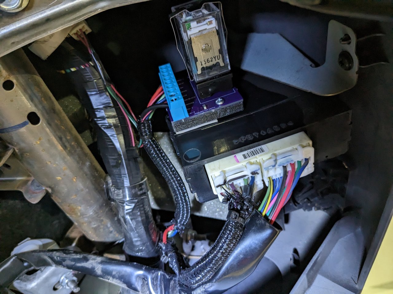

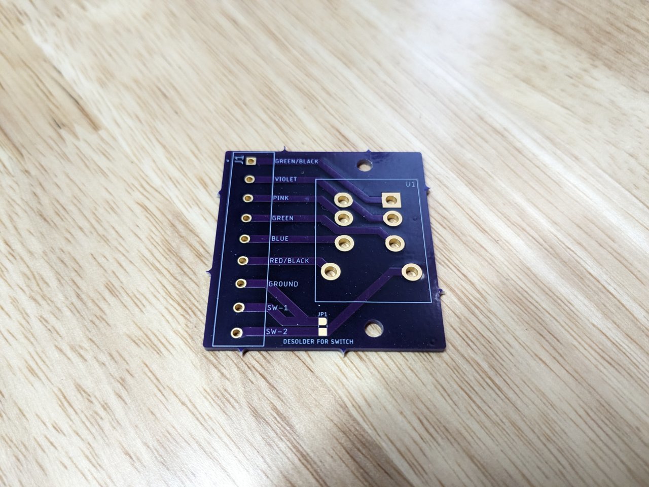

    Hey guys, wanted to share something I've been working on for a little bit. Thanks to @jsi for the detailed write-up, super easy to follow and extremely helpful.
    When I saw the mod, I started looking into the relays and saw that they make a PCB socket for the Omron relay that's now in use for this mod. Got me thinking that it may be fun to design a PCB to make the mod "easier", which led me to design this:
    It holds the relay, and uses screw terminals to connect all of the wires. Plus, I added a solder jumper that enables a couple terminals for a safety switch. Nothing fancy, just interrupts the ground to the relay. Here it is all assembled, and then installed:
    I 3d printed a little backer for the board and it's stuck to the locker control module with some 3M mounting tape. Works great in the garage, have yet to take it for a drive. I omitted the safety switch, but the option is there if I need it.
    I'll be the first to say this was totally unnecessary since this is already a really easy mod to do, but it was fun and I'm happy with how it came out.

    Thanks! Fun project. I just took it for a drive and tested, the locker definitely engaged. I also saw a few lights come on, like the ABS Off light and RSCA. I assume that's expected?

    Yes

    I've got two more of the boards, minimum order with the board house was three. I'm unlikely to need a second, so you're more than welcome to one.

    That board has potential. I looked into doing something similar. With a slight modification you could mount the diode on the board and use a less expensive relay. Those Omron relays are nice but spendy.

    After my read through the thread when I started this, it certainly seemed like you covered the vast majority of people that were going to do this mod by now (almost 10 years!). My setup doesn't make things a huge amount easier anyway, so I'm unlikely to start supplying these. Just figured I'd get the extras out there rather than collect dust.
    @jsi looked into the connector if you go back a few pages, and it looks like he struck out. It'll be very hard (impossible?) to make anything plug and play without the female connector.

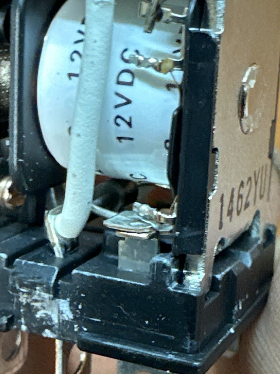

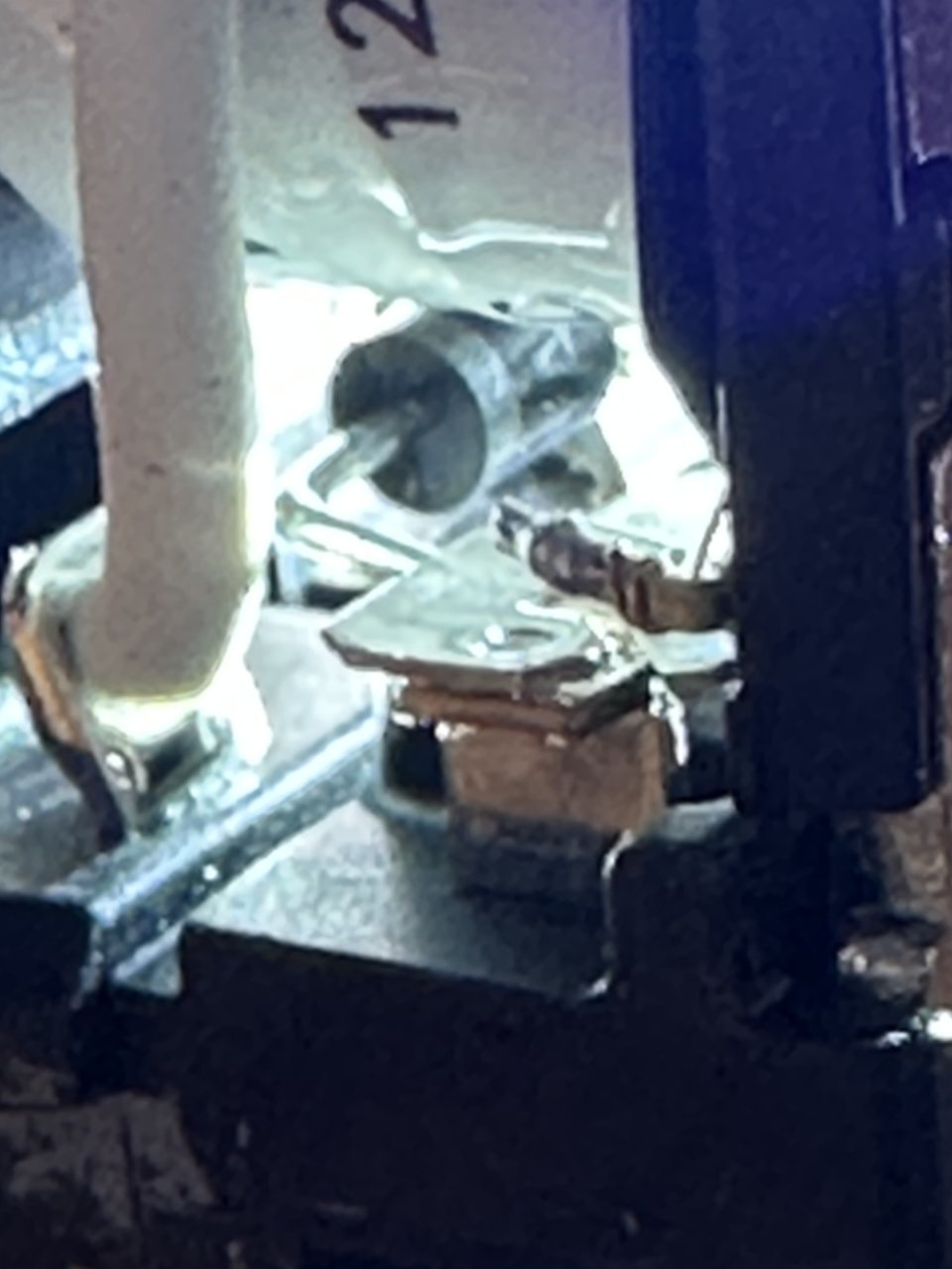

    Hello I ordered the relay from mouser and it looks like it already has a diode installed can anyone confirm?

    That sure looks like a diode. Hard to tell from the picture, is it black with a white stripe around one end?

    It looks more like a light gray stripe around it on the pin 8 side

    That's a diode and it looks to be correctly installed.
