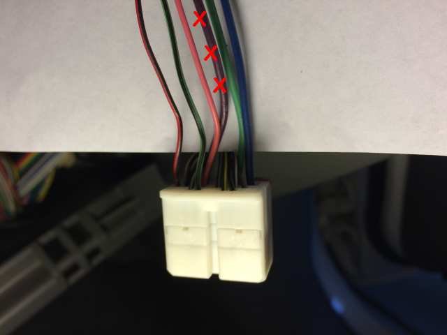

    I'm confused about the "y" part... Is that going to be the purple #5 wire? And what do u connect with it once U splice it open.:.. And vampire clamp???
    Or is that "y" a spearte wire that I will have to make? Please help it lost me once it mentioned y cable

    The "y" cable is used simply to allow violet to attach to both pins 2 and 3.

    So the opposite end of the y wire would be "vampire taped to violet wire?
  15. Sep 7, 2016 at 8:04 PM
    #135
    EDDO
    EDDO                         
    Mar 12, 2014
    #125165
    4,020
    Eric
    San Jose, CA
    19 TUNDRA
    Correct. You can see it here on the left side of the picture.

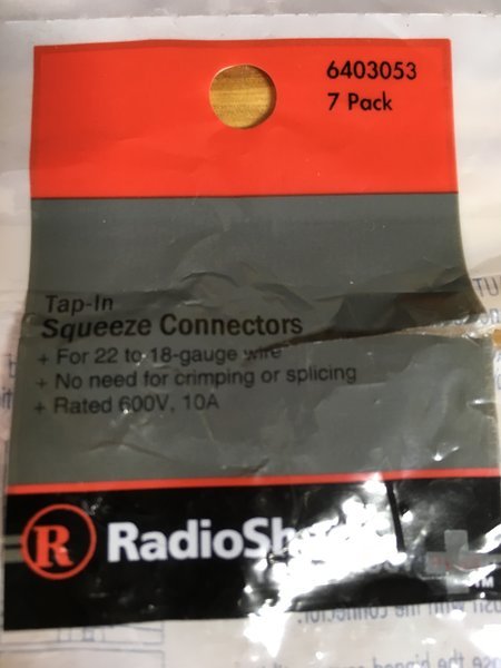

    And that purple wire is not cut like the rest of the wires correct? Just tapped in to?
  17. Sep 7, 2016 at 8:13 PM
    #137
    EDDO
    EDDO                         
    Mar 12, 2014
    #125165
    4,020
    Eric
    San Jose, CA
    19 TUNDRA
    Correct. This is what I used for that.
