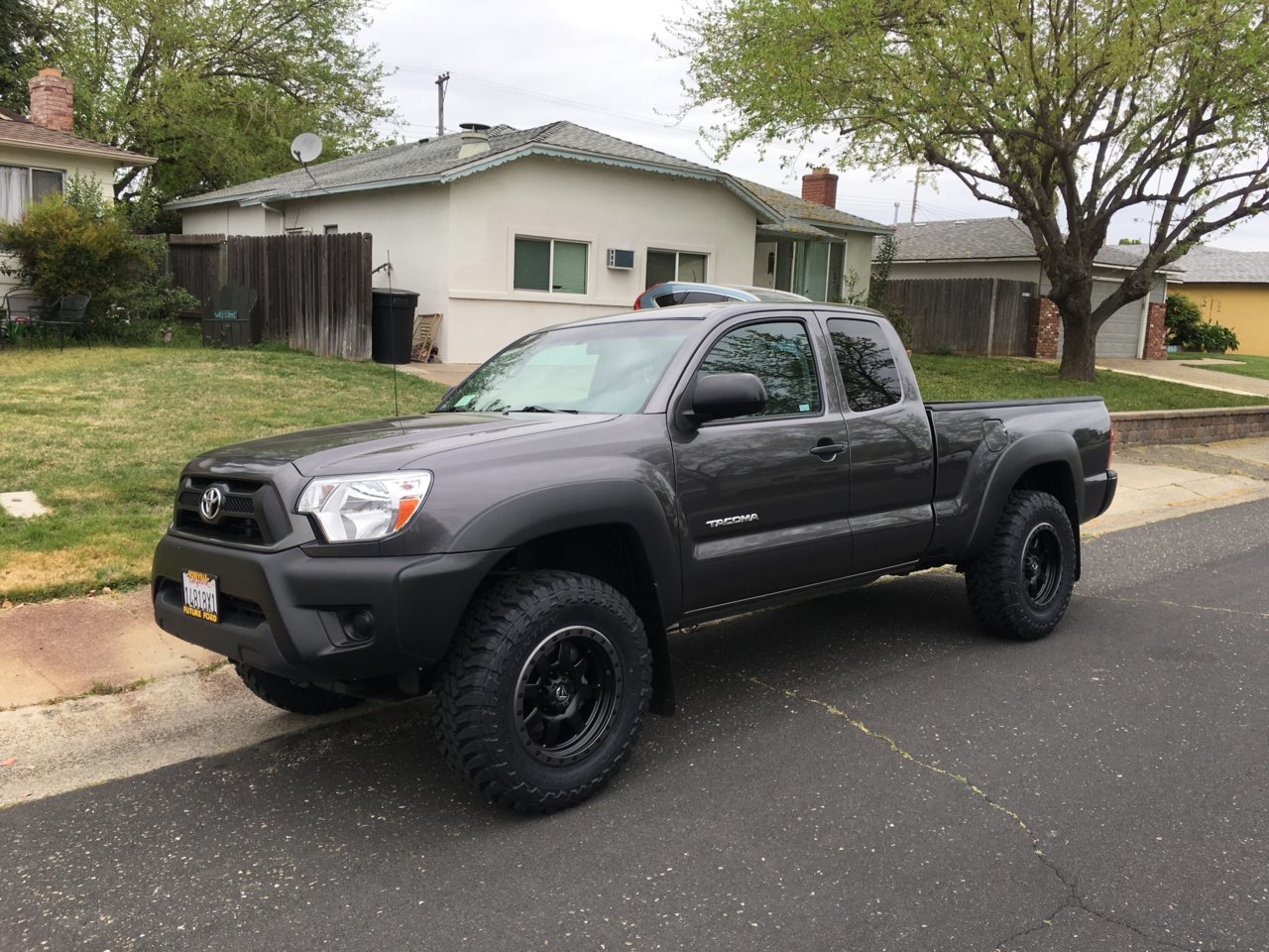

    This is my first time to the site. I was hoping someone could help me out. My 2015 Tacoma Prerunner is a 4x2. Can I put a locker in the rear end or do they already have one in it. Want to check it out before I spend any money. Thank you

    If your prerunner is an Off Road model, it has a locker. If not, your best option is an ARB air locker. East Coast Gear Supply is the company to go through. Get an assembled 3rd member with locker sent to you and ship your old one back to them.
