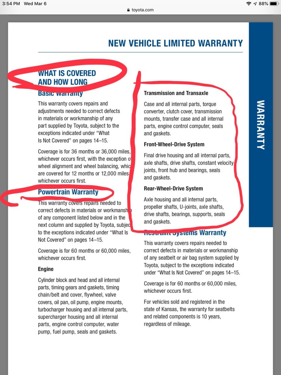

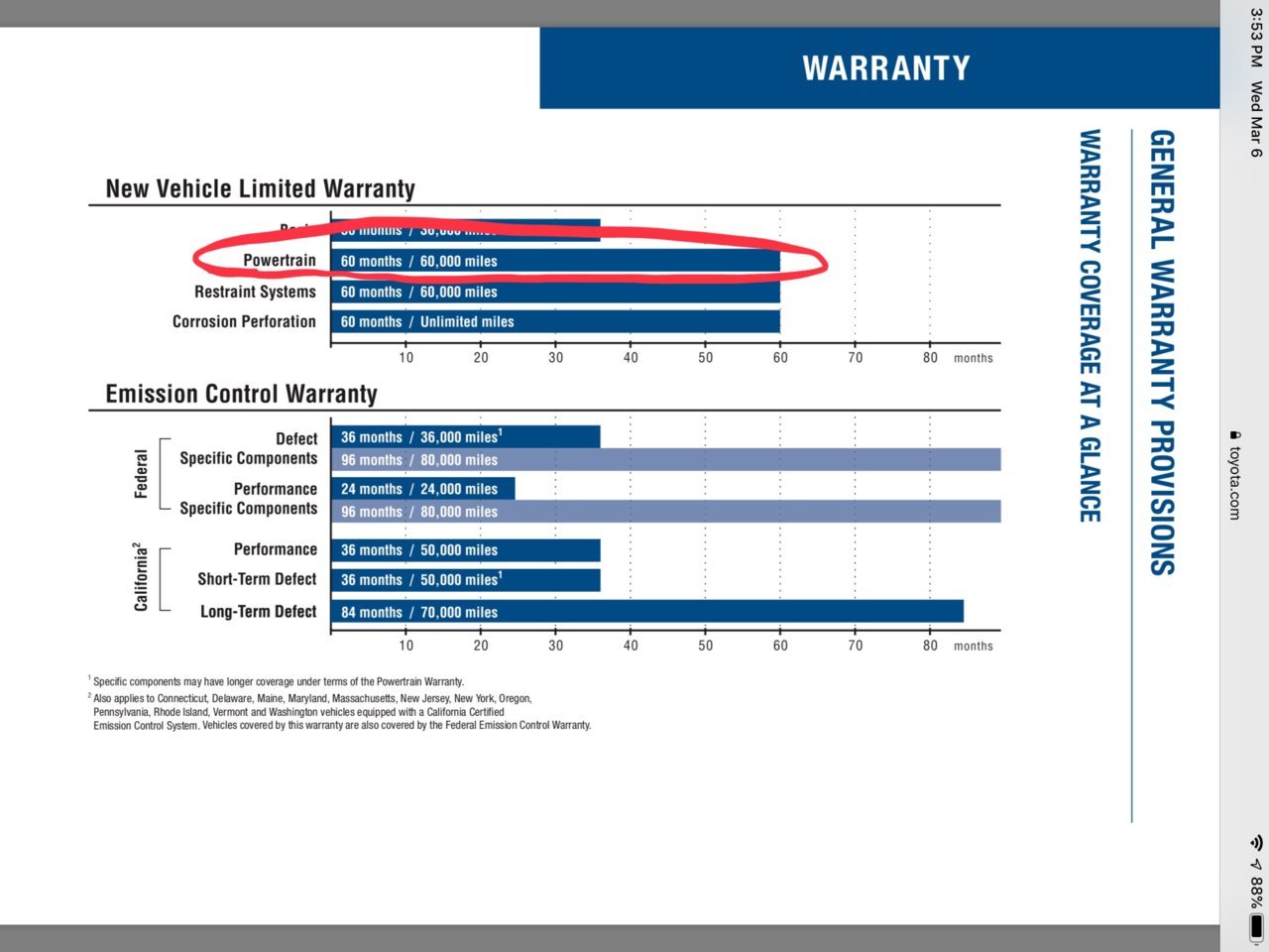

    The standard new car power train warranty will cover... don’t drive past the 60K until you get this resolved. Call the Toyota Customer Experience Center (800) 777-8119 if the dealer won’t accept responsibility. See below and look for your Owners Warranty Rights Notification booklet, it will have a claim form in the center that you can file for arbitration if Toyota will not resolve.
    READ, you are still covered:

    After reading this (again), and verifying the factory drivetrain warranty covers much more than the engine & transmission, my next call would be to the dealership General Manager for an explanation as to why you were lied to. Then, call corporate and explain what was said... finally, leave comments/reviews describing your experience at that dealership. Once Toyota Corporate resolves this specific problem, find a new dealership to service your vehicle. I would be extremely pissed at this point, and would rant all over the internet about the unscrupulous actions by the service department.
