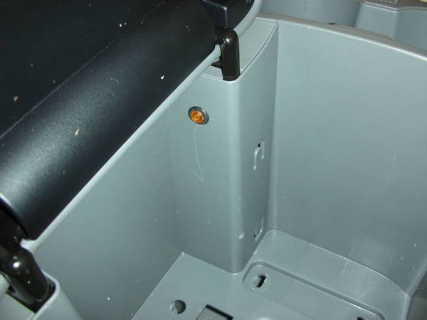

    DSCN3072.jpg I put 2 switches in my center console,one for locker and one for the abs mod.Put them up in the upper rear short section where the hinges come down. This way I can lock my console when I'm not driving it and also when I go to the stealership,if its just an inspection then they will have no idea I even did those two mods.
    In the pic where someone put an led light I put two switches side by side and put my led in the big area, also put the net across so its seperate from the main section. works great
  5. Nov 23, 2012 at 3:01 PM

    The abs switch is the one I will use mostly,the locker mod alt. will be used very rarely and having both in the console makes it easy for me and if the wife or son in law borrow it,the console is locked !!!
    The abs mod will not allow posi lock to engage but the locker mod will.
    Yes if using the locker mod it will do the abs BUT why run all the time with the locker mod engaged ( then if you accidently hit the regular locker switch,it will engage ). It sure is a lot safer using just the abs mod then if you hit the locker by accident,it will NOT engage just like factory.
